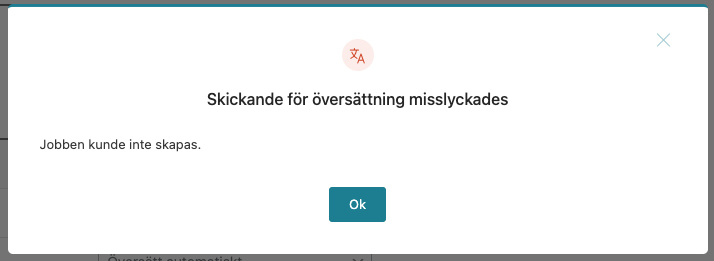

I've updated to 4.7.6, yesterday. I hoped that it would have fixed this issue. But it didn't. Just tested and I got the same error-msg. BUT, it seem like the texts has been sent to translation anyway. At least some of them.
* I tried to send 25.
* Got the same error-msg.
* It looked like all of them are untranslated.
* After manually reloading the page it looks like 6 of them got translated. Despite the Error-msg.

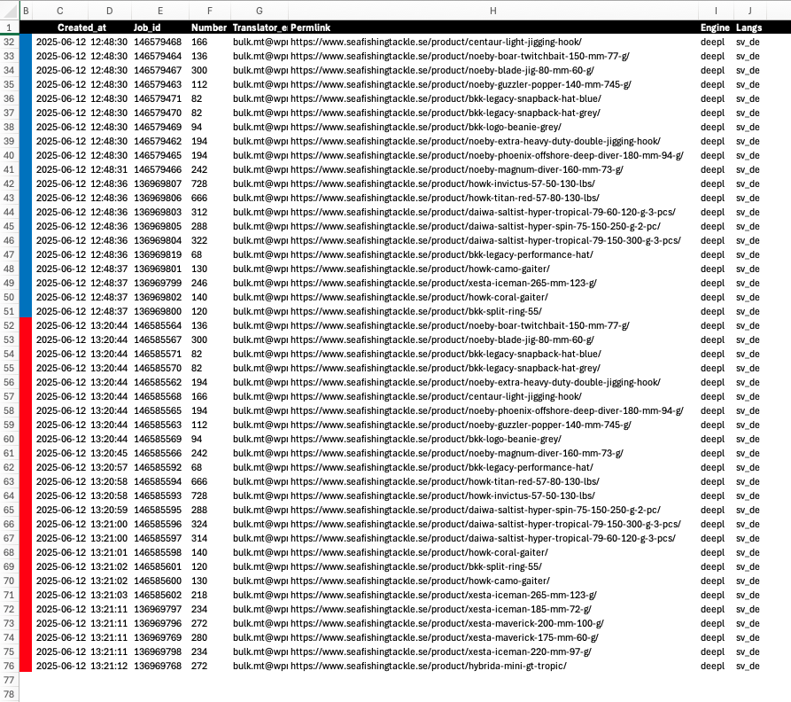

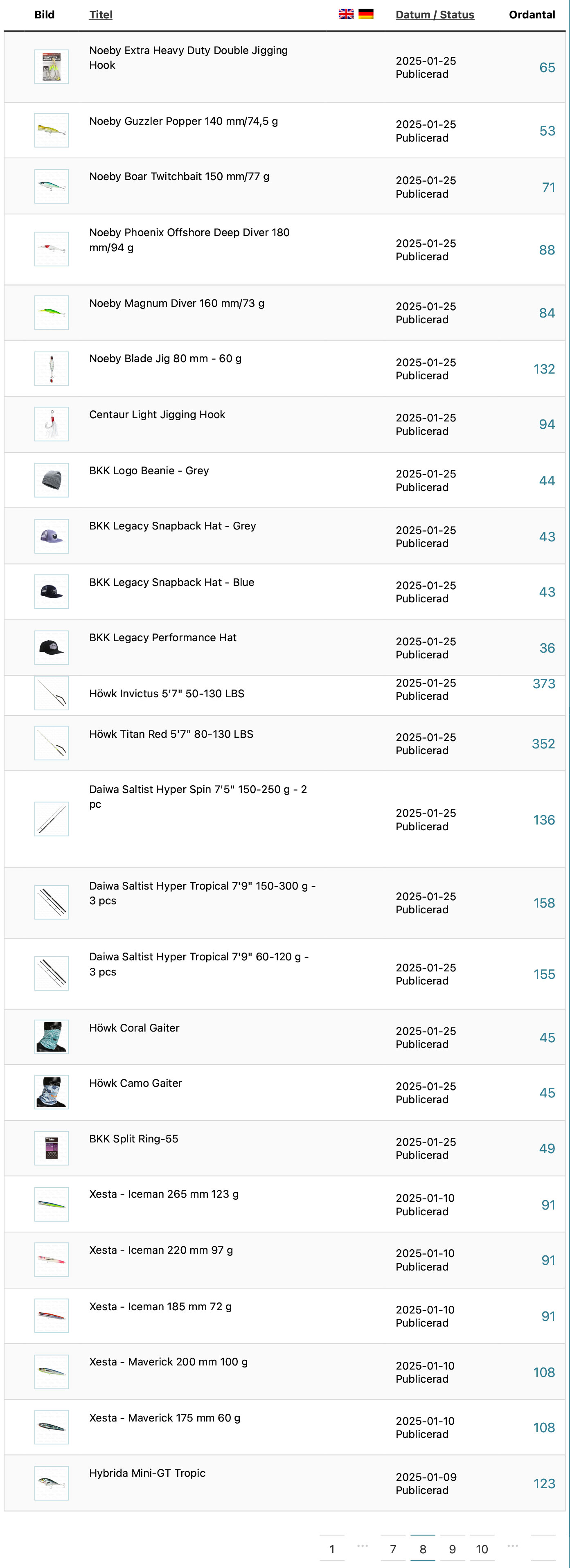

June 12, 2025 at 1:34 pm #17130330
jimmyA-10
Finally I got the time to test your solutions. I added that line to the exclusion list, then I cleared the cache. Then I did send a some products (a couple at the time) to translation and it worked. For a while. I think I translated 30 products ok. Then when I did send the 25 on the list (see attached picture) then I got the attached Error-msg.
I checked the log-file (Automatic translation usage reports) and those products are not there.
I reloaded the whole page and none of the products was translated.
Then I did send all of the products again. Same Error-msg. But this time 20 of them show up in the log-file (marked blue in the log-picture attached). But there are still no translation when I reload the page.
I even tried to cleared the cache and sent those 25 products again. But I got the same Error-msg. This time all 25 products show up in the log file (marked red). But still no translation.

The products above is using double credits (but I got no translation). The reason it took double credits is because I sent it twice...
But now a strange thing that I just saw in the logfile: It looks like this product is tripple(!) translated.
The logfile show the product at 12:34:26 (ID: 136969836), again at 12:48:30 (ID: 146579468) and also at 13:20:44 (146585568).
But this product I only sent to translation once! It was ok the first time. I did send this in the batch before the first failed batch. This product isn't even on the same page of products as the failed ones. It's on the previous. That is why I am so sure that I only sent this one to translation.
June 12, 2025 at 2:36 pm #17130619
Alejandro
WPML Supporter since 02/2018
I'll return the credits later today but in the meantime we found out WHY the problem is happening.
The error in sending the jobs is because your site is returning a timeout, there's something in the server settings that might have a timeout set for calls. sending a job will take X amount of time and the more pages you have, the more it will take, so the problem seems to be happening "randomly" this way.
Anyways, since the error happens because something interrupted our calls, when you try again, it seems to finish sending the one that couldn't finish correctly + the new one, sending the same page multiple times without you even knowing it and charging you twice.
We're working on having a fix for this so if something fails for some reason, we make sure we clear the interrupted workflow results and start from scratch.
