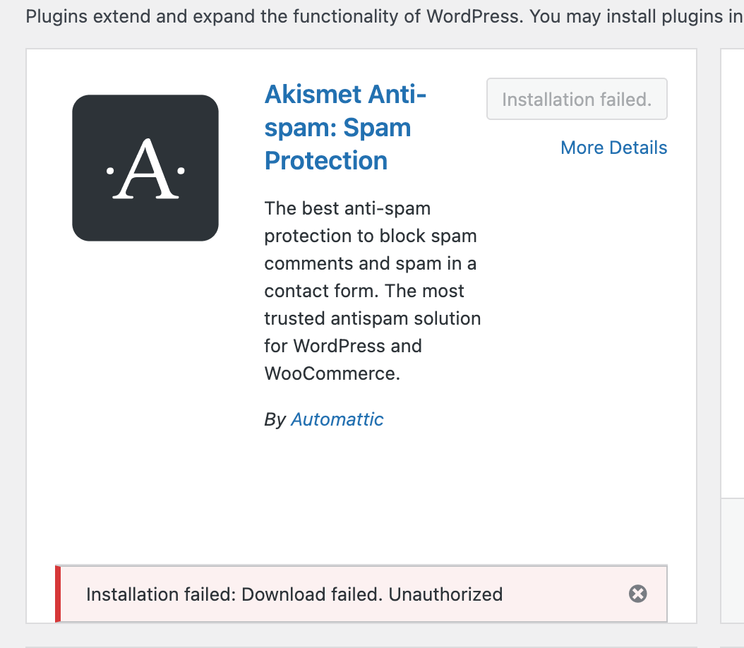

I am trying to install a plugin on my site hidden link, but I encounter an error during the installation process.
Failed to load resource - ams.wpml.org/mini_ap…on?version=3.29.9:1. Installation failed: Download failed. Unauthorized.
Why am I getting an 'Unauthorized' error when trying to install a plugin?
How can I resolve the 'Failed to load resource' error from ams.wpml.org?

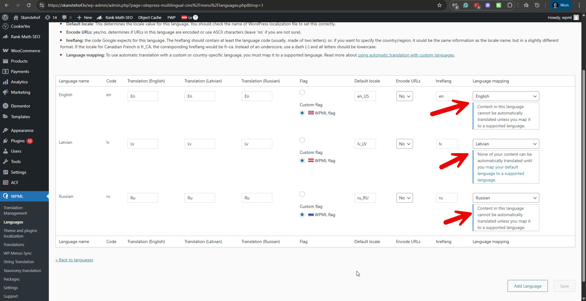

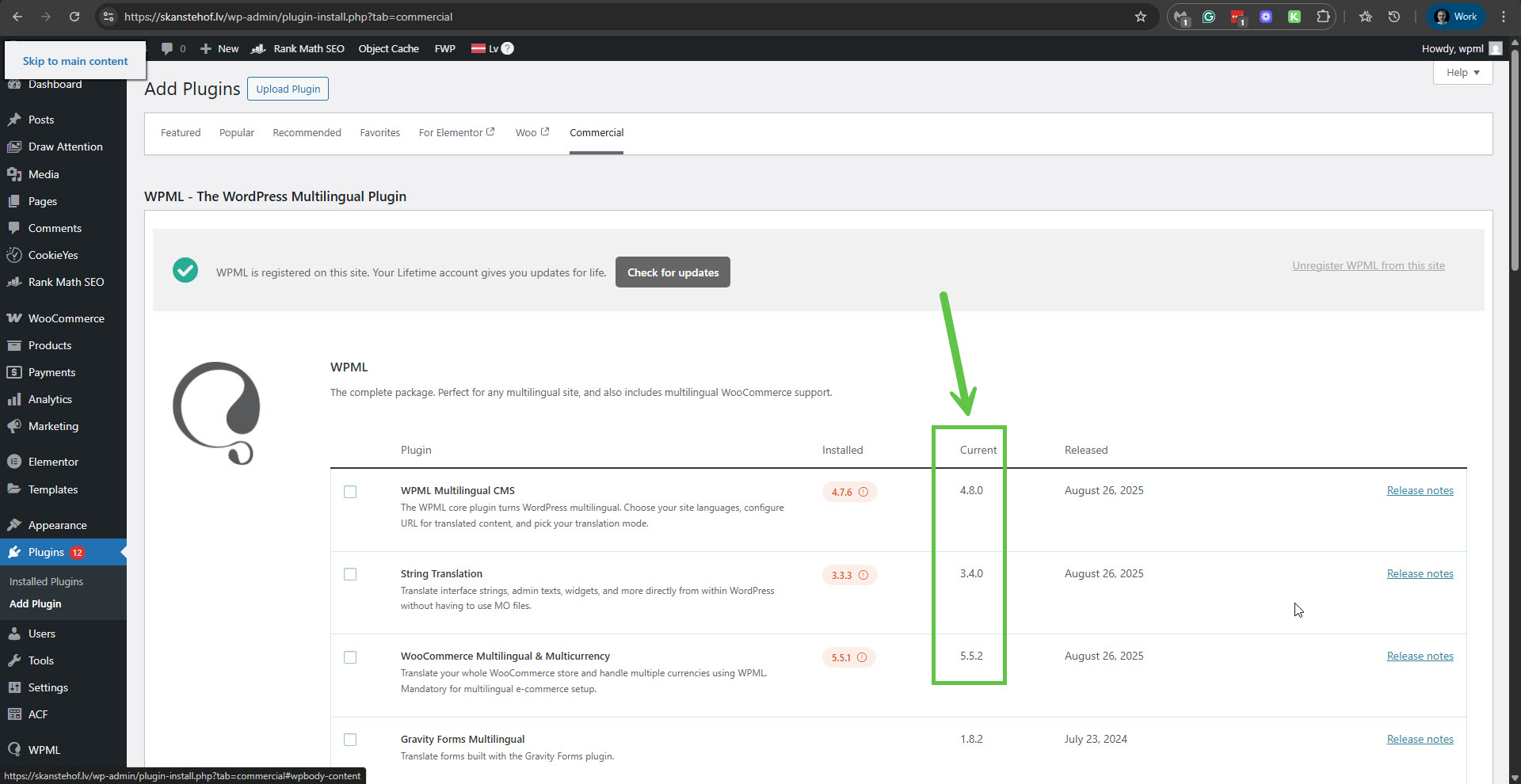

I can also see that it is not possible to map the site's languages. Please see the attached screenshot, cant-map-lang.jpg. However, here hidden link I can see that after clicking the Check for updates button, your site gets the option to update to our latest versions. Please see the attached screenshot update-tolatest.jpg.
Can you please update WPML and its add-ons to their latest version and see if the problem persists?
If it doesn't help, try re-registering WPMu on your site.

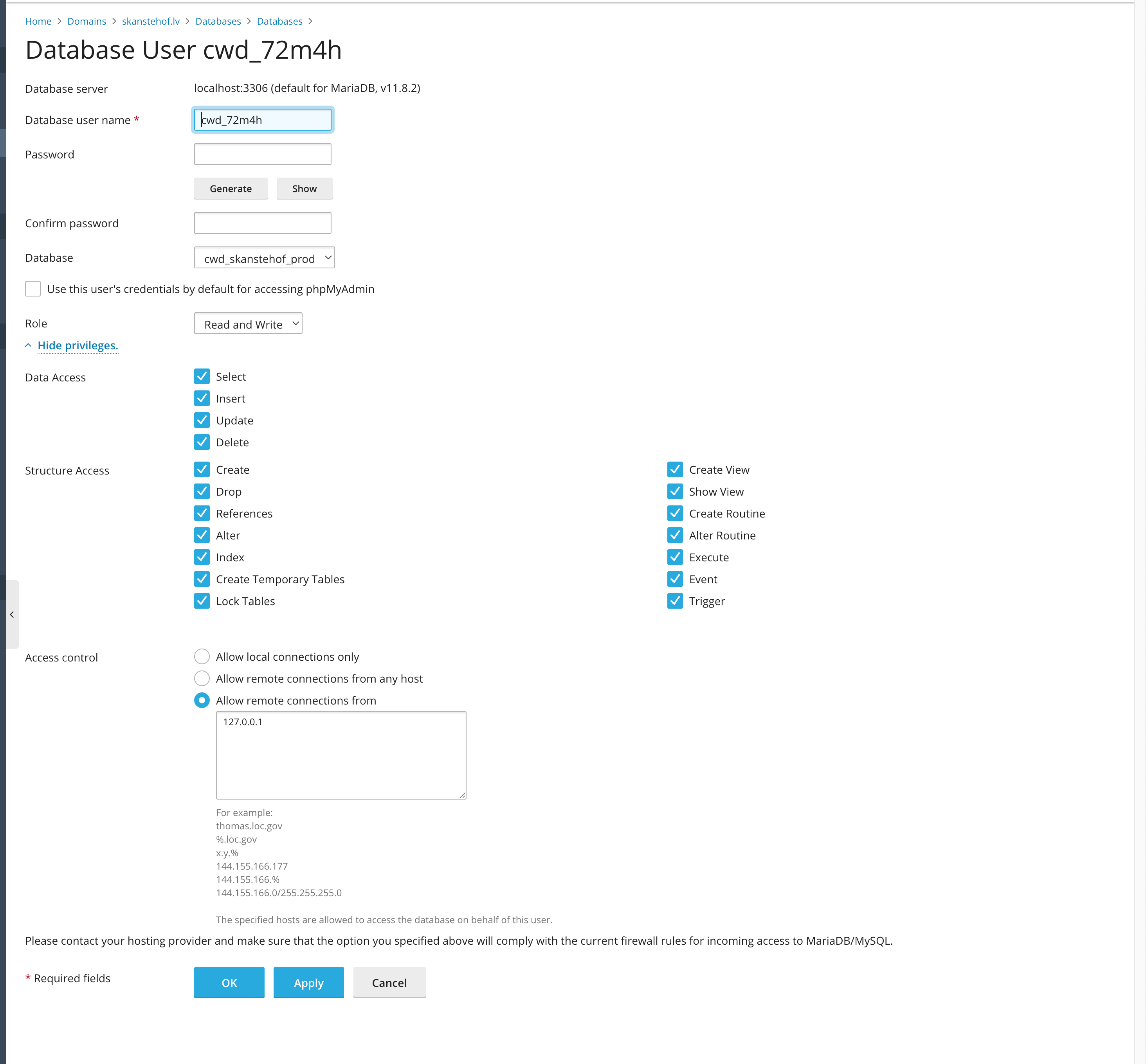

Hello Itamar,
Could you please clarify what they mean about DB privileges? We always give full privileges. Screenshot attached

Itamar
WPML Supporter since 02/2016
Languages: Hebrew (עברית )
Thanks for providing a screenshot of your DB privileges.
