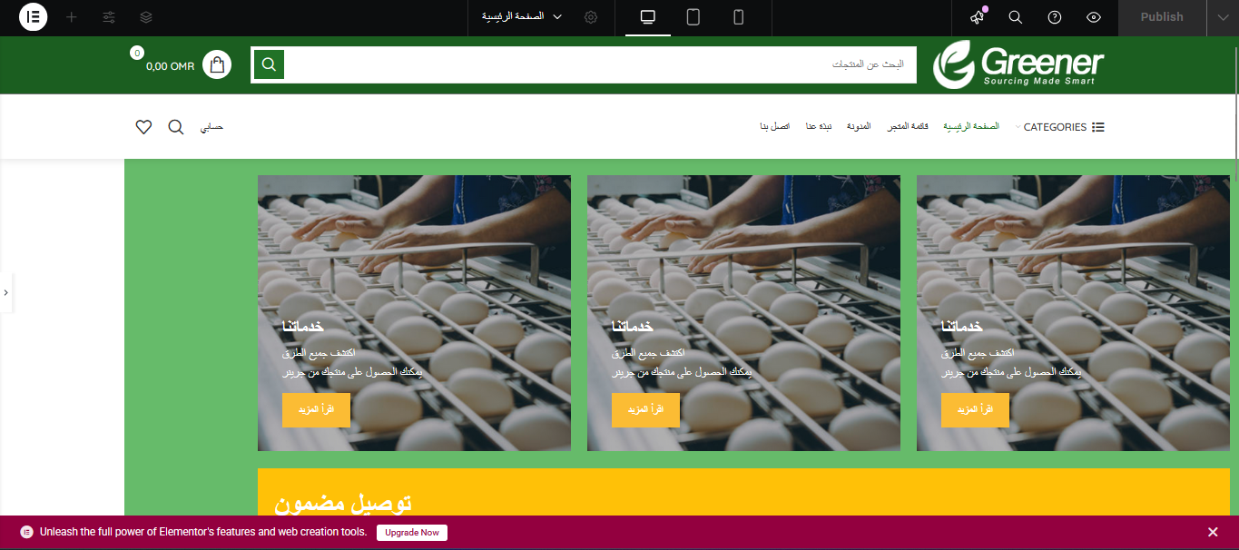

Additionally, after translating the content, the Elementor page is now aligned to the right and lacks balance (as I mentioned earlier). Is there something I need to activate to fix this?

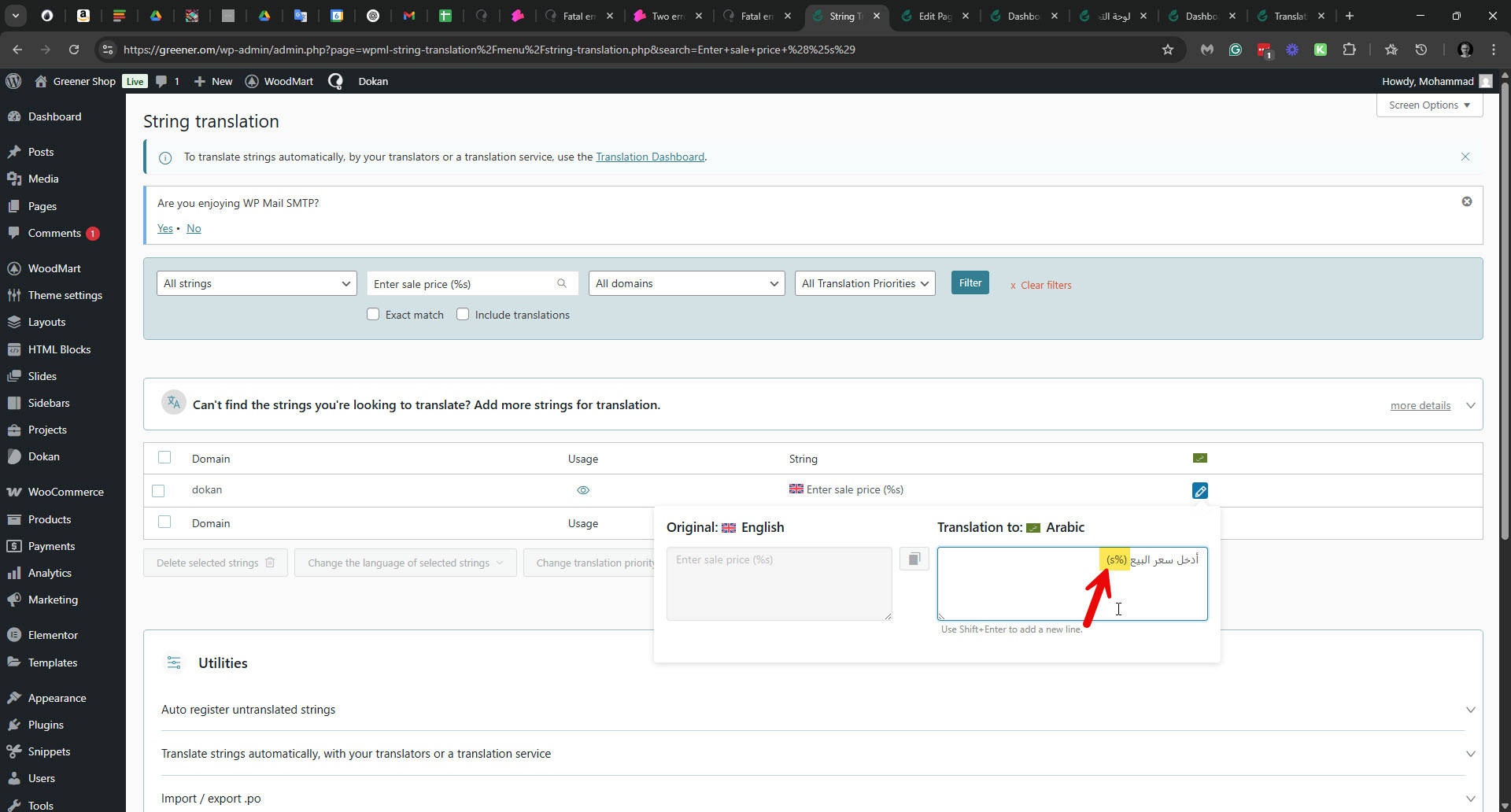

I fixed the fatal error on the Arabic page. This time it was another string. It was: All %s and it was incorrectly translated as follows: الكل %س. Please see the attached screenshot. So I translated it like this: جميع %s.
I reported this to our second-tier supporters and developers.
We will update on any news regarding this issue.
About the Elementor page, which is aligned to the right and lacks a balance issue, I split this ticket, and we will handle this issue in the new ticket here.
https://wpml.org/forums/topic/split-the-elementor-page-is-now-aligned-to-the-right-and-lacks-balance/

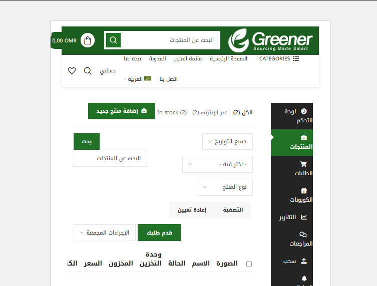

I’ve encountered another fatal error related to translations, similar to the previous issues. Here are the details from the debug log:
text

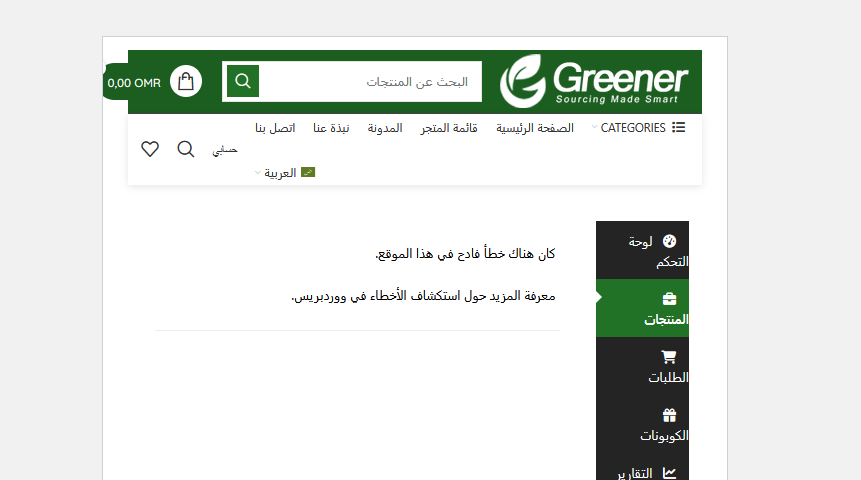

[30-Apr-2025 14:16:58 UTC] PHP Fatal error: Uncaught ValueError: Unknown format specifier ")" in /home/coi7xq4ukqn0/public_html/wp-content/plugins/dokan-lite/templates/products/listing-status-filter.php:23
It seems that a translation string in the Dokan plugin (likely for the Arabic language) has an incorrect format specifier, where %s or another placeholder has been replaced with ). I tried searching for the ) character in WPML > String Translation under the dokan domain, but I couldn’t find the problematic string. Could you please help me identify which string is causing this error and how to fix it?
I’ve attached a screenshot of the page where the error occurs (the Dokan vendor dashboard in Arabic).
Looking forward to your assistance!

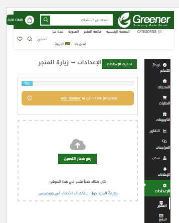

I’ve encountered a new fatal error related to translations. I’m still waiting for a response on the earlier issue I reported in the previous ticket, and I’d like you to review this new problem alongside it. Here are the details from the debug log:
New error:
[03-May-2025 10:05:57 UTC] PHP Fatal error: Uncaught ValueError: Unknown format specifier " " in /home/coi7xq4ukqn0/public_html/wp-content/plugins/dokan-lite/templates/settings/store-form.php:84

I could find those strings. They come from the Dokan Lite plugin. So I did the following:
1. In hidden link I scanned the Dokan Lite plugin for strings.
2. Then, in String Translation, I could translate them correctly. Please see the attached screenshot (for the second error).
I reported this to our second-tier supporter. I asked to implement a workaround that hopefully would stop this from happening.

While fixing it, I recorded a video demonstrating what needs to be done. In short, you need to find the file and the line mentioned in the error message, and there you will see the string with the problem. Then, in WPML -> Strings Translation, you can fix this string. Please watch my video here.

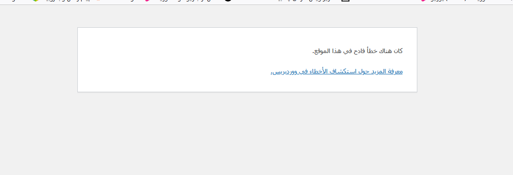

Thank you for the update. I’ve checked the issue after the workaround applied by your second-tier supporter, but the problem still persists. The fatal error remains:

I also fixed this string.
Itamar.

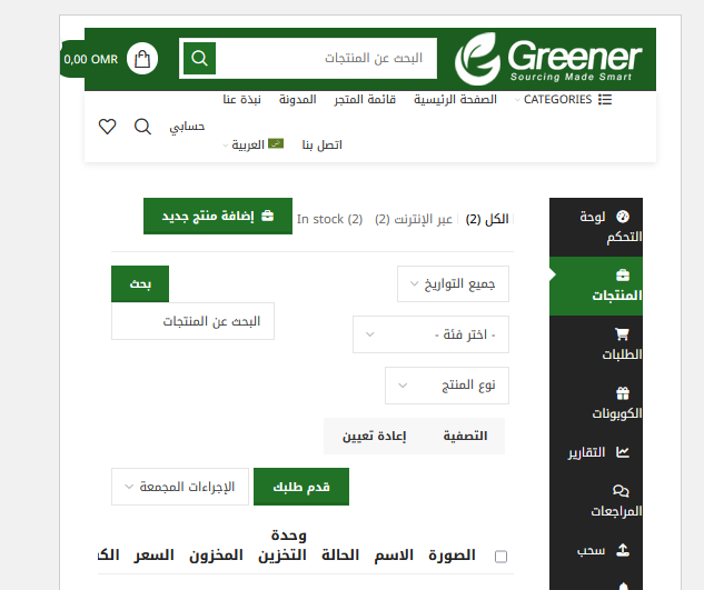

Thank you for fixing the string and sharing the screenshot. However, I’ve checked the issue, and the problem still persists. The page appearance is still broken, and the fatal error remains:
[06-May-2025 06:47:26 UTC] PHP Fatal error: Uncaught ValueError: Unknown format specifier ")" in /home/coi7xq4ukqn0/public_html/wp-content/plugins/dokan-pro/templates/products/edit/bulk-edit-form.php:155
Please check the previous link again:
