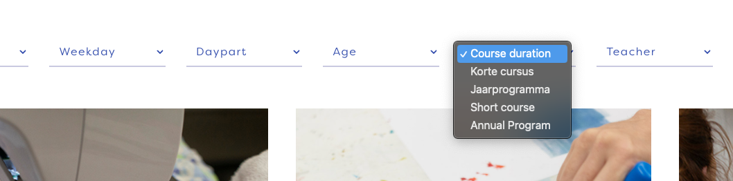

Thanks for the reply. It seems to (kind of) work. But not everything. The translated word is in Dutch now on the English pages, which is not good (see screenshots 1 and 2).
And besides that: do we need to manually add all these filter items now? That's impossible to do, that's so much work. Why were the other filter items all automatically translated? We don't want all this extra work because it's already taking so much longer then expected because of this issue...

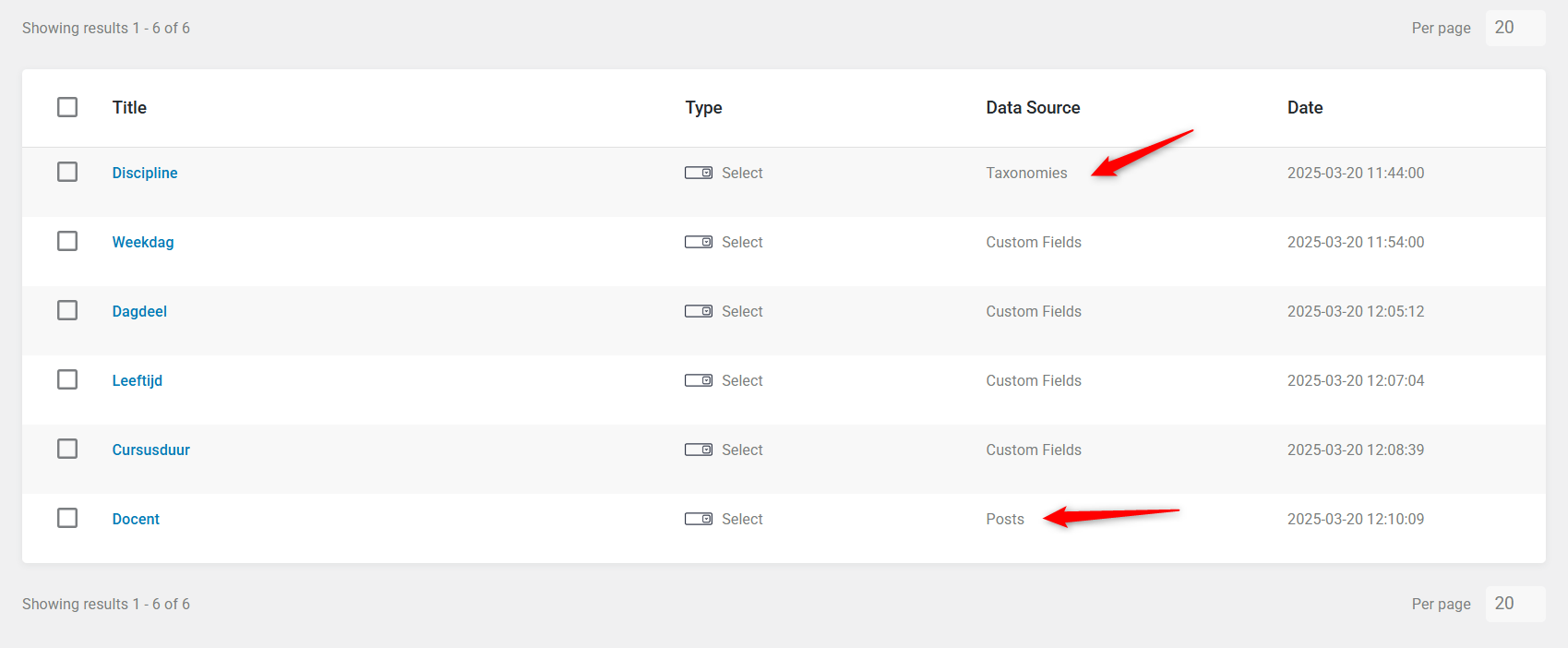

Thank you for the updates. Please check the attached image. Currently, you are using Custom Fields, Taxonomy, and Post Type for filtering the posts. When using Taxonomy terms and Posts for filtering, their IDs will differ in the secondary languages. That’s why we need to select them manually in the secondary language posts.
Also, we need to make sure that the query variable (for example *weekdag*) is the same in both the Dutch and English language filters.

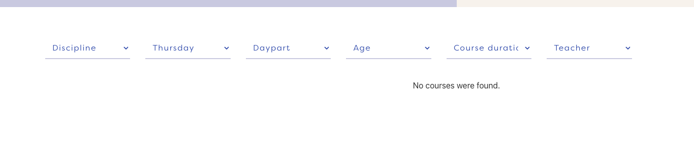

April 23, 2025 at 11:36 am #16959355
jeffreyB-17
Hi Bigul,

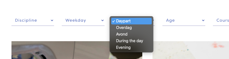

I get that but that doesn't explain why not all filters are visible on the front-end now. See the screenshots for what I mean.
Also, there are double filters on the English page which isn't how it should be. And we shouldn't be putting everything in there manually I suppose, right?

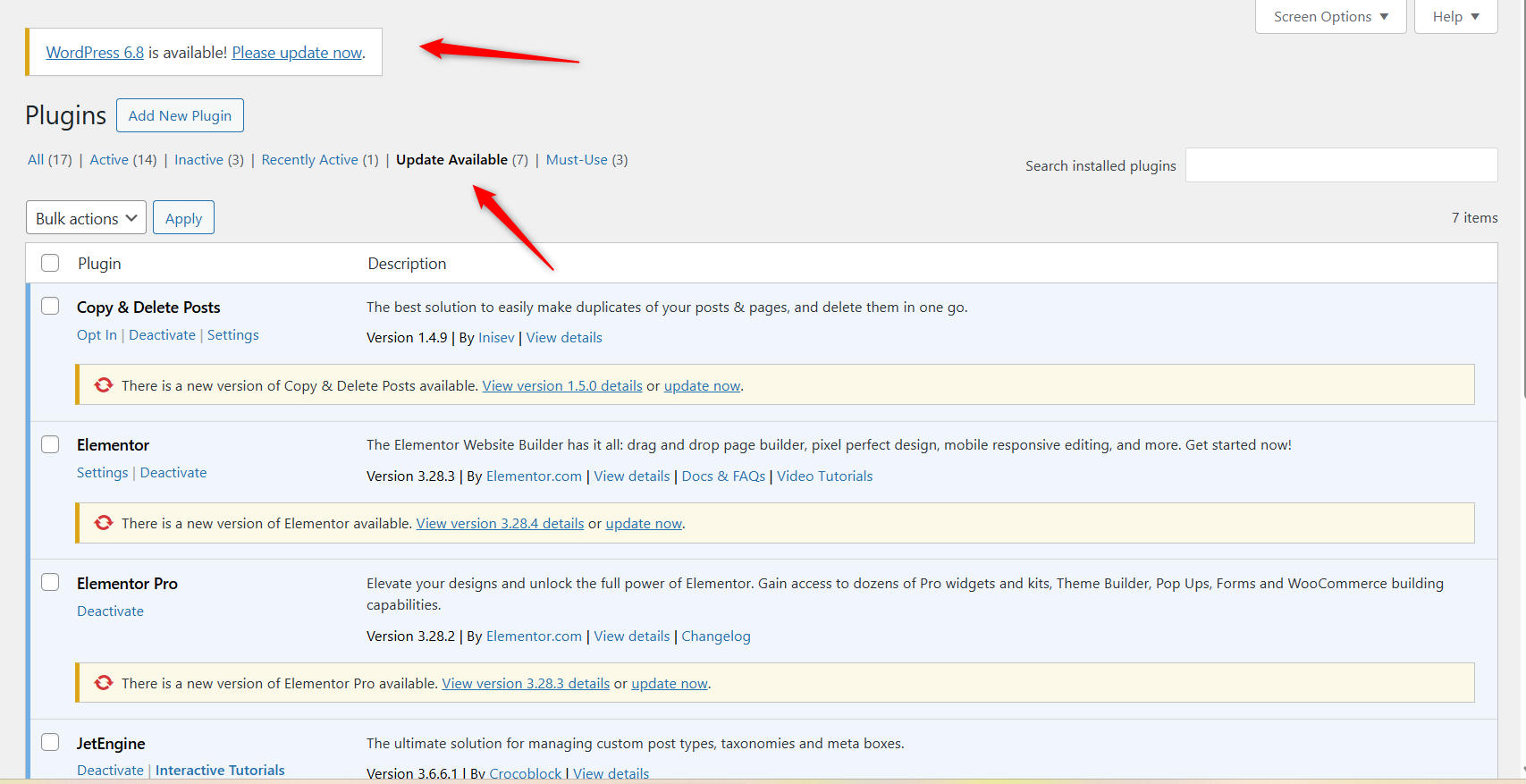

Thank you for the updates. I am consulting with our compatibility team for an expert opinion now. We have a request, please upgrade to the latest version of WordPress and plugins after a full site backup {mandatory} because it will be beneficial in our further debugging.
Thanks!

April 24, 2025 at 7:06 am #16962713
jeffreyB-17
Hi Bigul,
I updated everything. Thanks for keeping in touch with me.

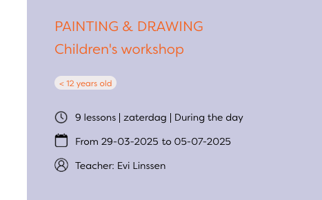

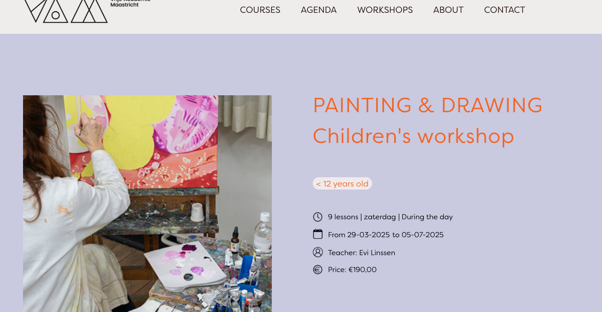

However, the translation of the Weekdag field is still not appearing correctly in the Course Archives in English (see attached image). We are continuing to investigate this.
Currently, most of the Select fields in the Course post type are set to Translate instead of Copy. Additionally, you’re using the same string for both the select option and its value (e.g., duur). This setup can interfere with correct filtering and translation. Therefore, we recommend adjusting the fields configuration, like the *Weekdag* field, to ensure proper translation, especially for filtering purposes.
Please check the following screencast linked and the doc for more guidance, and let us know your feedback.

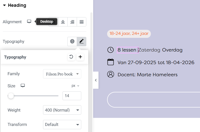

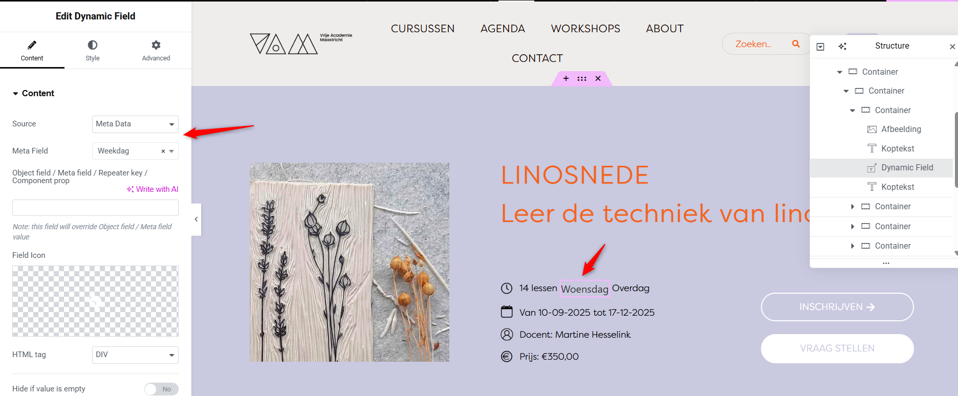

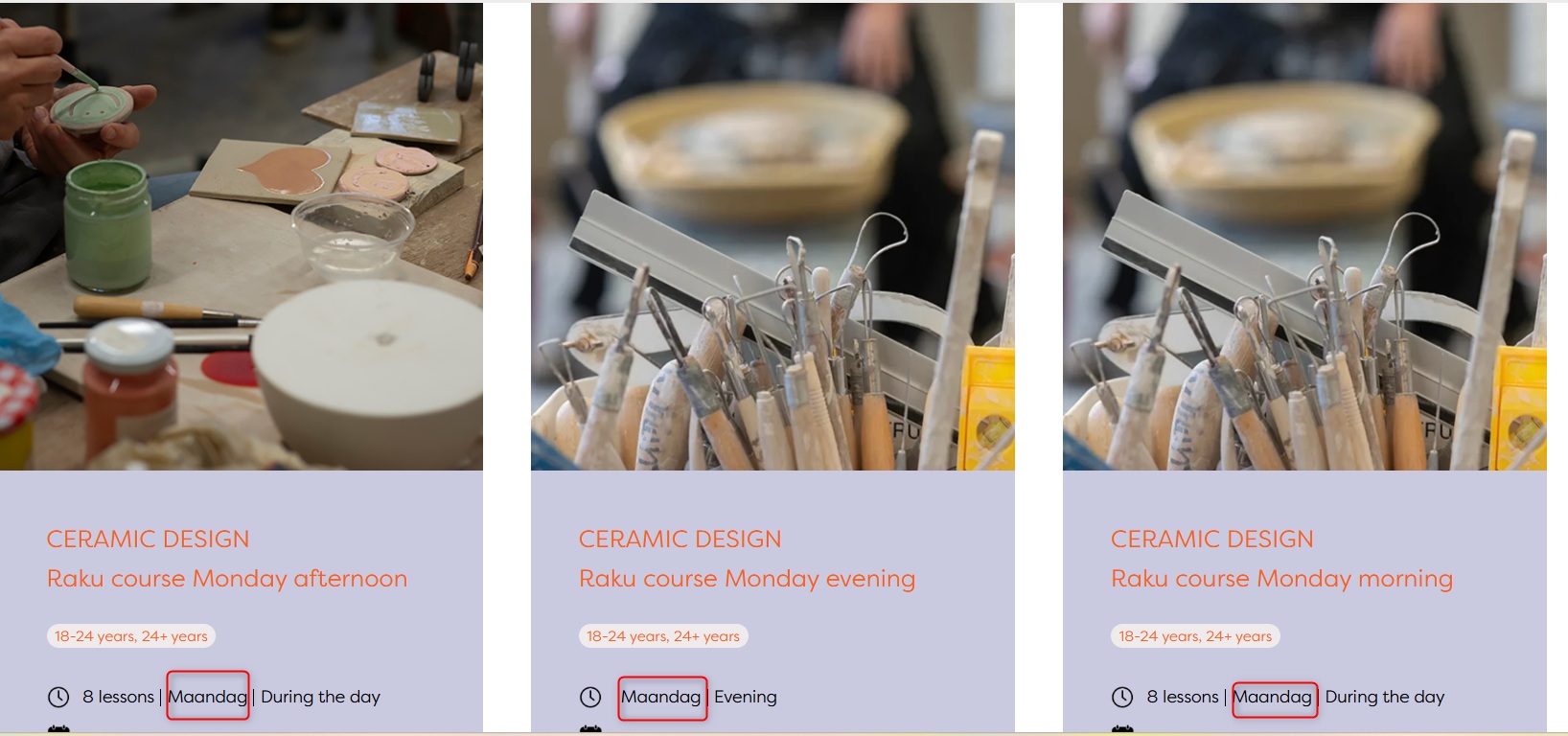

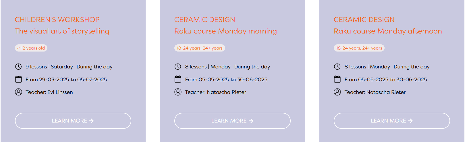

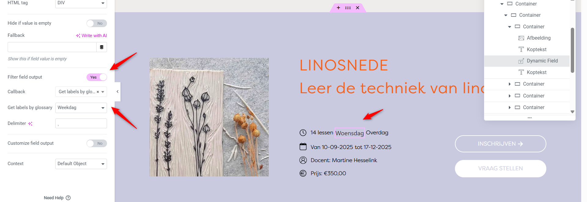

The translation of the Weekdag field now appears correctly in the Course Archives in English after the following changes. Please see the attached images for more details, and this doc for more details: hidden link
After reviewing the source code, our compatibility team found that the field was pulling the value ("maandag") instead of the label ("Maandag"). This is why it wasn’t translated into English — only labels should be translated, not values.
This issue didn’t occur with other fields because this one is a multiple-choice field that uses a value:label format.
To fix it, we changed how the field is displayed in the listing. We used a Dynamic Field widget that correctly shows the label from the glossary. We also updated the styles of this field (like the Lessons field).
We edited the following template to achieve this:
