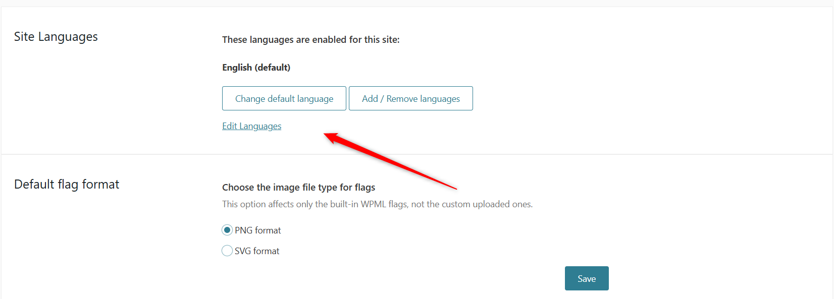

1) Go to WPML >> Languages >> Site Languages (of subsite)
2) Click on the Add/Remove Languages button

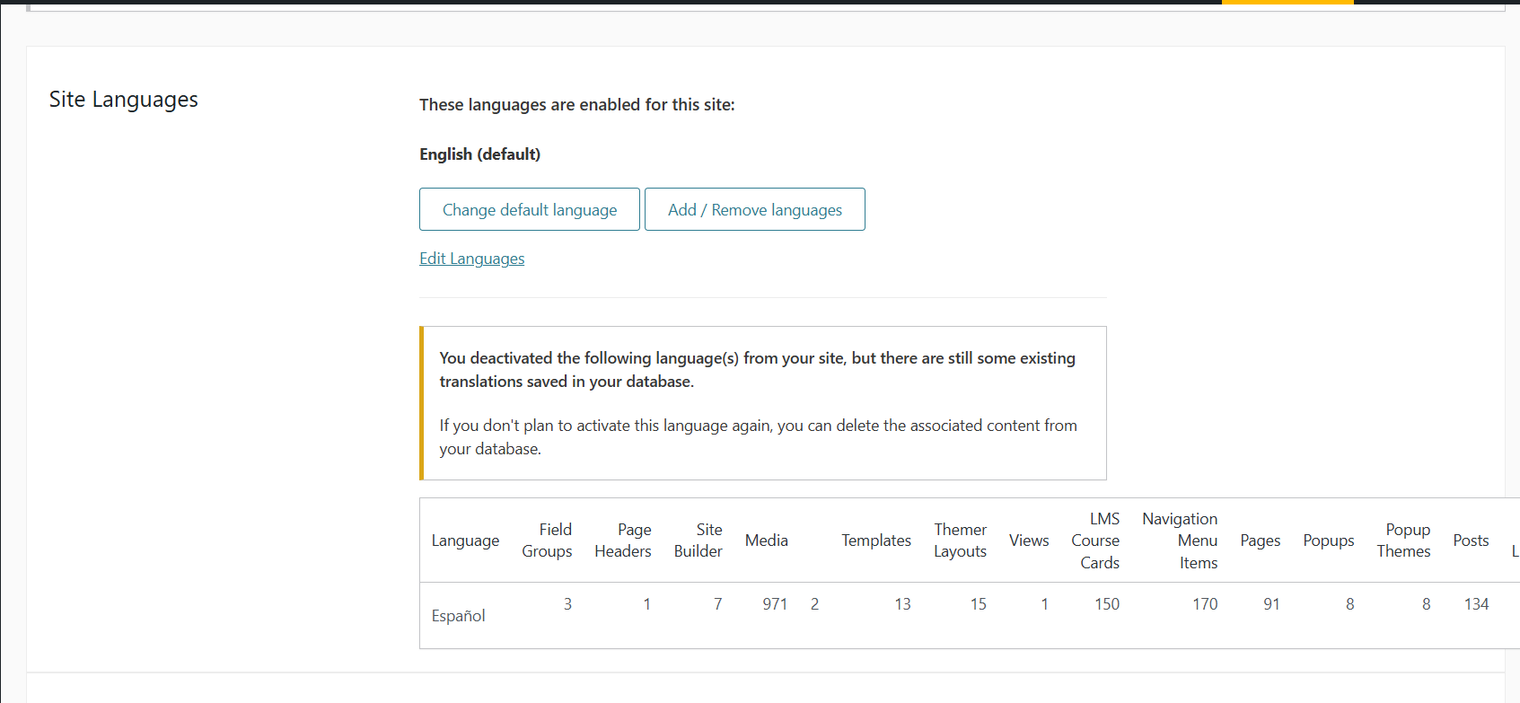

3) Uncheck the Spanish language and save
4) Refresh the page

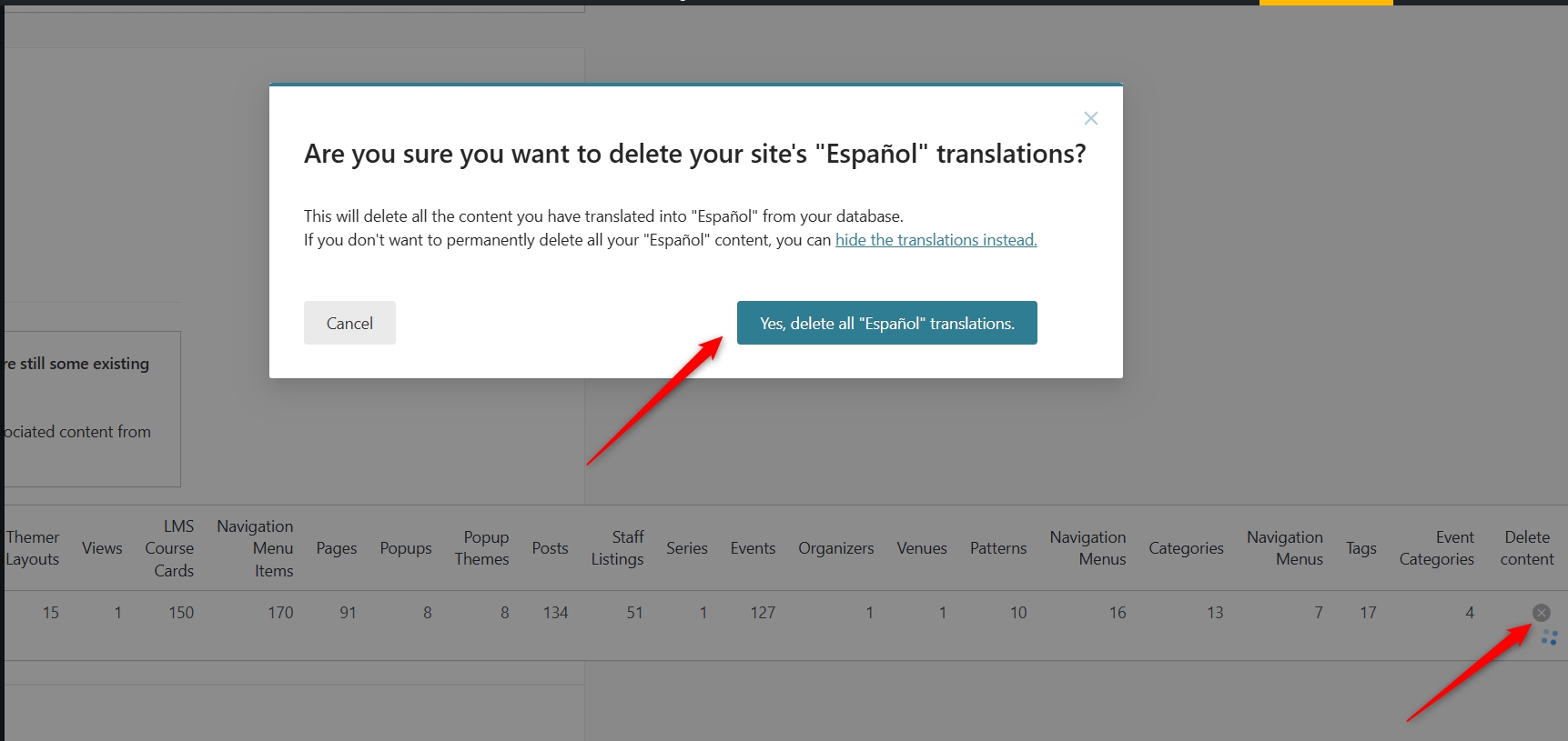

5) Delete all the contents of the Spanish language

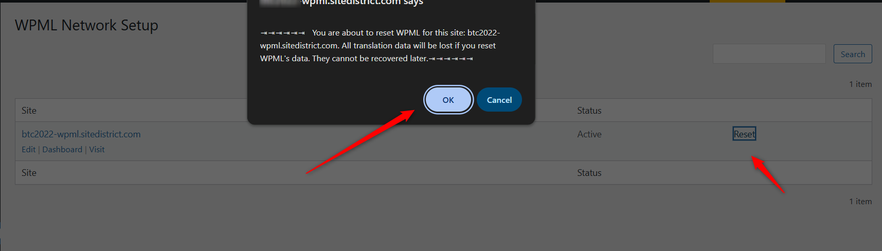

6) Go to the Network Dashboard
7) Open the WPML menu
8) Perform the Reset WPML action for the subsite

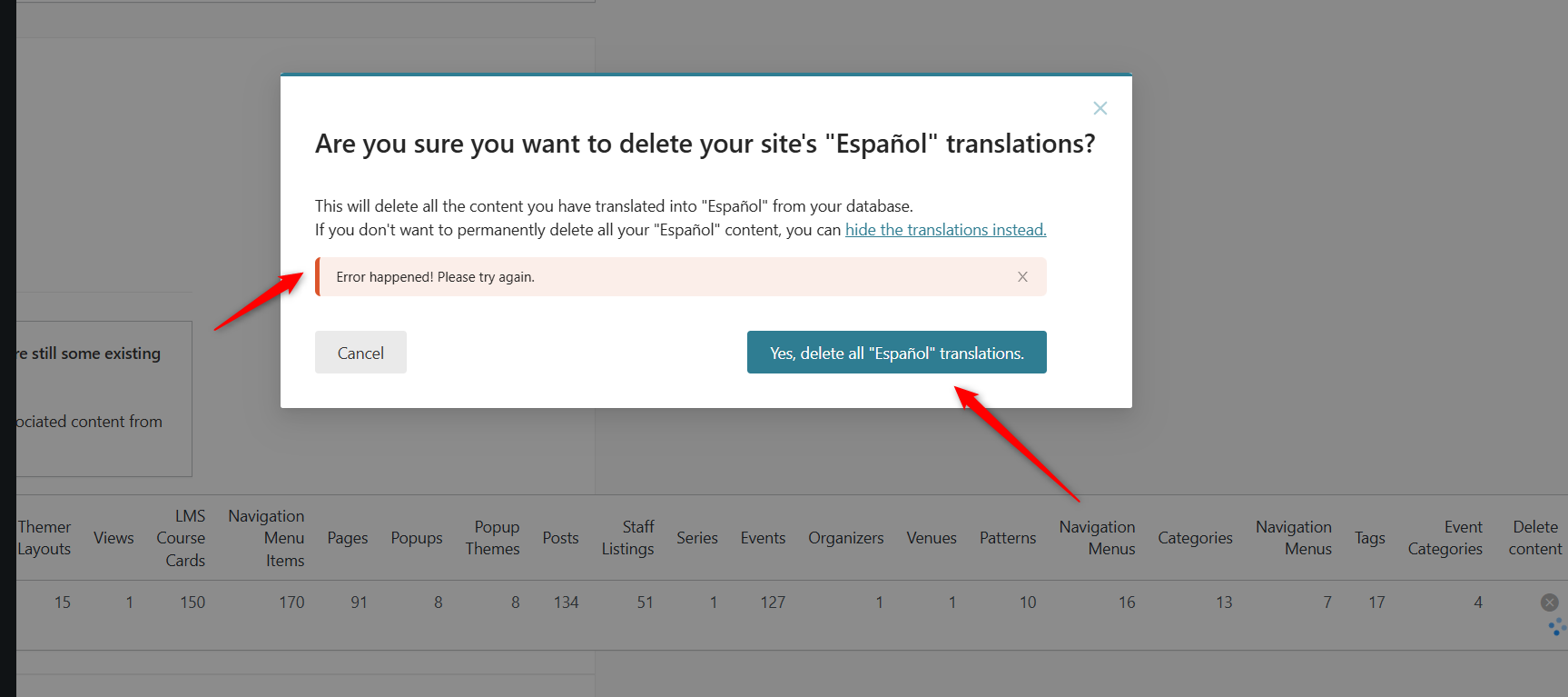

Please note that, during step 5, I encountered the error message "Error happened! Please try again" four times. However, clicking the Delete translation button each time helped to resolve the issue. Refer to the attached images for more details.
