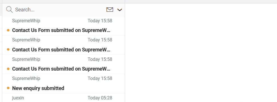

I am using Formidable Forms Lite with WPML.
My site is translated into 4 languages using WPML.
When a user submits the contact form once, the email notification is sent 4 times.
All emails arrive at the same timestamp with identical content.
It looks like Formidable Forms notifications are being triggered once per WPML language.

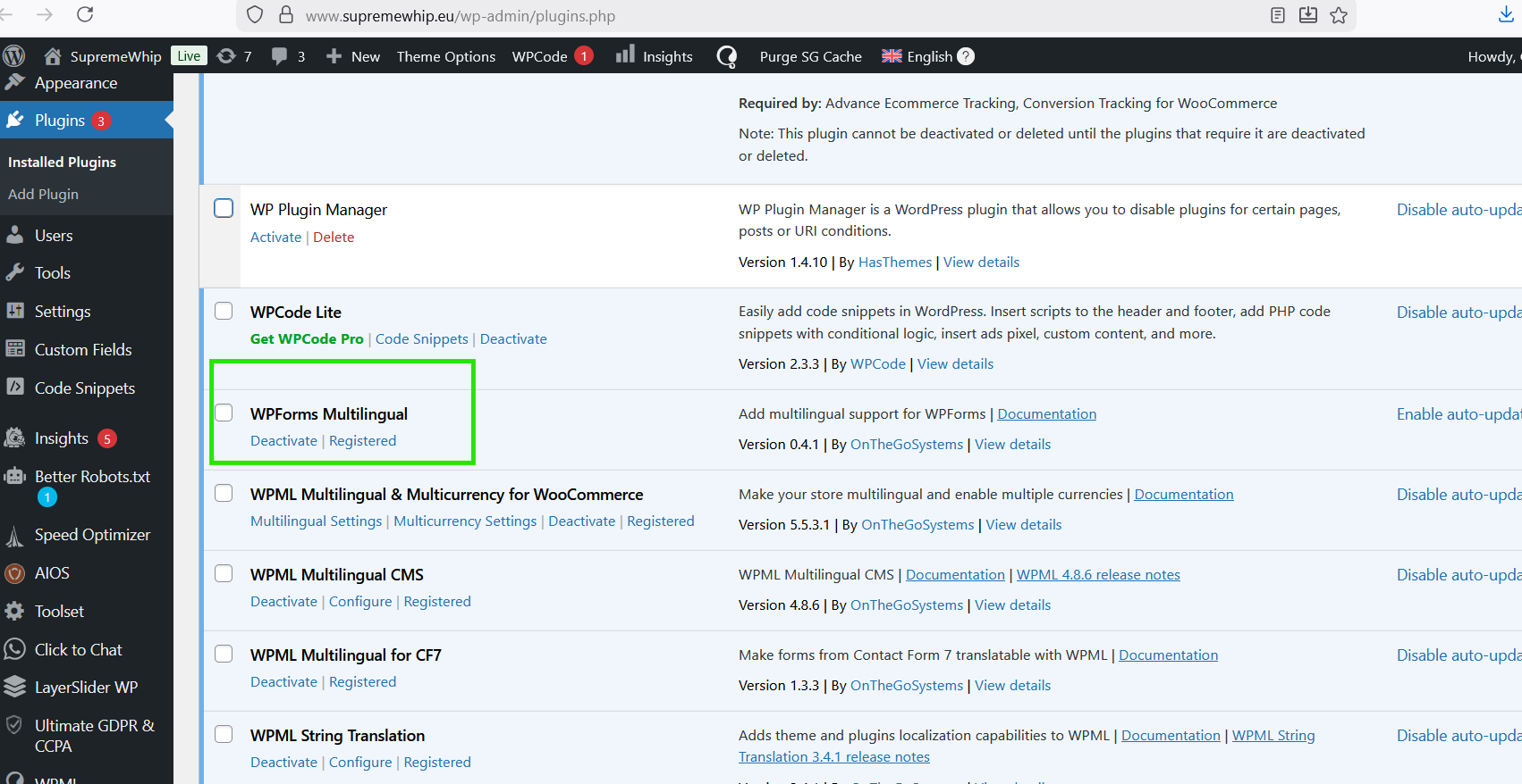

I would like to clarify that the Formidable WPML Multilingual Add-On has just been installed and is currently active on the site.
Despite this, I am still not able to properly translate Formidable forms.
Could you please review the setup and advise what might still be missing or misconfigured?

Looking at the screenshot you shared, I can see that you’ve installed WPForms Multilingual, which is intended specifically for the WPForms plugin.
In your case, you need the hidden link" target="_blank">Formidable WP Multilingual Add-On, which is provided by the Formidable Forms plugin authors. This add-on is not included with WPML by default and must be downloaded directly from the Formidable Forms website.
Once that add-on is installed and activated, Formidable Forms will integrate correctly with WPML for translations.
