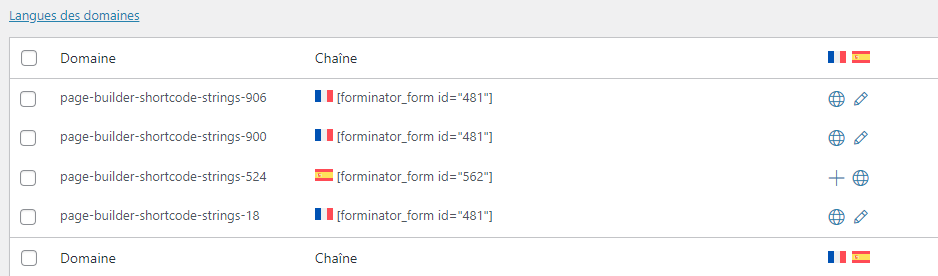

I have created a french form (default language) with forminator. The shortcode is [forminator-form id="481"]
I have created the translated spanish form with forminator too and the shortcode is [forminator-form id="562"]. I try to translate the french shortcode in the strings but everytime I open the spanish page I have to manually change 481 to 562. It looks like the translated strings has no effect in the spanish page. See enclosed picture.
the concerned links are:
Thank you for your help.

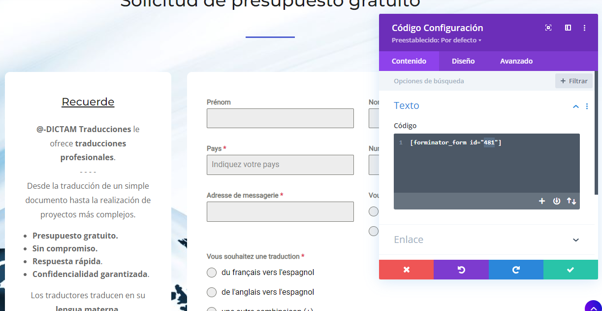

In the meantime, I suggest the following steps to replace the shortcode directly on the translated page:
- Copy the shortcode from the translated form
- Edit the page in your default language
- Switch to the second language from the top admin bar
- Edit the translated page with Divi Editor
- Replace the original form's shortcode with the new one
This is also what the plugin's support suggests here: hidden link

Thank you for your response. However I don't understand the purpose of translating strings if they can not do the trick. The french shortcode [forminator-form id="481"] should be in the translated page [forminator-form id="652"] so why do I have to manually change it in the translated page with Divi? I thought that the shortcode would change with the value of the translation. Please check again my picture. Maybe there is something about strings that I don't understand?

After searching our internal development tickets, I found that Forminator is not compatible with "String Translation" at the moment.
I see that the Forminator team is working on the WPML compatibility feature, it's on their roadmap but no ETA yet. You can keep an eye on this thread for more info: hidden link
At the moment, I'm afraid that the only workaround would be replacing the shortcode manually in the translated pages.
