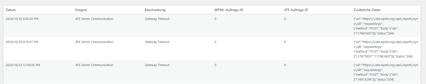

Please check the attached images. Now the WPML>>Support>>Advanced Translation Editor>>Error Log is showing a *Gateway Timeout* error.

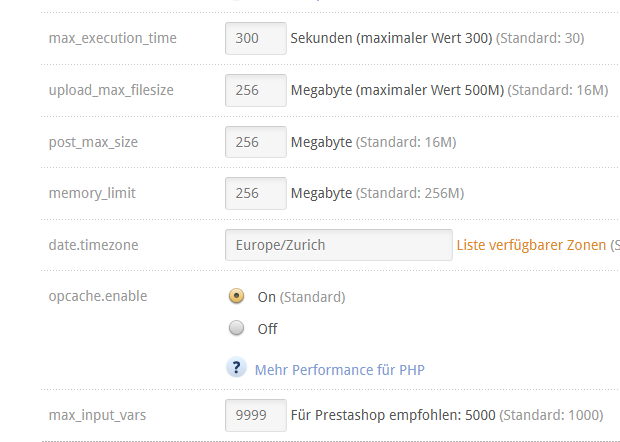

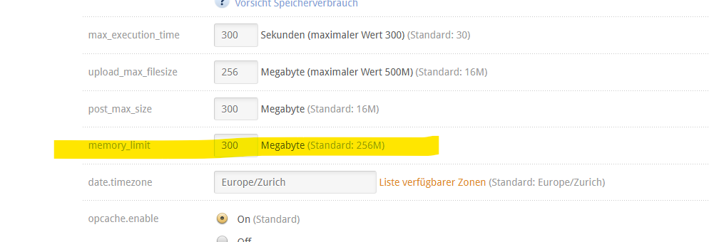

I already increased the php settings as described. see the screenshot...
But I can set it higher to see if it changes anything.

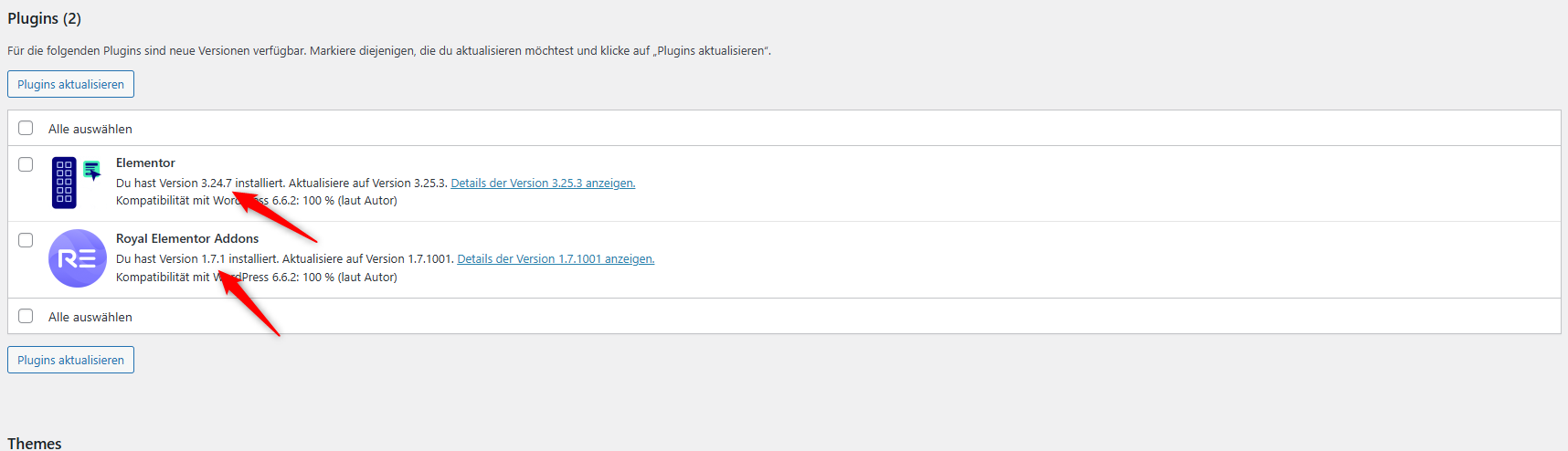

Im not sure if I can Update Elementor and Royal Elementor, there seems to be still some bugs, when Updating for the the other Elementor Addons...

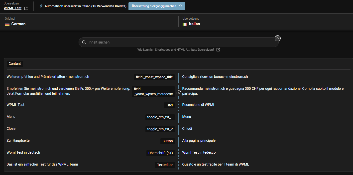

It directly translated my testsite after the duplication and before I made my test-text-adjustments.
you chan check it here: hidden link
and here: hidden link
and the screenshots in the uploads.
I hope that helps?
I will try to update the plugins anyways...

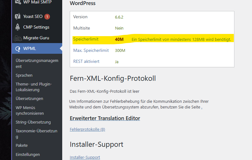

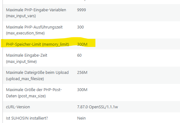

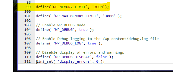

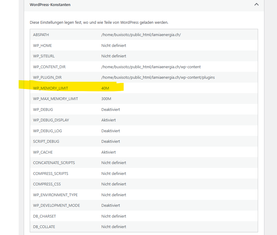

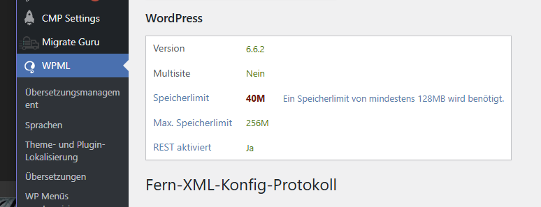

Checking on the changes if the WMPL is working with the WP Memory Limit, there are differences in the wpml support page, see "Screenshot wpml support".
I sent the issue to the hosting, for them to check the WP Memory Limit and informed about the "konstanten", see screenshot "wp konstanten".
It might still be a memory error.
Will try to find the debug log in the wp-content folder.
Or are there other points I need to check?
Thank you!

The only error log I found is the one from 31.10. see screenshot: hidden link
{"url":"https:\/\/ate.wpml.org\/api\/wpml\/sync\/all","requestArgs":{"method":"POST","body":{"ids":["118144919"]}},"status":504}

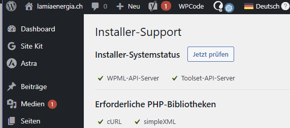

b) The webiste is connected to wpml, see in the screenshot.
The hosting informed me the PHP and WP Limit are both updated, they adjusted it directly, but as you can see in screenshot "wplimit-error" the 40M are still an issue.
I asked the hosting to upload an errorlog in the servers filemanager.
