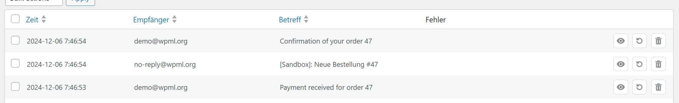

I can reproduce the bug that is happening.
You can see in the img attached, that the "New Order" E-Mail is in the language expected, but confirmation and payment received is in english.

I produced the same results just now as you can see in the attachment.
Anja

our 2nd tier checked, and read the changelog for Germanized, and they state that they fixed the WP 6.7 issue.
So we went to ST and re-validated the translation for both titles ("Payment received for order" and "Confirmation of your order")
Did another purchase and the issue is gone! It also fixed the translation for the first paragraph (Hi, Your order has been received ....)
Please check and confirm it works for you also.
