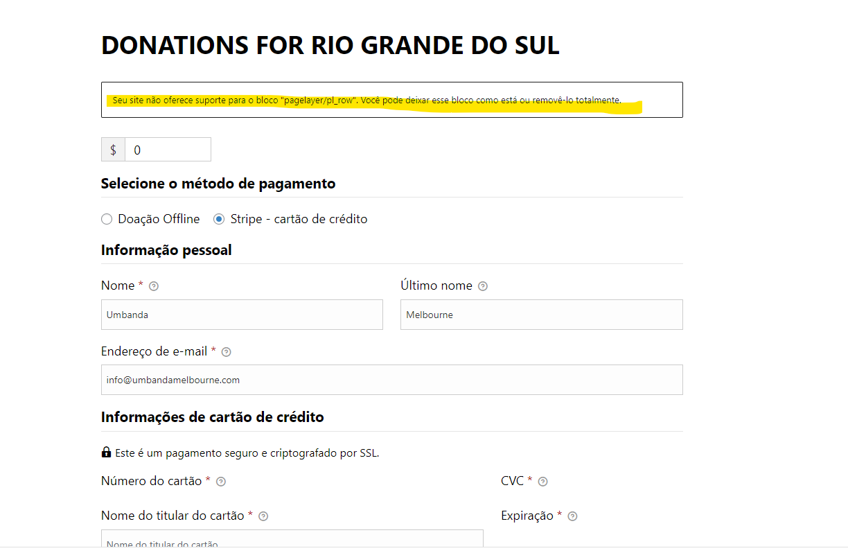

still a mess, I can not translate properly, so many errors. Doesn´t make sense create 2 forms, if it requires to sum the donation in Portuguese and English version. Please find all the errors.
and the logs

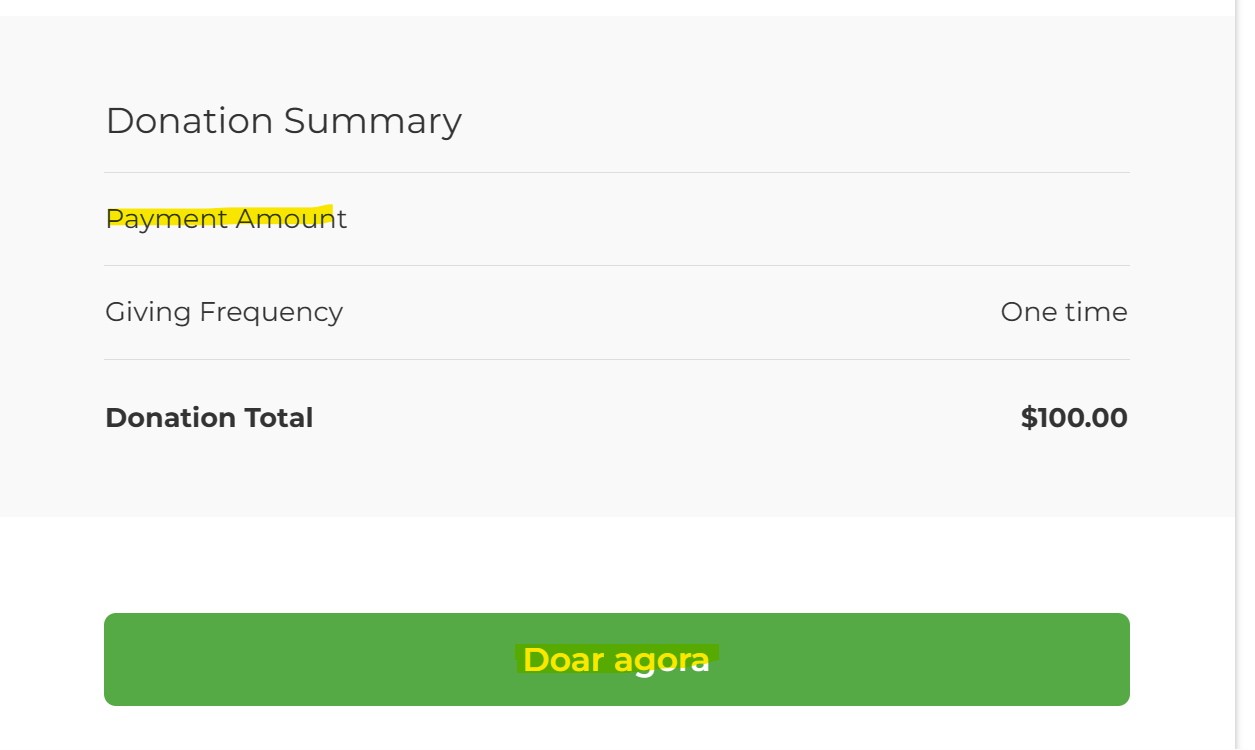

I've also noticed that all other texts in the English version have been manually translated into English except for the button text "Doar agora". If you could let me know where you've added this specific text, I'll be happy to guide you on how to translate it correctly.

Furthermore, I translated the English version using the same method you provide in your instruction; therefore, the text "Doar Agora" is in the same place you use in your instructions.

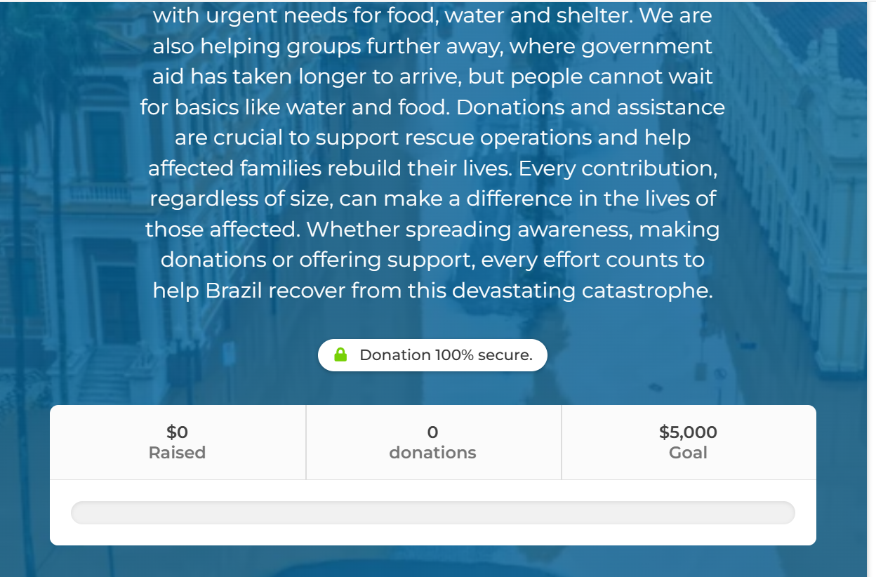

It's true that if you manually translate a donation form, it won't automatically show details like the goal and the amount raised, which might cause trust issues. However, you can use a GiveWP shortcode to help with this.
The shortcode is [give_totals]. You can find more details about it hidden link">here.
With this shortcode, you set your overall goal and the forms to include in the calculation. The shortcode will then show the total amount raised and the goal progress.
For example: [give_totals total_goal="5000" ids="1,2,3"]
If each form has raised $1,000, the shortcode will display $3,000 of the $5,000 goal, along with your message and an optional progress bar. You can add this shortcode to the top/anywhere on the page where you've added the donation form. I added this shortcode to the English Donation Form page, and check hidden link">this screenshot to see how appears.
