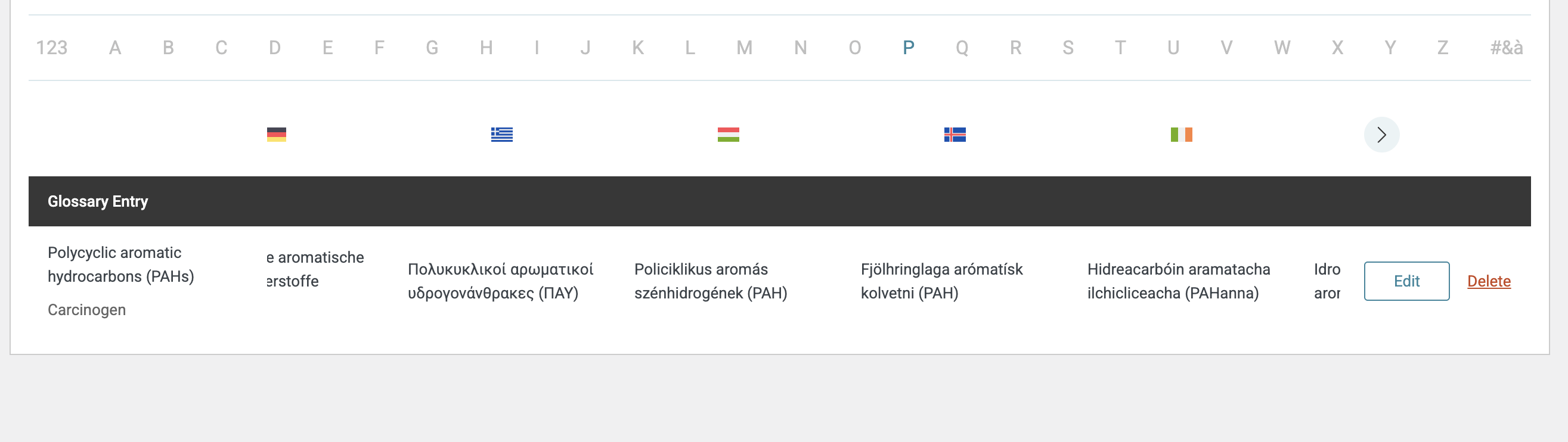

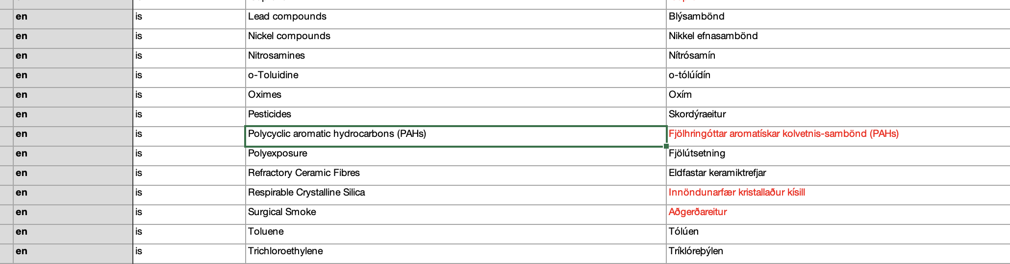

I am trying to import a (partial) glossary into WPML and ensure that the entries are overwritten, as I have selected this option. I can provide the files and data for testing the issue.
Glossary entries are not overwritten despite selecting the option to do so.
Why are the glossary entries not being overwritten?
Is there a bug in the WPML glossary import feature?

Going through this glossary I see that none of the updates I did worked. So yesterday Alejandro reconnected my account to the website. After that I did a major update of the glossary. None of these updates worked, and many languages still have the English translation - My local glossary here is fully translated.

Then think we are not talking about the same issue. Let me try again:
- I have a CSV file with updated glossary terms
- When import this CSV file into the glossary I select "overwrite existing glossary terms"
After the import of the glossary terms the updated terms from my CVS are not processed/updated in my glossary.
So this has nothing to do with the front-end
For the other issue. I did select copy. But it resulted in the loop so first it does recognize it is coming from production. But then it also recognizes it also had a link to staging.
From that point on it wants to create a copy from the same site as the staging.
