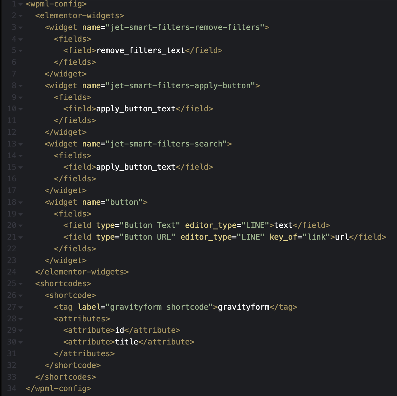

I have the problem for the GravityForms shortcodes. I have already tried this guide before to help with translating the shortcodes: https://wpml.org/documentation/support/language-configuration-files/translate-custom-shortcodes-with-wpml/. They only show up in the string translations and not in the ATE. I have uploaded an image of the XML code we currently use on the site. Maybe you can take a look and see if there is something missing. We have also implemented the following inside the functions.php: https://wpml.org/documentation/support/language-configuration-files/translate-custom-shortcodes-with-wpml/#making-id-attributes-translatable

From the screenshot, it appears that the shortcode is registered correctly for translation. However, to view the attribute values in the translation editor, please follow these steps:

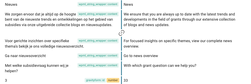

We the information you have given me, I do see the ID of the shortcode. I translated the ID to the right form ID via ATE but when I check in on the front-end the wrong form is still showing. Am I doing something wrong?

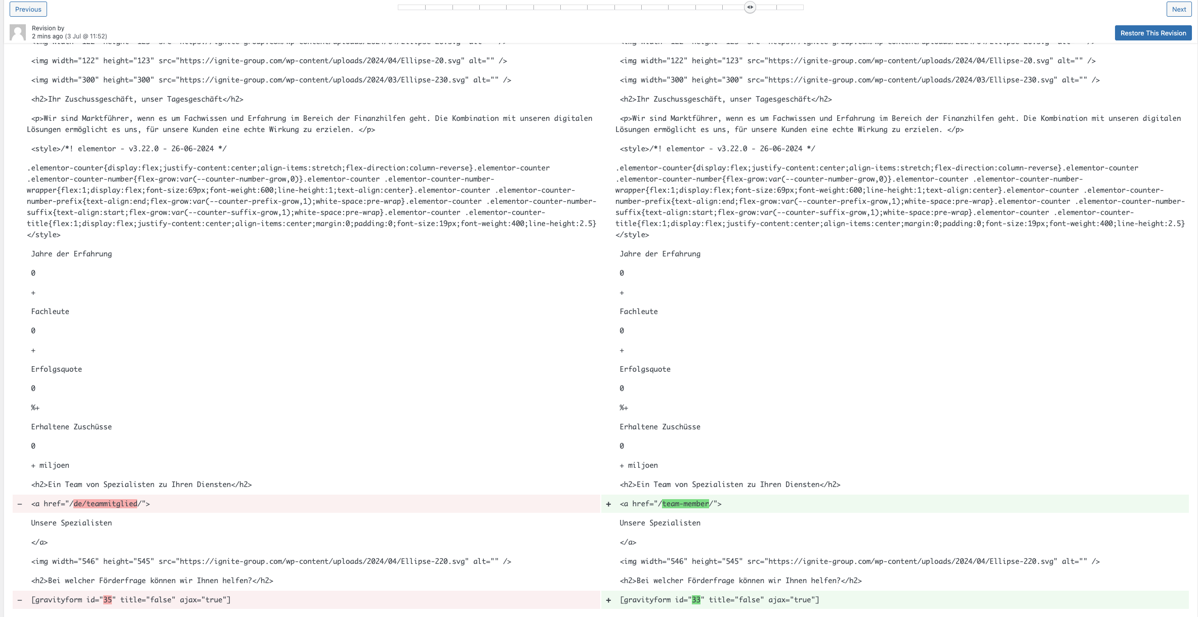

I saw that there was also a string translation for the shortcode, after changing this, the right form is loaded on the page. However, when making changes in the translations with ATE, the change is undone. In the screenshot you will see the last record of the revision log that shows that the ID is being changed while no user is linked to that action. How is this possible? And more important, how do we fix this?
