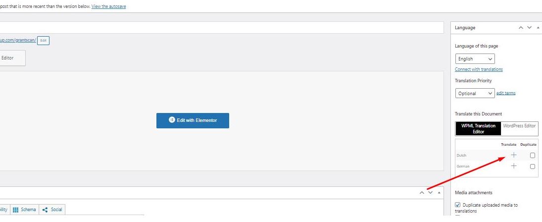

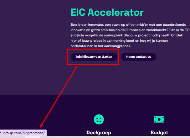

I’ve noticed that the “Grant Scan” page was not available in secondary language that’s why you were facing this issue, so I’ve followed the below steps:
1. Duplicated the "Grant Scan" page into Dutch language to make the page available in secondary language.
2. Pressed the "Scan now and adjust links" button and it changes the button link automatically as you can see in the attached screenshots.
Could you please check and confirm?
Thank you

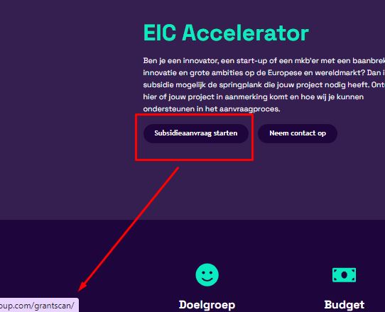

It shouldn't go to that page. Each language has a different page it needs to direct to. Not a translation of the same page. Also the issue is bigger than this specific button. This is only an example of different translations that I could easily find. But it also happens to text fields and html fields where a shortcode is implemented. The annoying thing is that I have tried to fix most of these problems by keep translating them back to how they should be translated so I don't have another example at hand.
The problem is not with me not knowing how to translate. It lies deeper where the systems resets translations. It is also not instantly that they change back so I can see the right translations. But after making other updates to that same page or post, the translation resets.

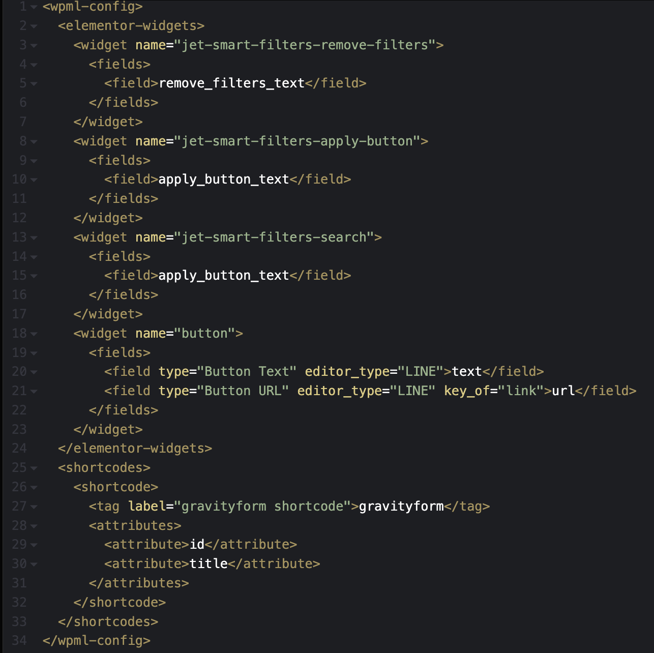

1. Regarding the button translation, If it should not go to the translation of same page automatically, in this case, please try to follow the below steps:
1.1. Add the below XML:
<wpml-config>
  <elementor-widgets>
    <widget name="button">
      <fields>
        <field type="Button Text" editor_type="LINE">text</field>
        <field type="Button URL" editor_type="LINE" key_of="link">url</field>
      </fields>
    </widget>
  </elementor-widgets>
</wpml-config>
In WPML >> Settings > Custom XML Configuration section.
1.2. Make a small change in the default language page to reload the translation.
1.3. Open the translated page in WPML Advanced Translation Editor, search for your button URL and add the translation.
1.4. Clear all sorts of cache and see if this resolves the button translation issue.

I have been testing the solution you have provided and with the XML code added I can find the url's of the links via the Advanced translation Editor. For now it als seems to fix the issue so I hope this will be the final fix and the translations are permanent.

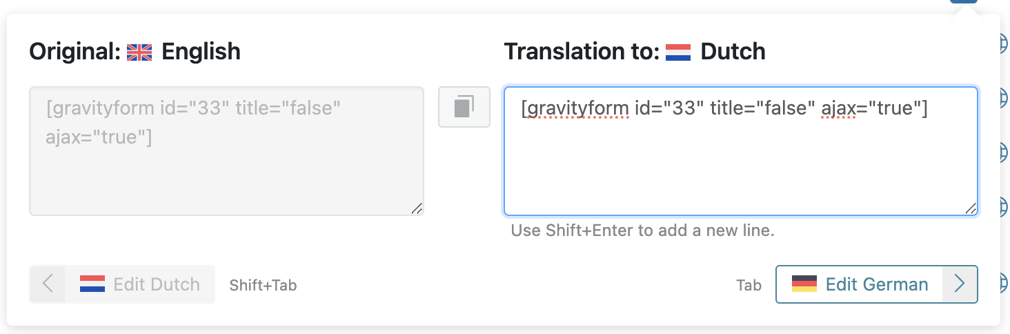

However I have the same problem for the GravityForms shortcodes. I have already tried this guide before to help with translating the shortcodes: https://wpml.org/documentation/support/language-configuration-files/translate-custom-shortcodes-with-wpml/. They only show up in the string translations and not in the ATE. I have uploaded an image of the XML code we currently use on the site. Maybe you can take a look and see if there is something missing. We have also implemented the following inside the functions.php: https://wpml.org/documentation/support/language-configuration-files/translate-custom-shortcodes-with-wpml/#making-id-attributes-translatable

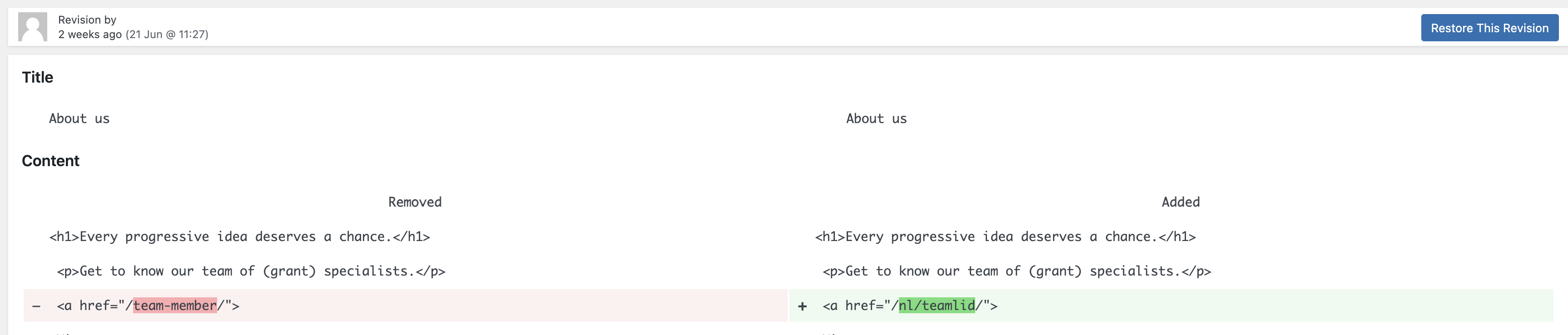

Finally I want to share with you a screenshot of the revision log where you can see that changes are being made without a user. We suspect these changes come from WPML. Hopefully this helps with understanding the problem even better and gives you new insight on how we can solve this.

3. Thanks for sharing the screenshots. WPML only translates pages automatically if the "Translate Everything Automatically" option is enabled in WPML >> Settings >> Translation Mode. Otherwise, it does not make changes without user intervention.
Please let us know if the translation overwrite issue occurs again if you only use ATE, and we will investigate further.

Concerning the translation of pages, this is not done via the "Translate Everything Automatically" option. During our own further research into the problem we have discovered that the translations made without a user have the following id: user_id=0. Can we somehow exclude te possibility that this is WPML that is causing these changes without the interference of the user? It would be useful if we could discuss this via chat to get quicker to a solution. Please let me know if this is a possibility.

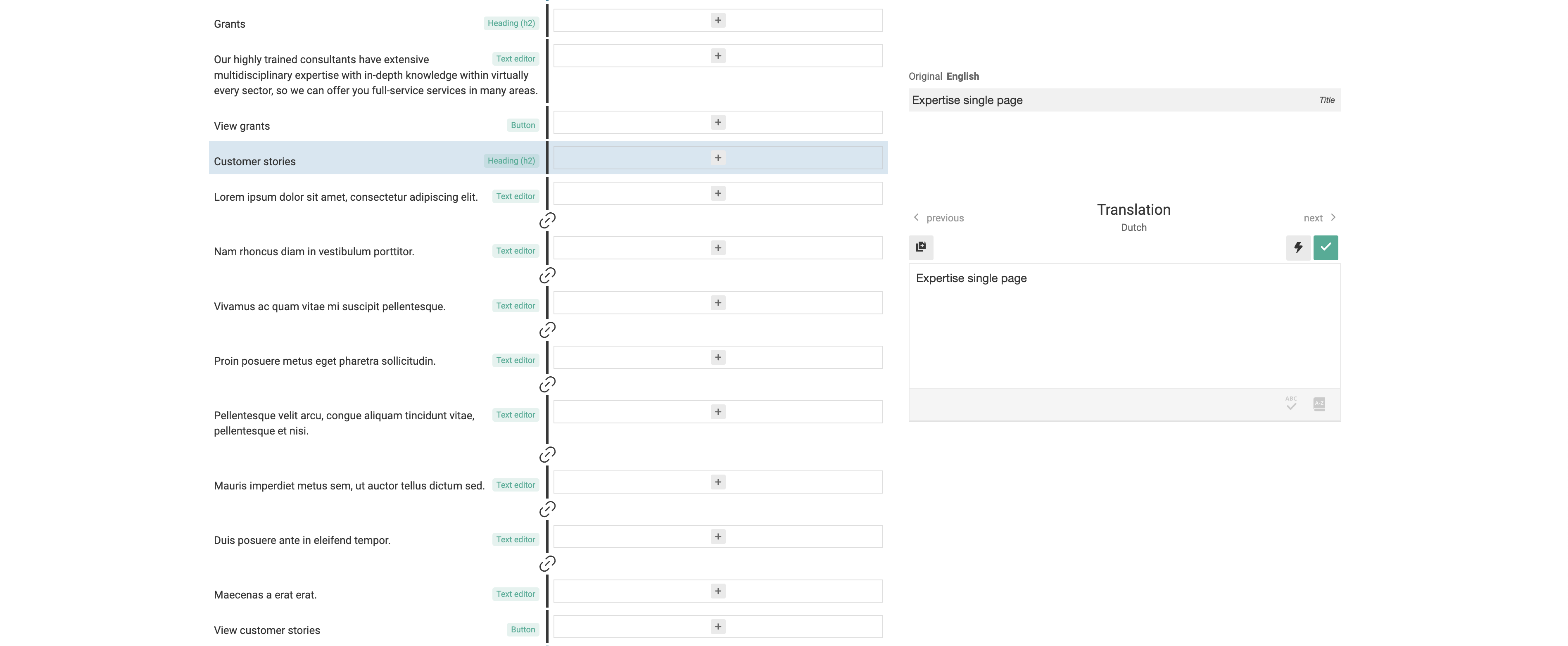

When attempting to edit a translation, all the fields in ATE are empty. However, on the frontend, the pages are still displayed correctly in translation. This is confusing because there should be no translations of these pages/templates.
We tested translating a template and observed changes in the translation from before and after our translation process. However, we noticed that the form at the end of the page was not translated. Since we couldn't find the form in ATE, we checked the String Translations. Here we discovered that for this specific template, multiple translations were made because we started the translation with ATE. These translations include the shortcode that needs to be translated. However, the shortcode translation is just a copy of the original language.

We do not want to change the string translation of the shortcode yet, as this could interfere with our current investigation into this issue. Could you explain why strings in the String Translations are being translated (that are not in the ATE) while the translations were made with ATE?

1. When you translate a page using the default WordPress Editor, the content is saved in the site's database. If you use the Advanced Translation Editor (ATE) instead, the content is saved both in the site's database and in ATE's translation memory.
When you view the page on the frontend, it displays the content from the site's database. However, when you load the page in ATE, it shows the content from ATE's translation memory. Since you've deleted the translation memory, the fields appear empty in the backend, but the frontend still shows the content from the site's database. You can edit the page in the default WordPress Editor to access this content.
