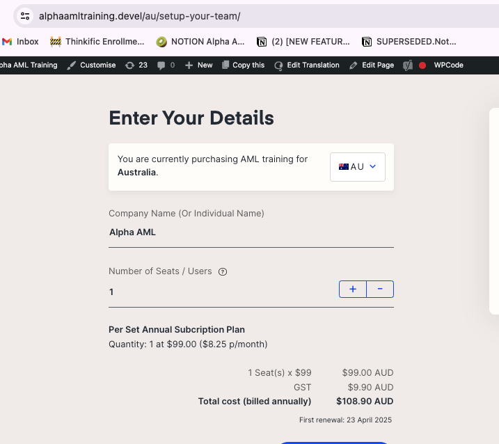

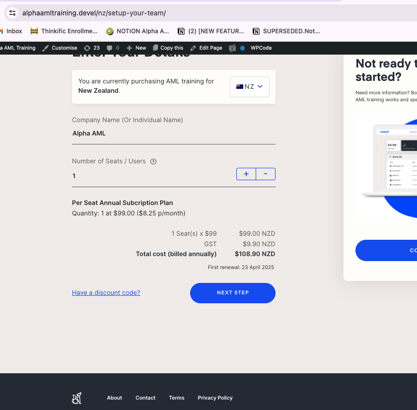

Correct the spelling mistake ""Per Seat Annual Subcription Plan" to "Per Seat Annual Subscription Plan", for translations /gb and /au
Yes, https://wpml.org/documentation/getting-started-guide/translating-custom-fields/ and https://wpml.org/documentation/translating-your-contents/using-different-translation-editors-for-different-pages/ which shows a 'NEW' translation, not how to update translations after initial "Copy Once".
The update to the base nz language works, but the translations are not firing.. probably due to 'Copy Once'.
It's a local site.

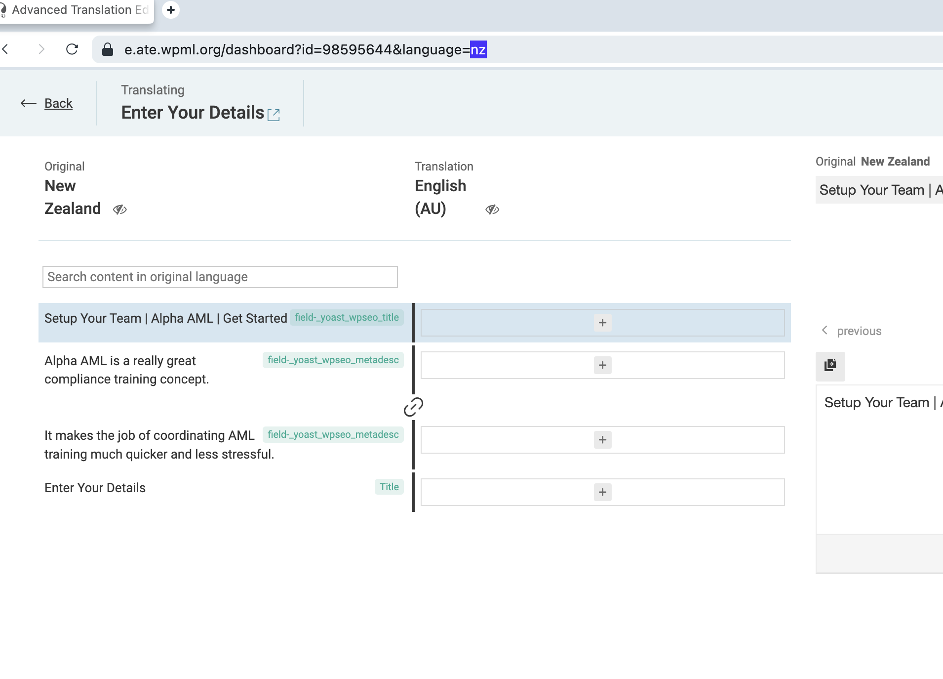

May 5, 2024 at 4:12 am #15593896
emmaS-15
Further details:
Shows the mis-spelling of 'Per Set Annual Subcription Plan", and when I click on Edit Translation I (finally) get to:
But as you can see in the 2nd screenshot, there's no place to correct that mis-spelling as it's an ACF field and not content on the page.
Thank you
