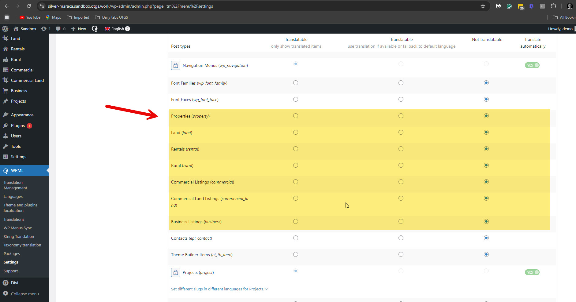

Hi Itamar, sorry for my late reply. I have just uploaded Divi Real Estate child theme, as in my development website, and have imported a demo of Easy Property Listings. You will now view on the website a menu with fake properties setup exactly as the ones I have created on my development website. You can view the properties going to the Property and Rentals sections in the menu located on WordPress left-hand side menu. As you will see, these properties do not feature the regular WPML flag columns available on the regular WordPress pages. Nor can I see where the texts included in these property listings are available for translation, in order to connect them to the automated translation option available on WPML. Thank you in advance for your help!

In WPML -> Settings -> Post Types Translation, all the post types of the involved plugin are set to Not Translatable. Please see the attached screenshot. You should set them to Translatable. This should solve the problem you are facing. Please read the related guide.
https://wpml.org/documentation/getting-started-guide/translating-custom-posts/

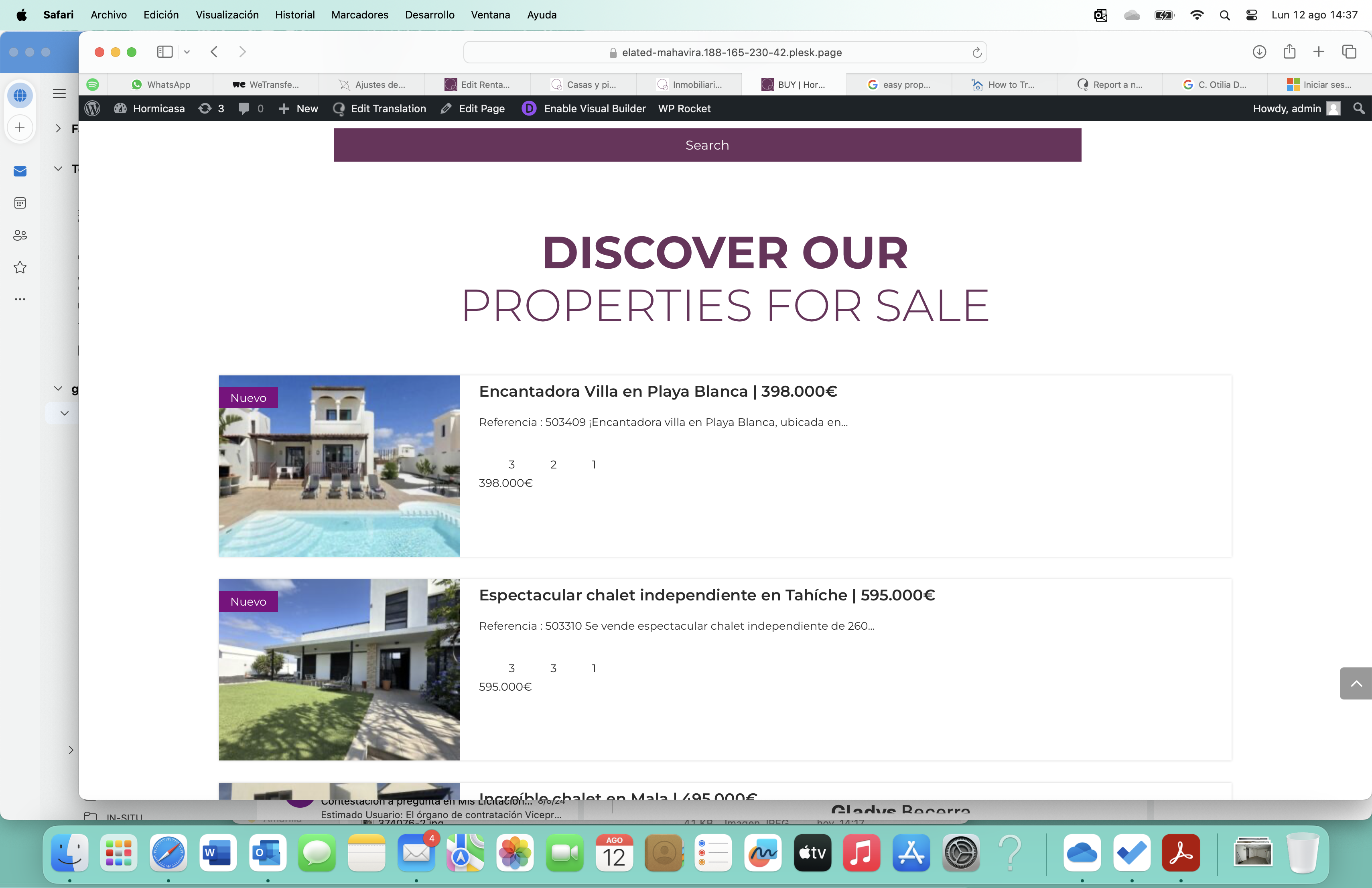

Hello! Yes, the properties are now translated, great! Is there a way to translate the search engine shown in the screenshot enclosed?
