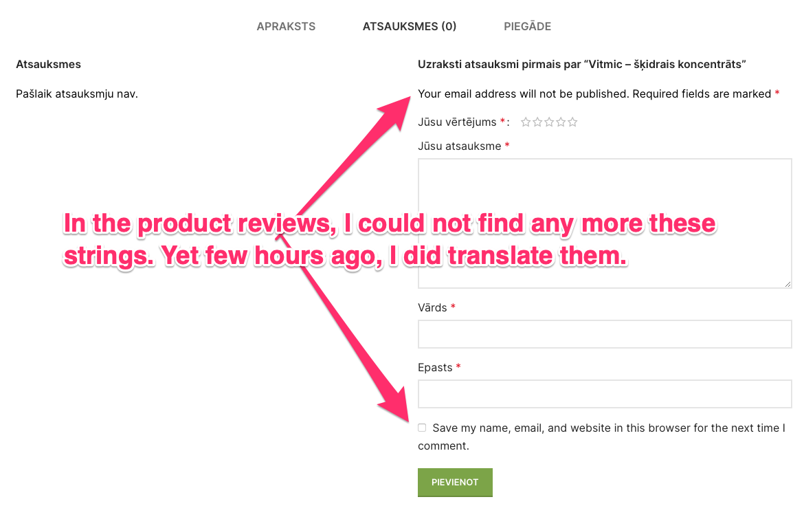

There are two strings that I could not find anywhere. They are in the product review section which is in the middle part of every product: hidden link
March 8, 2025 at 8:29 pm #16791933
janisB-6
And this is the second phrase, which I could not find where to translate it

Just found one more strings that I could not find where he lives. It should be somewhere in Woocommerce or in the some plugin

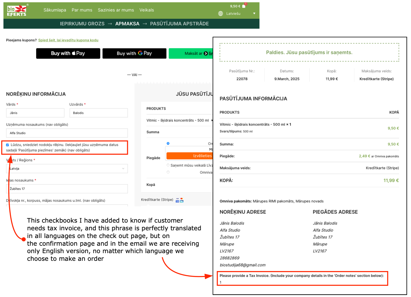

We have successfully moved the development site to the live site place, so please use this link to troubleshoot the only remaining issue that I have: hidden link
Here is only one which is left and for this one I cannot find a solution. Please have a look at the screenshot.
March 10, 2025 at 1:47 am #16794041
janisB-6
I am so frustrated with this Translation stuff. I came across again, so many Russian words getting into the translation. Then I ran again, deletion of all the default strings. After that I have lost some translations that I did before. For example, the one that you can see now in the attachment, it appears again. All the languages kept their translation, apart from Latvian language.
Reinstalling, Latvian language WordPress should not be executed anymore, because that destroys some of our core shop structure. But at least I would like to find where these strings that you can see in this screenshot live so that I can finalize the Latvian translation.

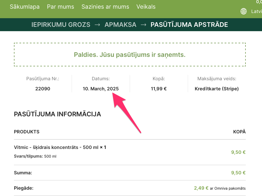

March 10, 2025 at 2:21 am #16794068
janisB-6
Also, all strings for month spelling have disappeared from the string translation...
I feel like a dog, which is chasing its own tail, just running in circles... 🙂
March 10, 2025 at 2:30 am #16794070
janisB-6
Here you can see that the word March is somewhere, and it was in the string translation before, but now it disappeared
March 10, 2025 at 3:59 am #16794132
janisB-6
Maybe after deleting default strings, I actually had to reinstall latvian language WordPress? And that is why I have lost some of the strings like month string translations? Please, advise
