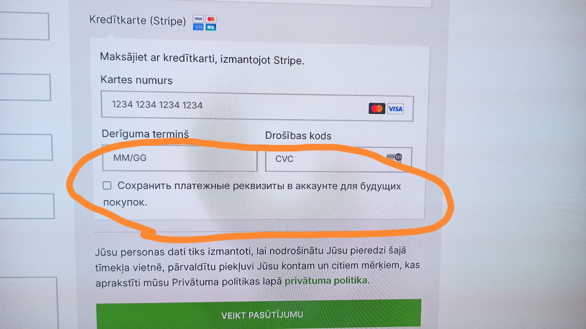

Maybe this one also help to trobleshoot the issue. When I am logged i, viewing site from a user with the "default language" site view, in some places appears the russian terms. But as soon as I view the same place from the outside (i.e. logged out), all the strings appear correctly translated
March 17, 2025 at 9:53 am #16823725
Alejandro
WPML Supporter since 02/2018
Thanks for the head's up. the issue happens mainly with WordPress (default) and Woocommerce domains and we're trying to spot the reason why. I'll let you know as soon as we find anything up about this 🙂

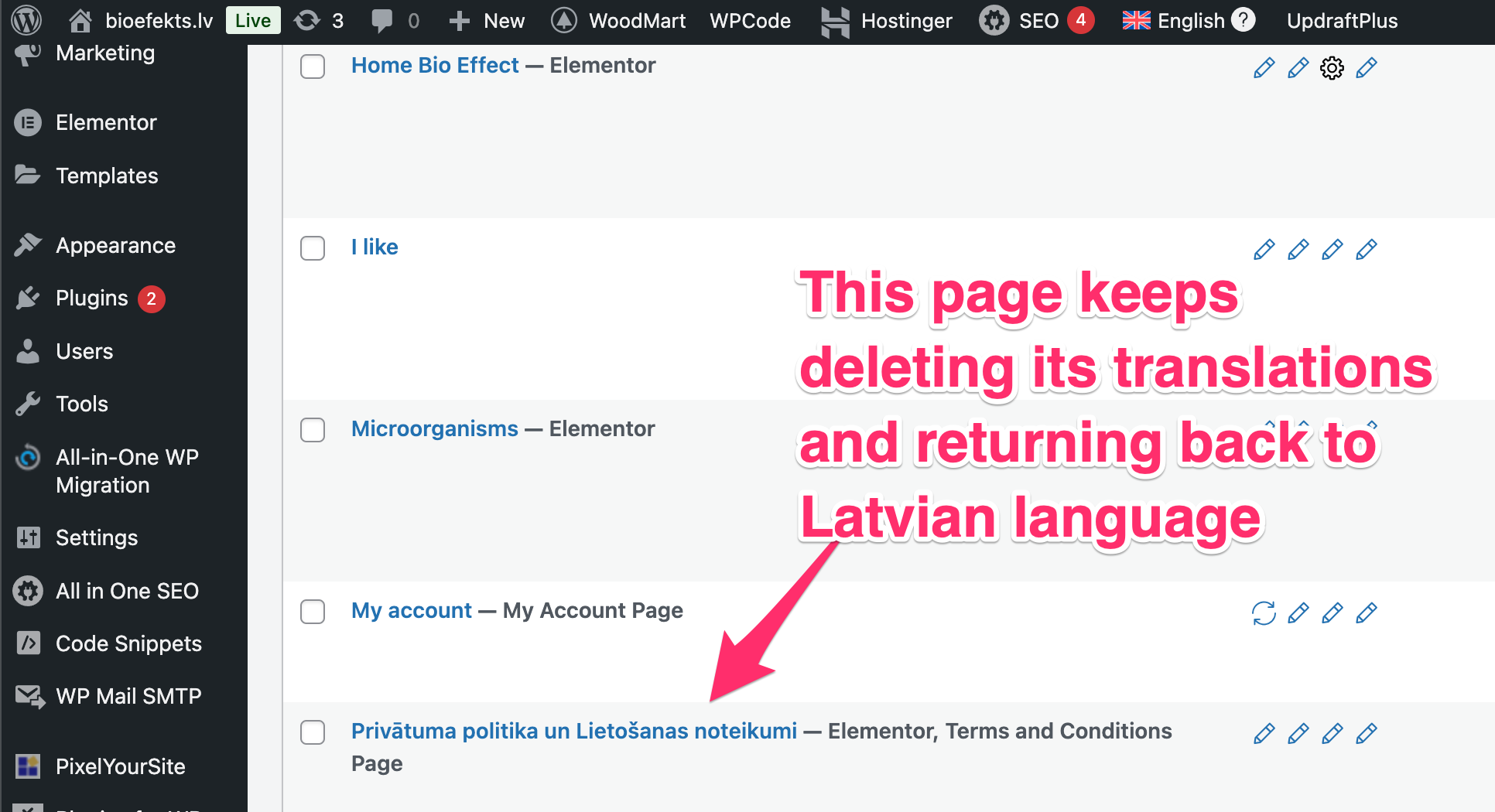

But now is a new issue. I have three times re-created all our privacy policy pages, but your plug-in keeps deleting them and leaving only the Latvian version in all languages. Please, kindly, look at what could be the issue.
Otherwise, our payment gateway providers are complaining that we are not providing privacy policy terms in other languages, especially in English for European Union members.
Thank you in advance!

Hello there.
This issue is entirely different from the others we had tackled.
Can you please edit the translated versions of the terms and conditions and see if you have a "blue box" section under "Languages" (where you usually click to translate the page to other languages).
If you do, then please click "Translate Independently", the only button on that section because it seems that page is duplicated instead of being translated, so as soon as any change happens on the original language of the page, it re-syncs the translated versions to show the same content as the original version.

And from where should I do that translation of the terms and conditions page? Because before I sellected pages with the upper language switch in different languages and then in the Elementor pasted text from the translated word documents. As you see from the previous attachment, this would be the place I would translate the english version of the Privacy policy by going from there to edit that page in the Elementor.
May 27, 2025 at 1:21 pm #17078718
Alejandro
You can check this video out, it might be useful in this case: hidden link
As per the "how", i'd strongly recommend you use our translation editor, it makes things easier in the long run: https://wpml.org/documentation/translating-your-contents/advanced-translation-editor/
Let me know if you have any further questions.

janisB-6
Thanks, your first suggested option worked well.
Such a simple thing, but without your expert knowledge I would not figure this out,
Thanks again.

Hm, you're right, i saw that the strings we have fixed more or less remain as such but I installed a new plugin to test something and I saw that the content is mixed between Russian and Latvian.
This tells me there are references to russian somewhere in the site, I just haven't been able to find where. I'm asking our devs for help to see if they can successfully identify where the problem lies and how we can fix it.
I'll keep you informed.
May 28, 2025 at 1:15 pm #17083624
Alejandro
I think we found the problem.
All the issues stem from the fact that the site was once russian. when that happened many files from WordPress and Other plugins (the ones that contains the translations) left russian as the laguage but renamed the file to latvian.
Many were translated and they were correctly translated into all the languages, some were left as russian, though and in that case that's what you were seeing.
the problem is that with updates, the content was still russian and got updated by a plugin or WordPress and by updating the content (which is ok and expected), the content returned to English.
In order to fix this we needed to delete all the strings and start from scratch, this time making sure the files were indeed in Latvian.
I did that for you (it took a few hours to delete everything correctly) and the problem should be gone.
I tried to translate many of the content but couldn't finish everything. most of the content left doesn't seem to really require a translation so please check the front-end for missing content (it should appear in English this time, which is expected) and then try to find it in WPML > String Translation.
