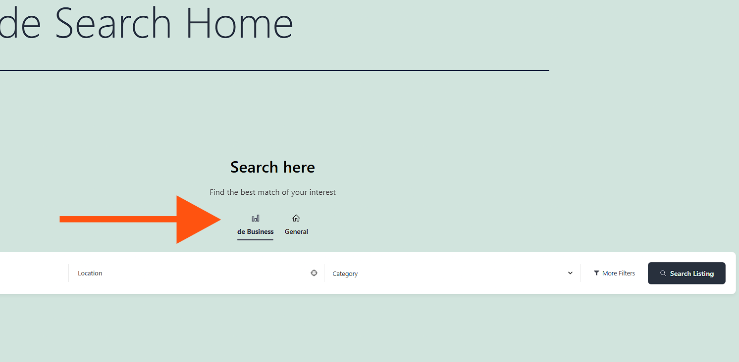

November 7, 2025 at 6:48 pm #17558315
I just realized something in my sandbox today.
Each listing has a Directory Type, and currently, all listings use the Business Type.
If I visit the translated pages on the sandbox and select "Business" I can see the translated listings, and the "All listings", "Add listing" or "Search form" will work as expected.
See screenshot.
Example:
Page with widgets:
It also works for the translated Elementor Widgets, if you select the proper directory type filter.
Please take a look into this and let me know if you have further questions.
This said, the translated pages and Elementor widgets do work, I am simply not understanding why on translated pages I first need to select the directory type, and on original pages there is no such select option.
I can no longer confirm that Directorist is not translatable; it is just unexpected that there is a directory type filter on translated pages but not on original pages. I am consulting this with the compatilbity team.
I am further escalating regarding the missing custom XML configuration for the Elementor widgets.

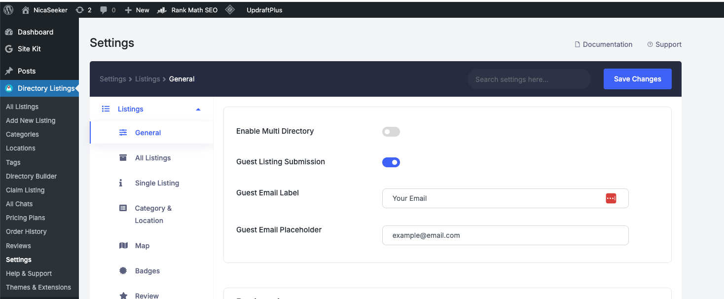

November 7, 2025 at 7:00 pm #17558353
sharonH-6
Hi Andreas,
Thank you so much for your latest message and your ongoing support.
So, that is another Directorist bug: I have more than one directory but I only want the Business directory to show. In Directorist, there is a setting where you can make Business (in my case) your primary directory and turn off the others from displaying. But guess what ... there is a bug that means that it doesn't actually work on the front end. So I had my developer fix this issue but then it returned with a new Directorist update and he only recently fixed it again. In my stage.nicaseeker.com site, he's fixed the issue and pushed that fix to the live site. But on checking your sandbox, if you switch multi-directory off, the bug is still there - it doesn't save. Well, it does appear to save but if you refresh the page, multi-directory reverts to on. So does that mean everything is translatable then - and that I can continue translating and the translations will save or is there still a long list of issues that need to be addressed?
I look forward to your update on the other issue in due course.

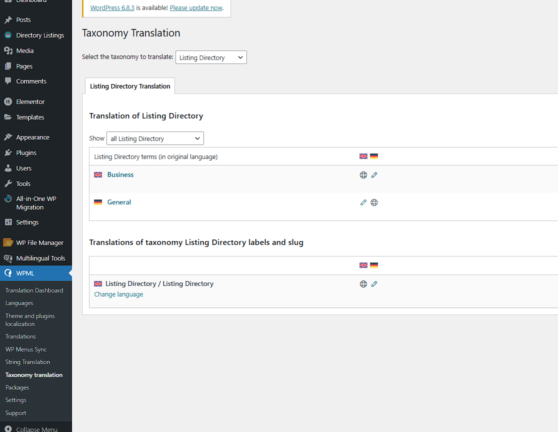

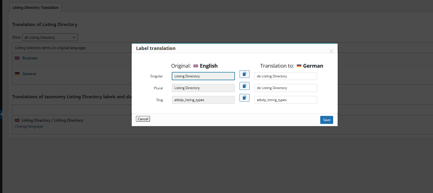

November 7, 2025 at 7:42 pm #17558517
The directory type issue can be solved by going to WPML > Taxonomy Translation and making sure that "Listing Directory" is translated.
Important is also important to translate the base slug atbdp_listing_types.
See screenshot.
Please give this a test on your site.
November 7, 2025 at 8:47 pm #17558638

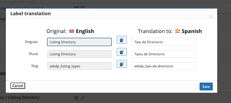

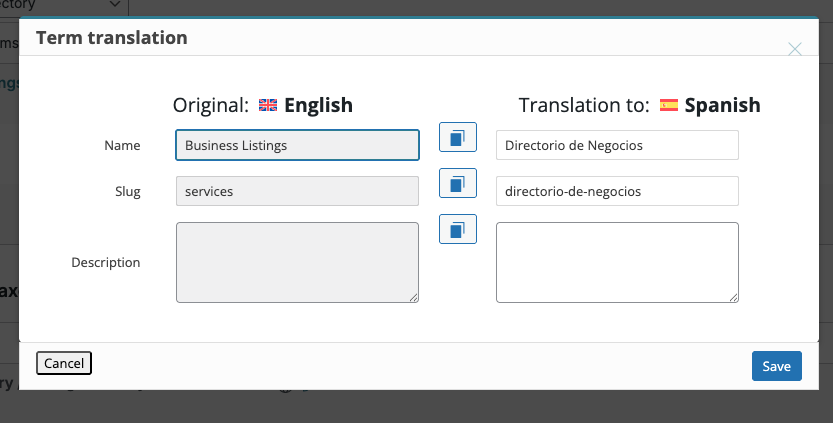

sharonH-6
Thank you so much Andreas, so with the base slug, I need to translate it into Spanish?
I'll implement those other translations as advised.
Below are screenshots of what I've done ...

November 7, 2025 at 9:14 pm #17558702
I have not tested to translate the base slug and would suggest using in this case the same slug atbdp_listing_types in both languages.
Indeed, you would need to create some translations to confirm if the issue is solved.
