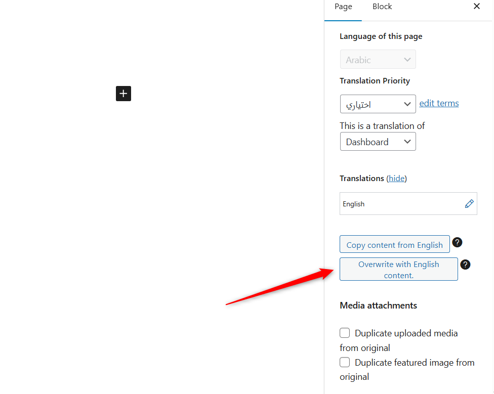

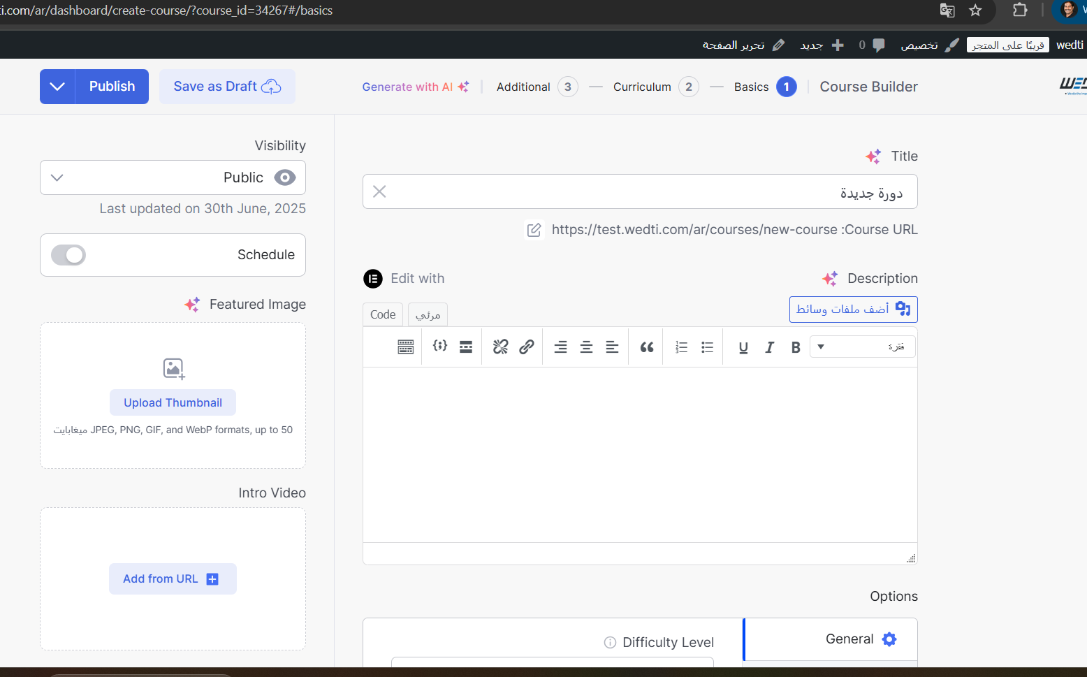

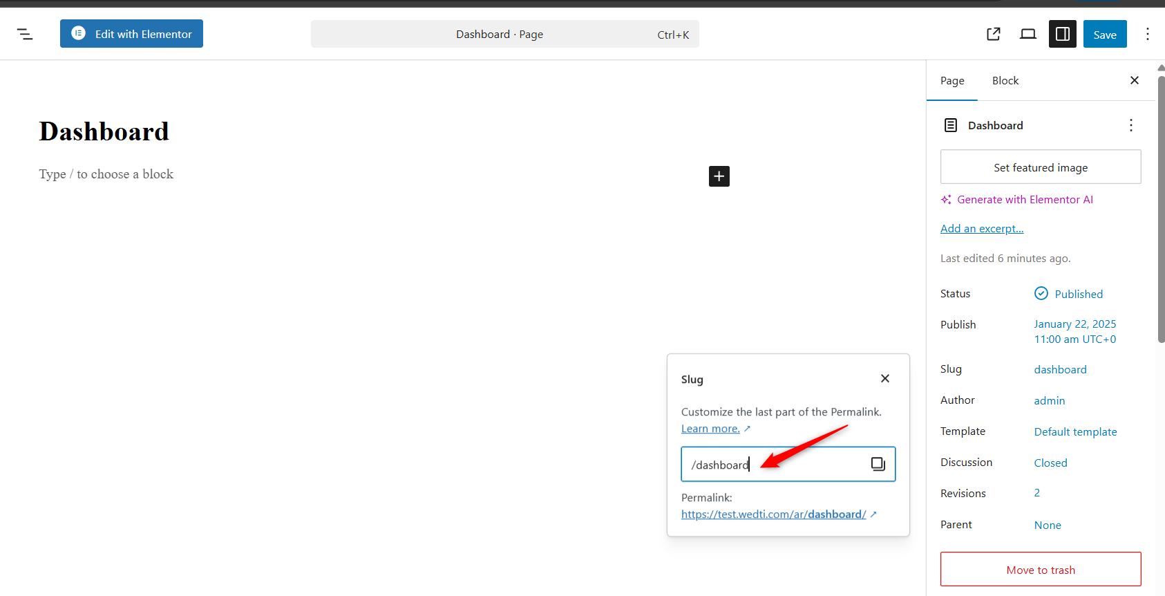

However, we are getting the expected results on your test site (hidden link) after following these steps. Please try them and let us know your feedback.
1) Upgrade to the latest version of the Tutor LMS plugins.
2) Open the Arabic Dashboard page for editing: hidden link
3) Overwrite its content with that of the English Dashboard page.
4) Change the slug of the Arabic page from لوحة-التحكم to dashboard.
5) Save the changes.
6) Visit Settings >> Permalinks and resave the settings.
This may be a conflict related to the Arabic translation of the Dashboard page slug, especially since it includes several dynamic subpages like "create-course". Please refer to the attached images for more details.
