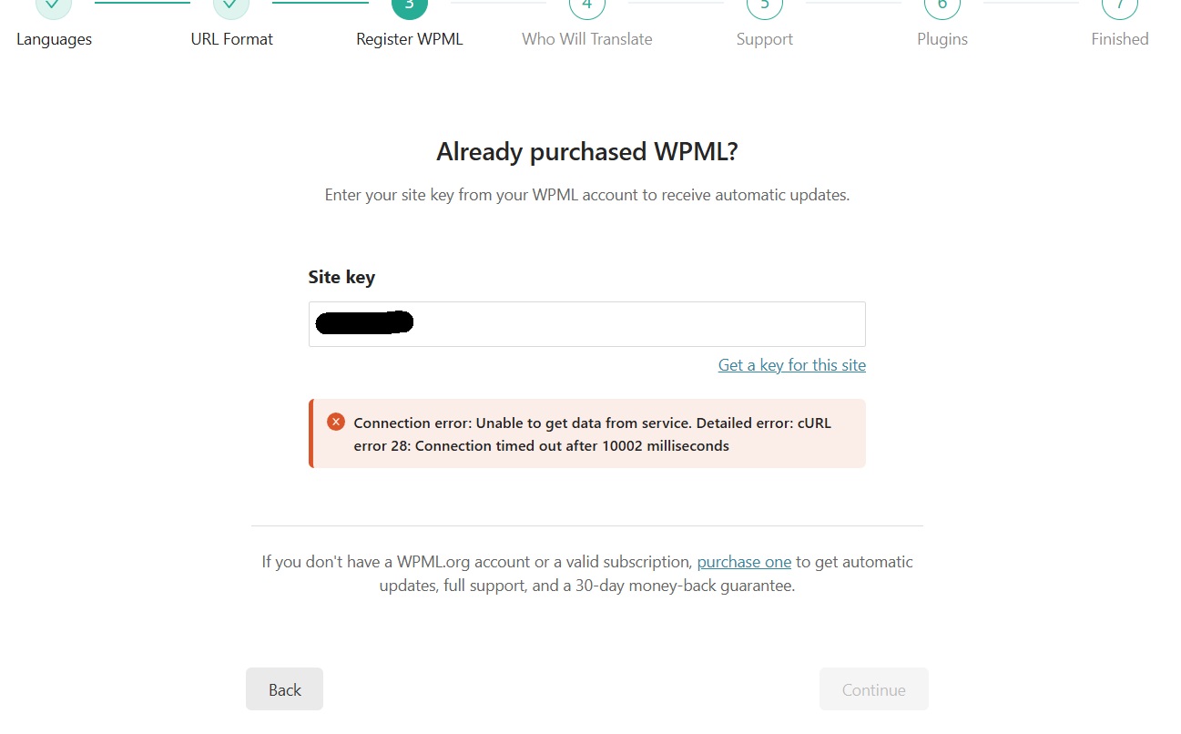

I am trying to register the WPML plugin on my site hidden link. I am using GoDaddy as a server provider and also using Cloudflare.

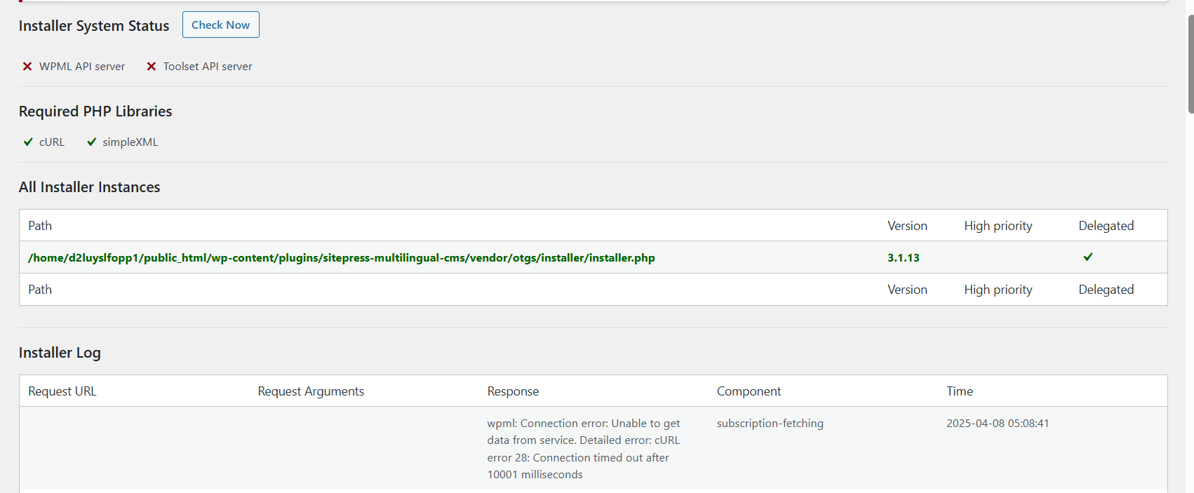

I get a connection error when trying to activate the plugin: 'Connection error: Unable to get data from service. Detailed error: cURL error 28: Connection timed out after 10028 milliseconds.' I see a red 'X' on WPML API server and Toolset API server in the 'installer system status'.
Where and how do I whitelist the domains wpml.org, cdn.wpml.org, api.wpml.org, api.toolset.com, and cloudfront.net?
Can you help me register this plugin on my site, maybe using the backend or another method?

I suspect it is not a key issue, but rather that your firewall is blocking the connection.
While you see
you most likely won't be able to register.
Can you please try the other steps I suggested and let me know how it goes?
