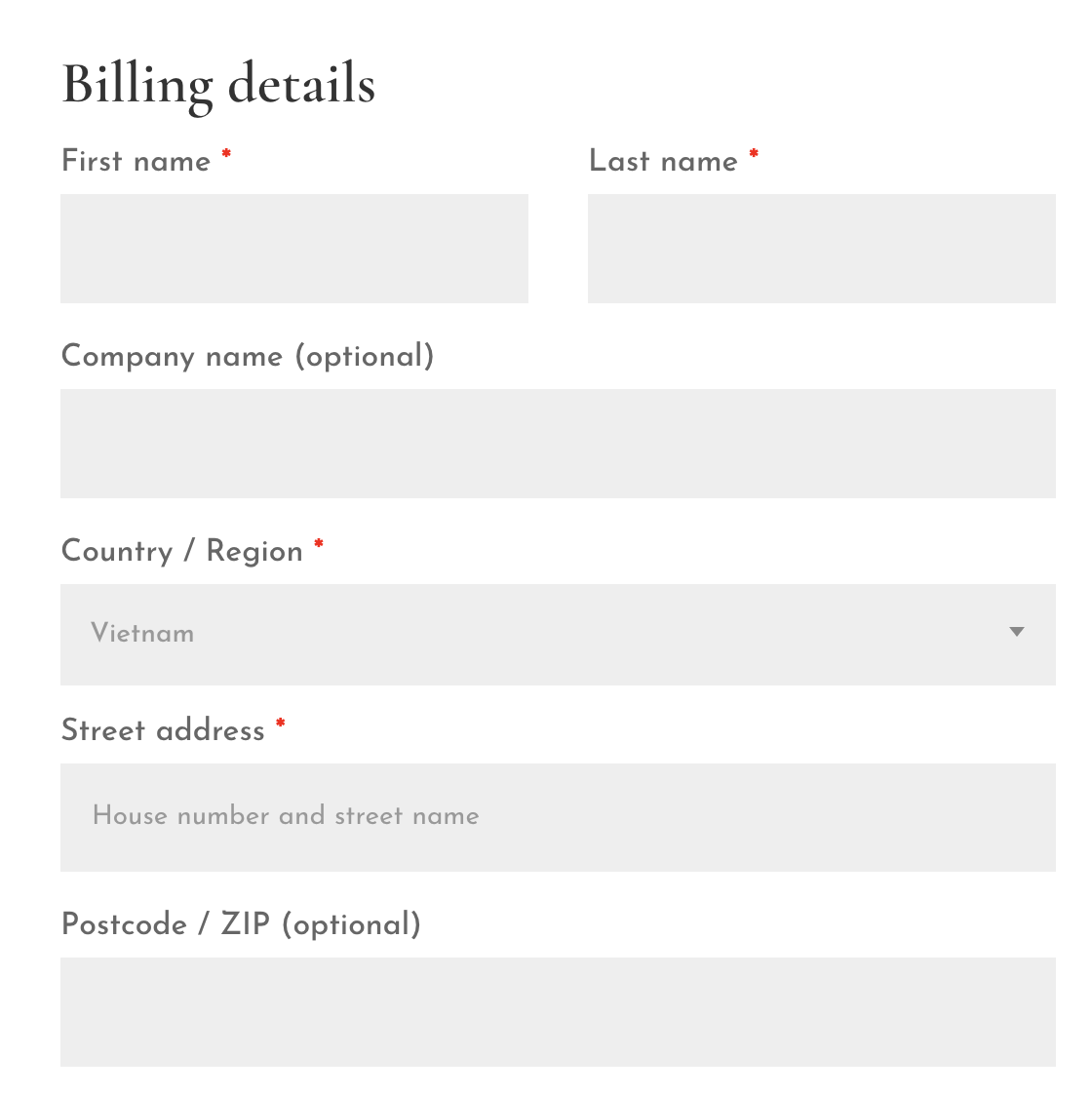

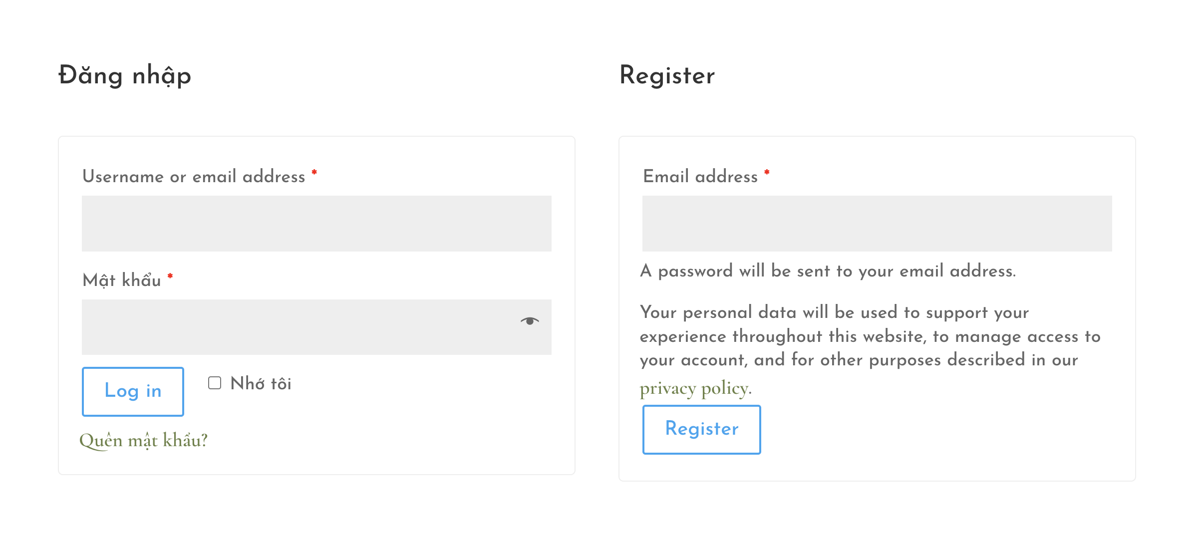

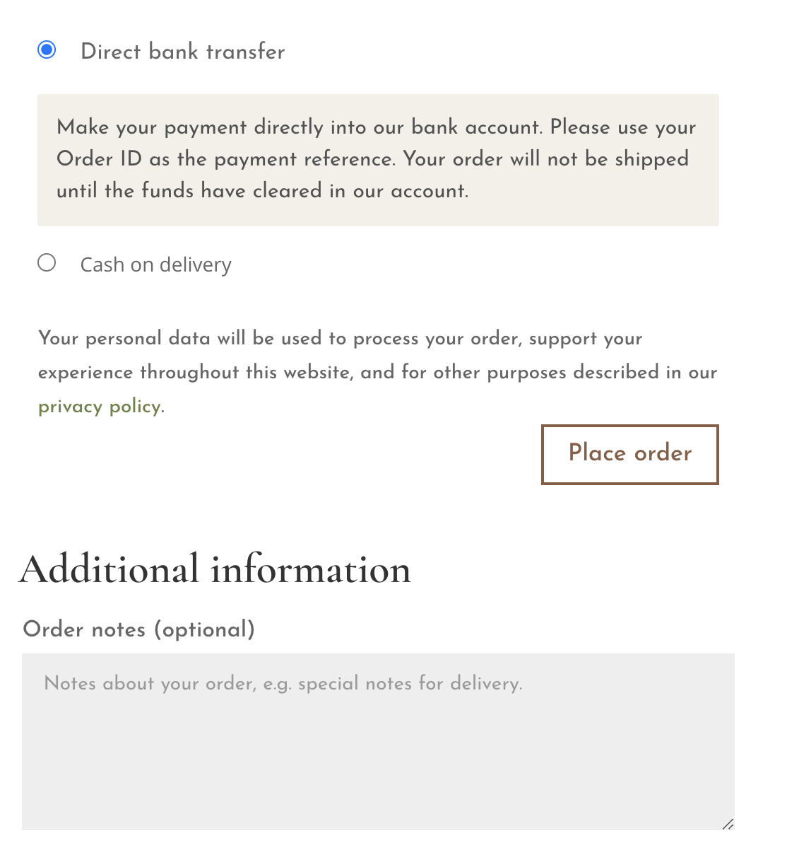

Hello, I'm trying to translate my WooCommerce pages into Vietnamese but struggle to do so despite having installed WPML and WooCommerce Multilingual.
As I have set up in WPML, Vietnamese is my website's default language, and English is my second language. Supposedly, when I download WooCommerce Multilingual, all my WooCommerce pages (shop, cart, account, etc.) should be automatically translated to my default language, right? However, in the Vietnamese version of my web, all the WooCommerce modules remain in English.
I only managed to translate some English text in the WooCommerce pages using WPML string translation, but that's not enough. I found out that if I deactivate the WPML plugin, then switch my site's language to Vietnamese, the WooCommerce pages are all translated to Vietnamese just fine. So, is there a problem with the plugin's setting?
Here's the link to my site: hidden link

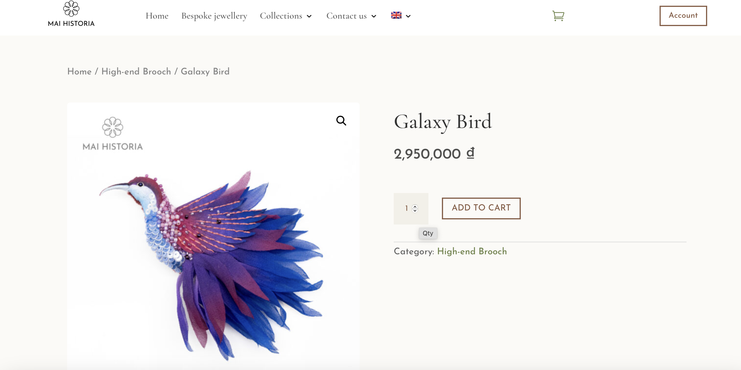

May 5, 2024 at 5:08 am #15593933
nguyenM-3
However, when i change the product page to English, it still appears.
That is why it is so strange.
Because the original language of my website is Vietnamese, not English.
I attach here the photo of the product page in English.
