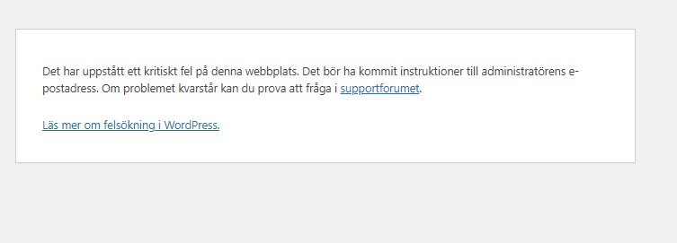

I am trying to resolve an issue where WPML changed our Home page and added the header Home under our primary menu. This error makes my theme's (Astra) customizer unavailable. I found an old question recommending a change in wp-config.php (define('WP_DEBUG', false);) which I tried but it did not help. Link to a page where the issue can be seen: hidden link
I get an error message: 'This site has encountered a critical error. Instructions should have been sent to the administrator's email address. If the problem persists, try asking in the support forum. Learn more about troubleshooting WordPress.' Additionally, there is a PHP Deprecated warning: 'Creation of dynamic property wpml_cms_nav_cache::$cache_to_option is deprecated in /www/webvol9/zb/zsnj3aj8g62cn35/alrp-ab.se/public_html/wp-content/plugins/wpml-cms-nav/inc/cache.class.php on line 37.'
How can I make Astra's customizer available again?

March 6, 2025 at 4:57 pm #16784781
ronnieP-5
This swedish error message appeared on the screen once before. WP asked us to do a modification "enable WP debug mode". We did that and the message disappeared.
Suddenly the message showed again. In the log file the last error points to wpml-cms-nav, and therefore I assumed it was a new error relating to wpml. This might not be the case, what do you think?
" /alrp-ab.se/public_html/wp-content/plugins/wpml-cms-nav/inc/cache.class.php on line 37"
I deactivated WPML CMS NAV plugin but the message still pops up instead of the customizer section.
