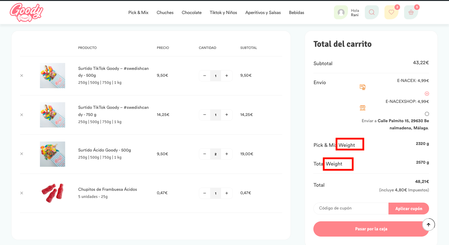

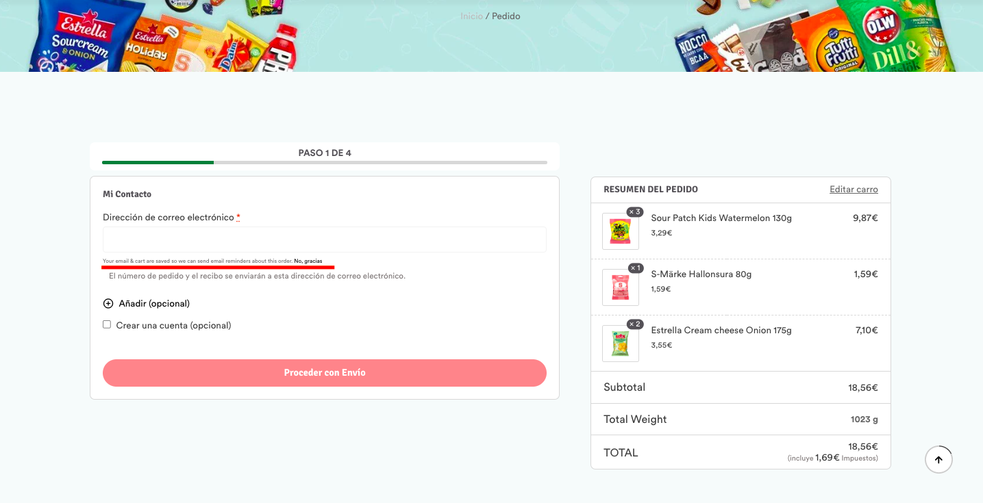

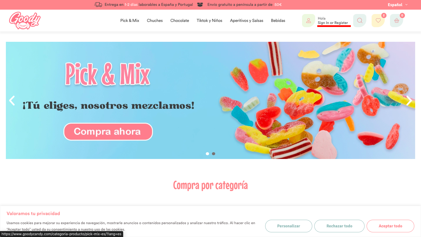

I have solved the admin language now. But what I discover these days is that I now receive certain admin emails in Spanish, such as Wordfence, Cart abandonment, even orders, etc. How can I solve this?
Another thing I need help with is that I still have some texts that I can't find and can't translate. I have searched in String translations but can't find them. I will attach pictures of these text snippets, maybe will be easier for you to help me then.
Thanks in advance.

For the other question/issue, I recommend opening a separate ticket/chat because as per forum policy we can only handle one issue per ticket/chat. So you can get more to the point help, without mixing up several issues in one long ticket.
I'll also recommend checking https://wpml.org/documentation/getting-started-guide/string-translation/finding-strings-that-dont-appear-on-the-string-translation-page/ for the strings which are not found in ST.
However, for any issue other than originally reported in this ticket, please feel free to report separately (as requested above).
