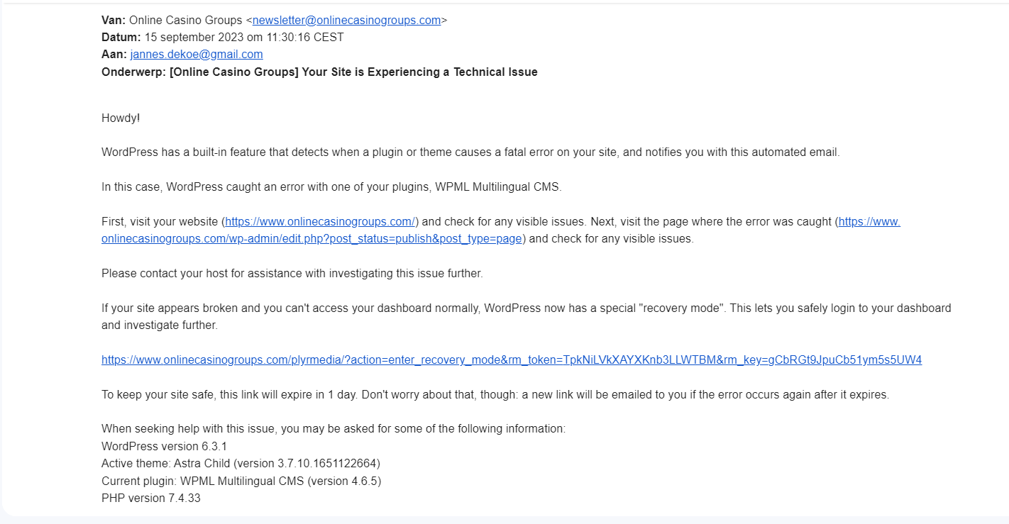

Check if there is an issue on my website
The email that I have been sent by WPML
I don't know. This is the first time I am seeing this email.
