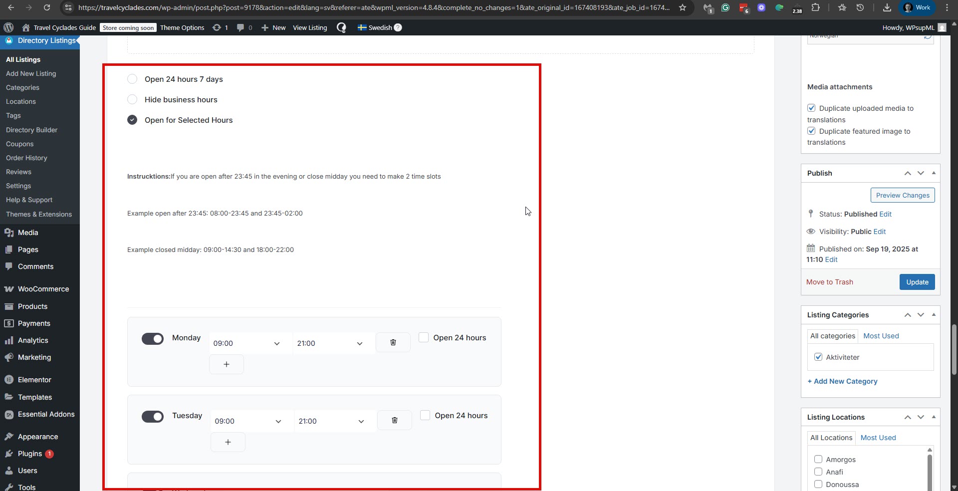

I checked the settings on your site. I think it is related to the opening hours for each listing. Please see the attached screenshot. I switched a few settings to copy, but so far it hasn't worked. I will need to test things on a sandbox site. I'll investigate this and get back to you.

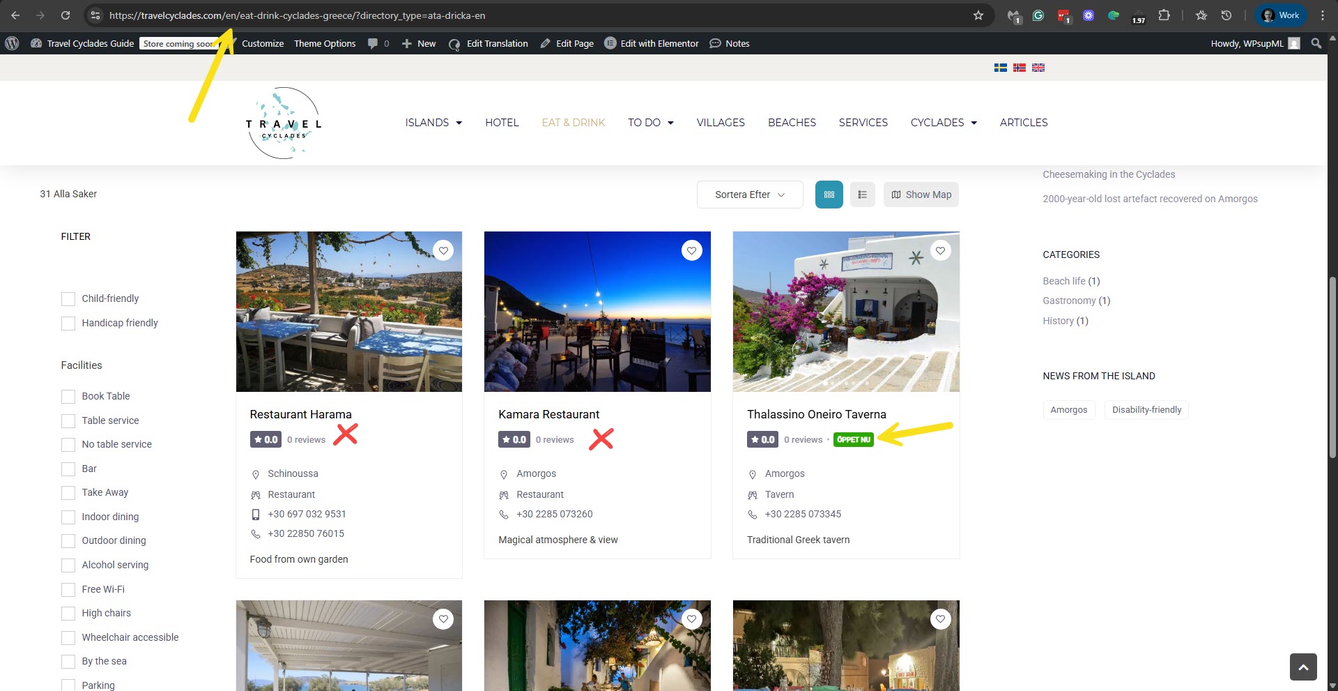

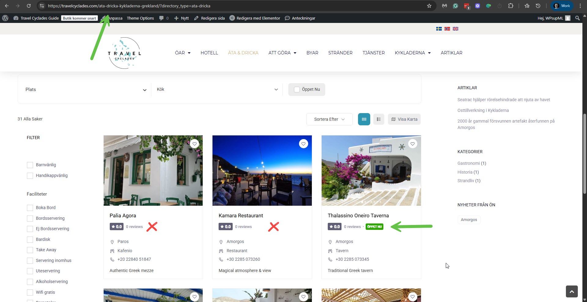

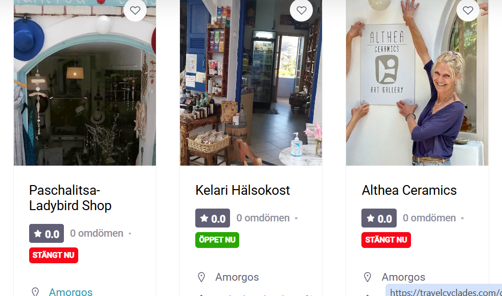

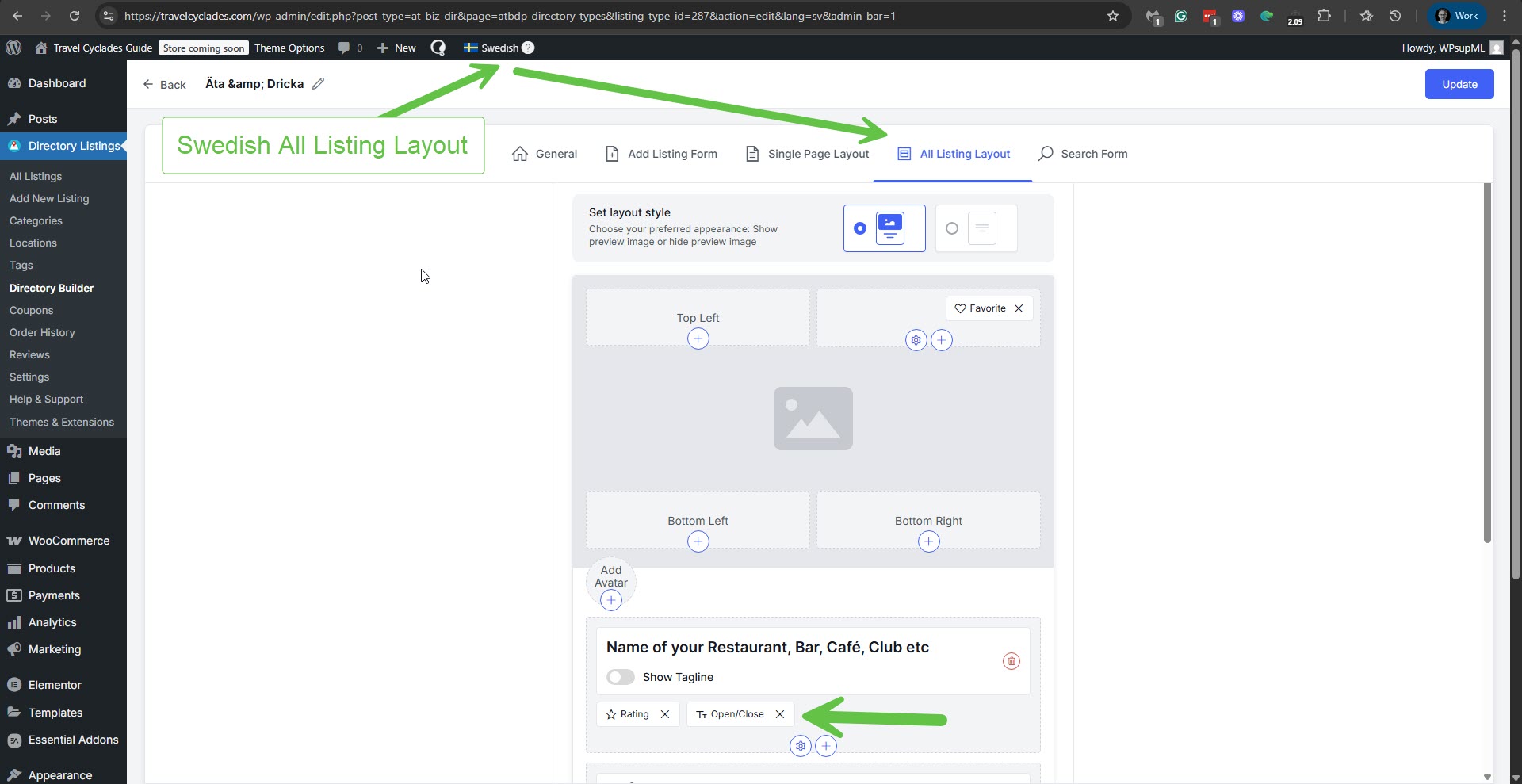

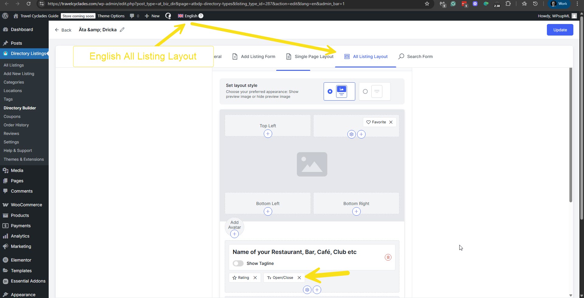

I re-checked this issue on your site, and as far as I understand, the open/close badge is displayed if you set it in Directory Listing -> Directory Builder -> All Listing Layout. Please see the attached screenshot sv-all-listing.jpg. I can see that on your site, it is set like this for English as well. Please see the attached screenshot en-all-listing.jpg. And on the all listing page in Swedish, I can see that not all open/close badges are displayed. Please see the attached screenshot sv-open-close.jpg. The same goes for English. Please see the attached screenshot en-open-close.jpg. So the point I want to stress is that it does not seem like a WPML issue. In other words, if also in Swedish, not all the open/close badges display, so the problem is elsewhere. Maybe it is a matter of setting the opening and closing hours correctly. But I don't see how it is a WPML issue. Please let me know what you think.

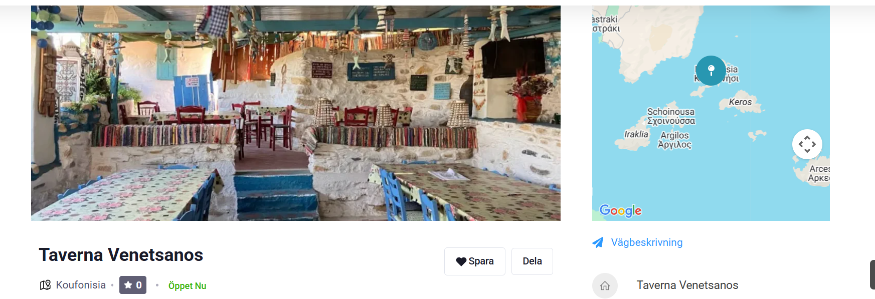

I think you have missunderstand, it's for the singel listing and only show in the main language Swedish, see attached image.
But maybe as you say not a wpml issue, I will take it with Directory

I can see that on the translated listing you provided as an example, the open/close badge isn't showing: hidden link.
Please explain to me how you make the open/close badge display on a single listing in Swedish, your site's default language, and I'll try to see if I can figure out why it is not showing in the translations. Please provide clear, concise explanations and include screenshots.
