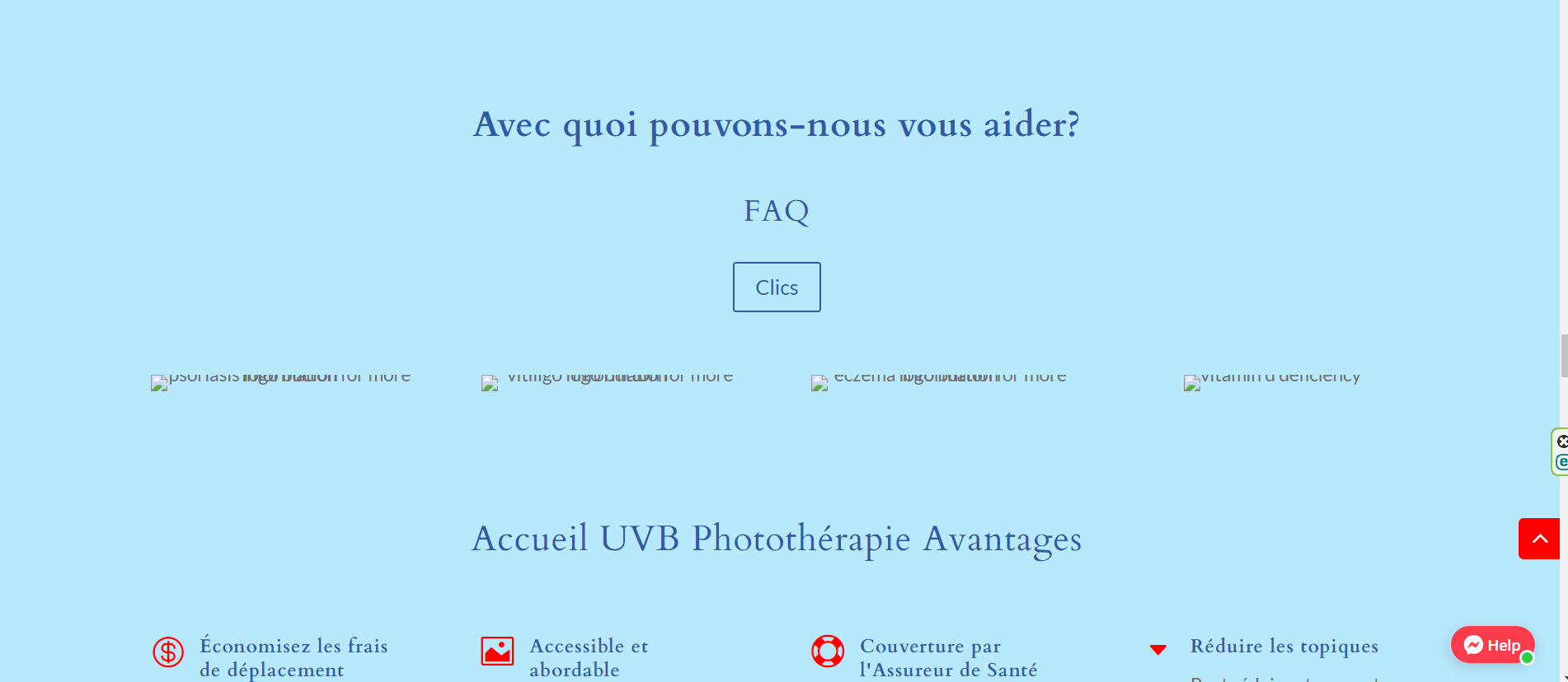

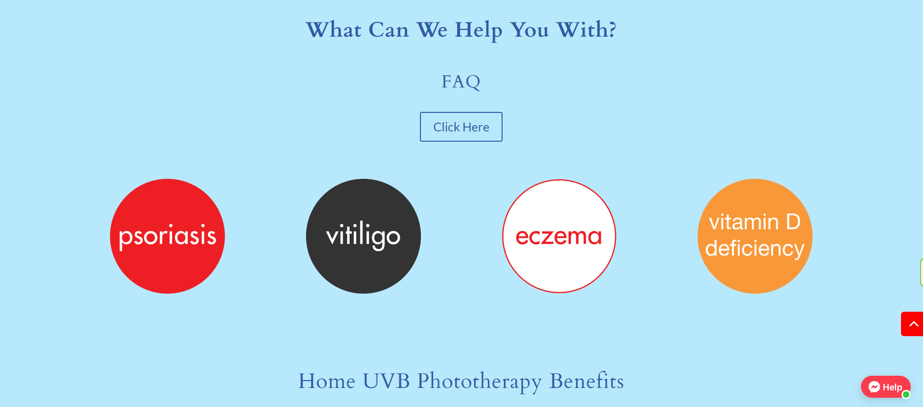

The issue isn't resolved. Yes, I got the brand logos to appear however the problem still exists. For instance, if scroll down to the "What can help with" section you will see four images describing different medical conditions that won't load on the FR or ES languages.
I am hoping your code can resolve this by including the full code I used from your site, can you please send me the corrected version in it's totality.
