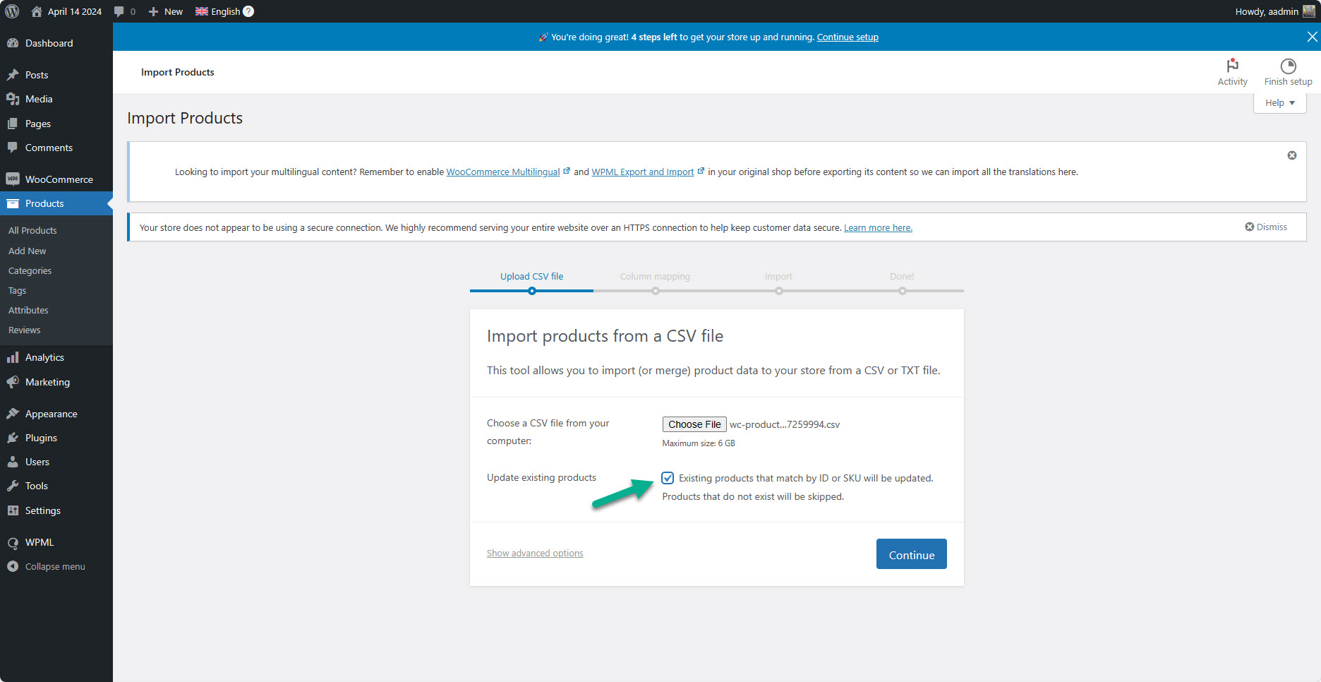

4. You should start the import process by importing English products. In the import process, you must select the option to update the existing products. Please see the attached screenshot existing-products.jpg.
5. Then, you should import the Arabic file. But this time, do not select the option to update the existing products.
