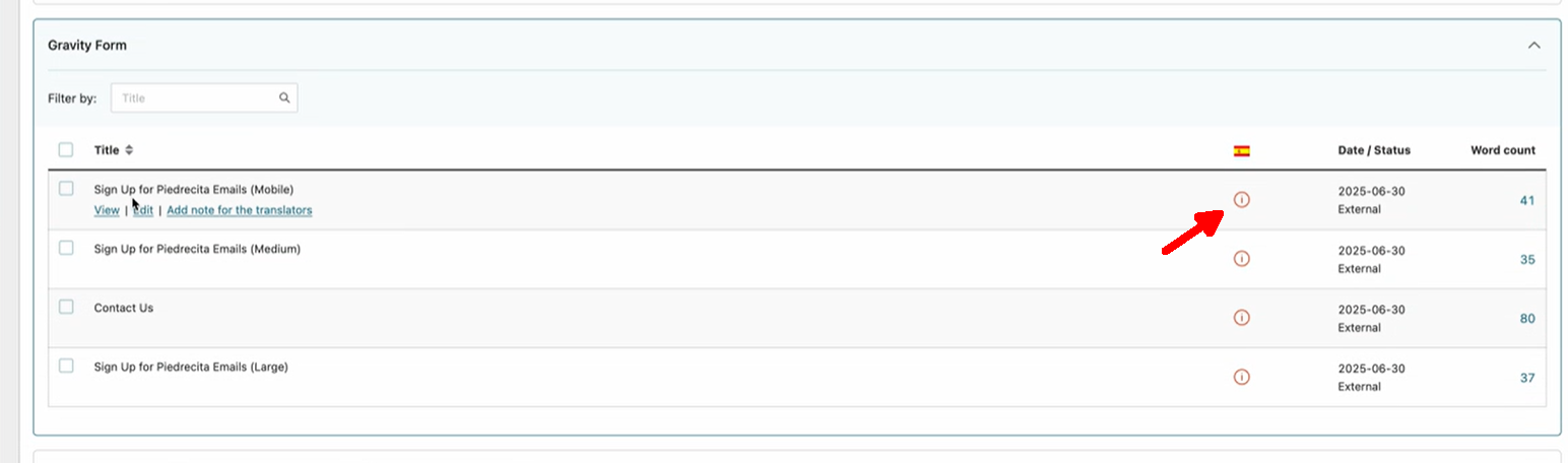

July 3, 2025 at 6:20 am #17195341
Bruno Kos
From the translation management screen, I noticed the red warning icons next to the forms — this indicates that they haven’t been translated in WPML yet, which would prevent language-specific routing (e.g., adding Spanish users to the Spanish Zoho list).

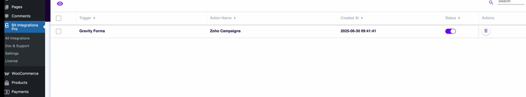

To clarify the current setup:
- Is the Zoho mailing list specified directly within the Gravity Form itself (e.g., via a field or setting)?
- Is the list mapping handled entirely through Bit Integrations Pro — where each form is automatically tied to a specific list behind the scenes?

July 4, 2025 at 6:44 am #17199910
Bruno Kos
After completing the translation, Translation management should definitely indicate that the form is translated so we need to figure out this first.

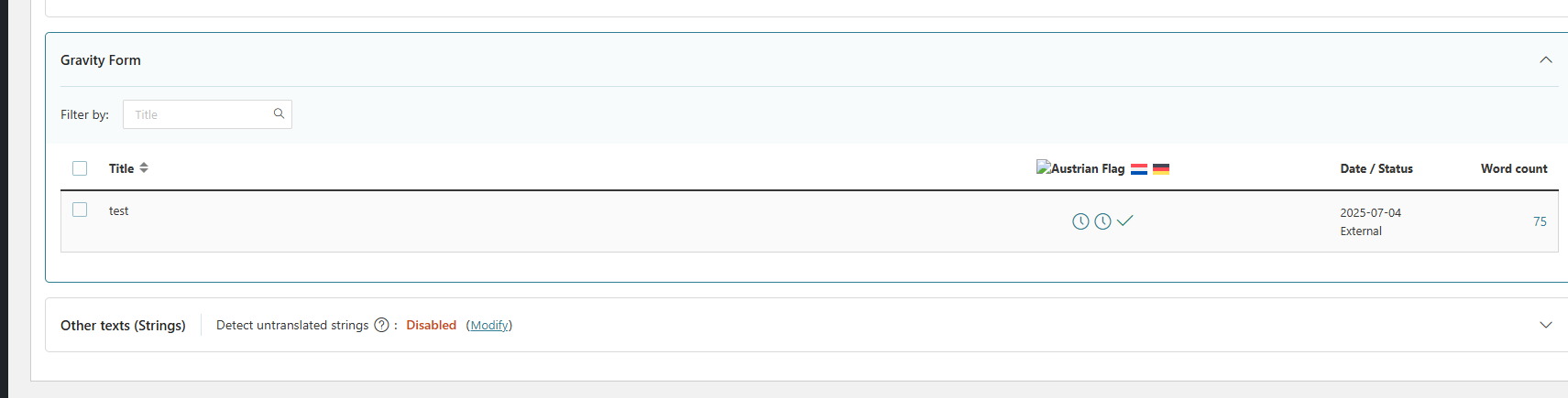

gustavoH
No, the red flag is still there. See link:
July 5, 2025 at 8:56 pm #17204294
gustavoH
I found a workaround to get the forms translated. See video: hidden link
However, we still need to figure out the original question of how to map the translated forms over to Zoho. Thanks.

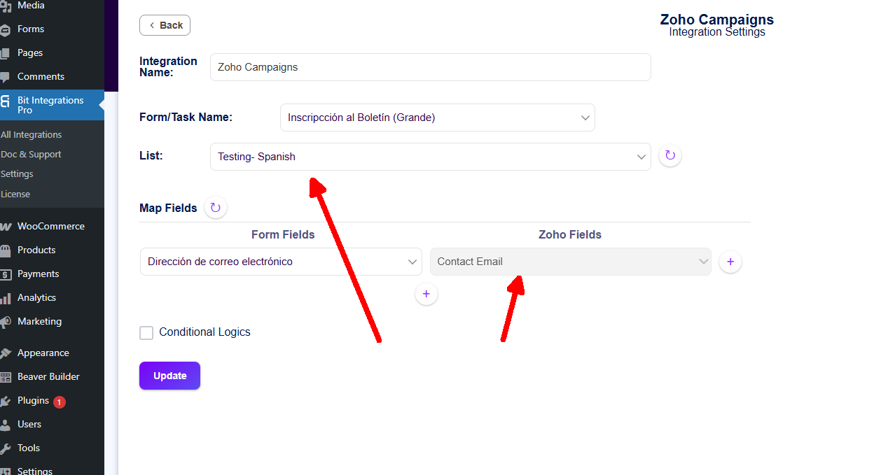

July 8, 2025 at 6:23 am #17211796
Bruno Kos
OK, so these lists and Zoho fields are not set within WordPress but come directly from the external Zoho service?
I tried to find any of these lists under String Translation > Admin Strings but couldn’t locate them. It seems they’re stored differently, and I don’t see a way to translate them from within WPML.
What if you try creating a separate form (in the site’s default language) so that you have a "translated" version created natively in the default language, and then use this method: https://wpml.org/documentation/translating-your-contents/using-different-translation-editors-for-different-pages/#how-to-use-manual-translation to manually add the form to the translated page? Let me know if that could work for you, or if you need any clarification.
Otherwise, it will likely require a custom integration developed by the Bit Integrations Pro team to fully support translated Gravity Forms with WPML.
