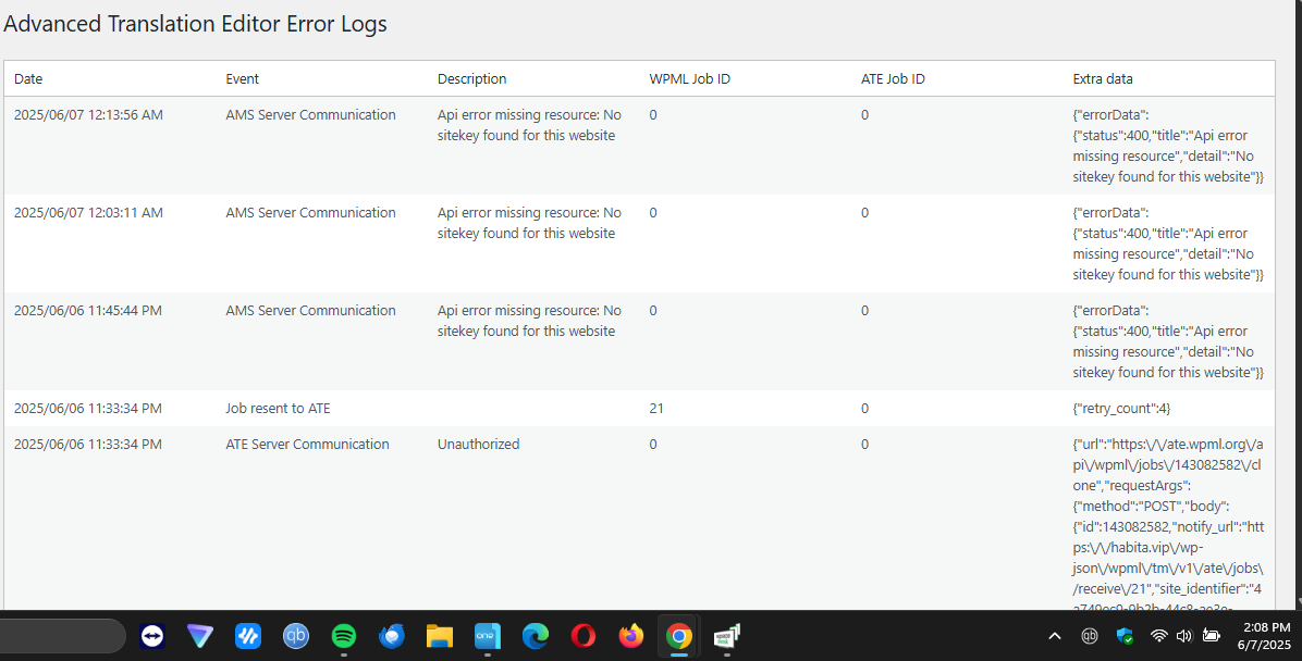

I am trying to translate a page from English (EN) to Spanish (ES) using WPML. The new page (ES) was created without any issue. To review the issue online, it might require creating a new account on the site. The issue can be seen at the following link: hidden link
I am getting a 'Bad Gateway' (nginx) error code when accessing the new page. The 'Advanced Translation Editor Error Logs' do not show any change or new log.
Why am I getting a 'Bad Gateway' error when accessing the translated page?
Why are there no new logs in the 'Advanced Translation Editor Error Logs'?

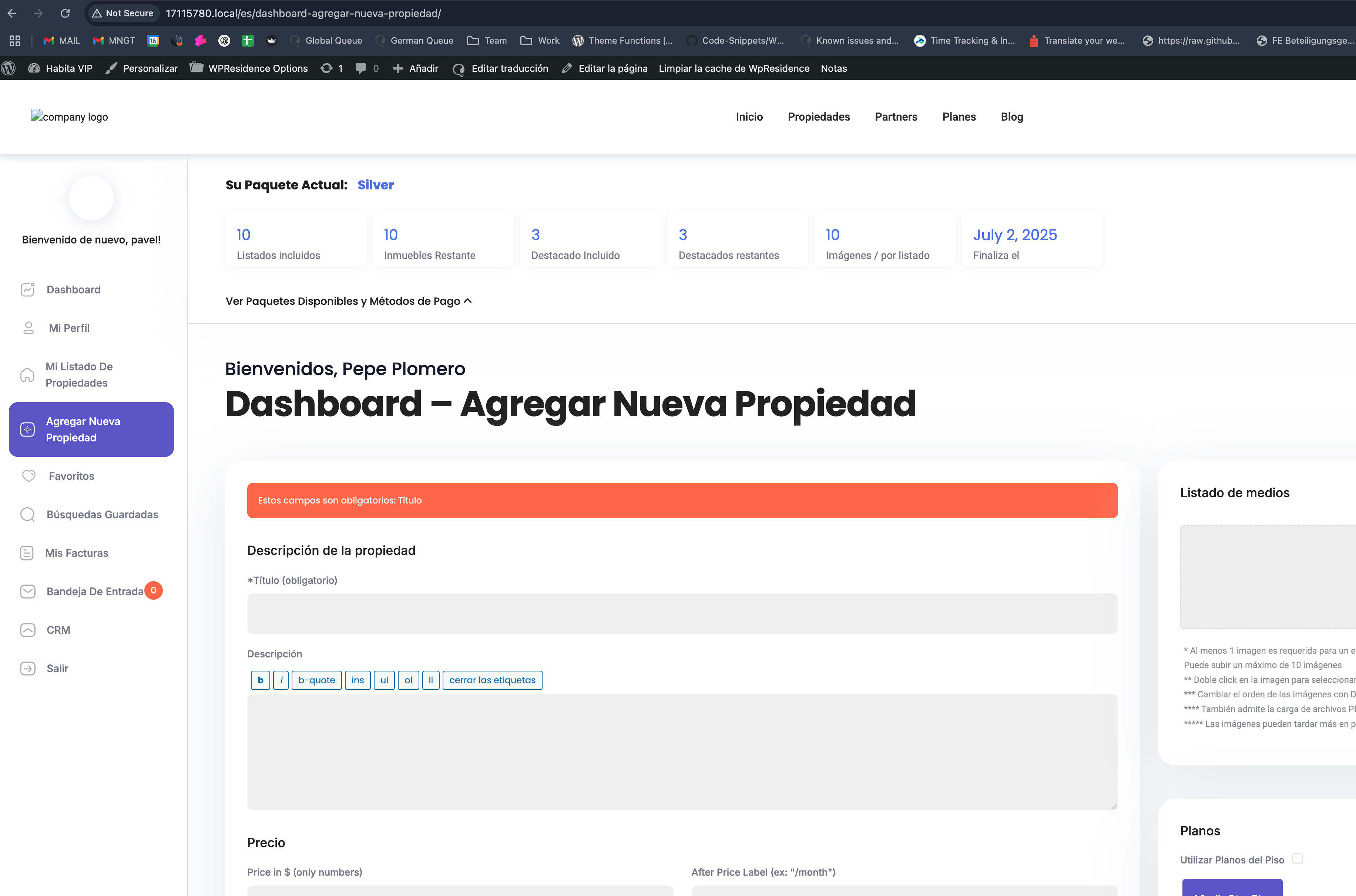

June 20, 2025 at 3:32 pm #17154786
Marcel
I deployed the site locally and didn't changed or deactivated anything - but the issue doesn't happen locally. I added you a screenshot.
Therefore, I can confirm that something related to your server settings on the production environment is causing it.
Best Regards,
Marcel
