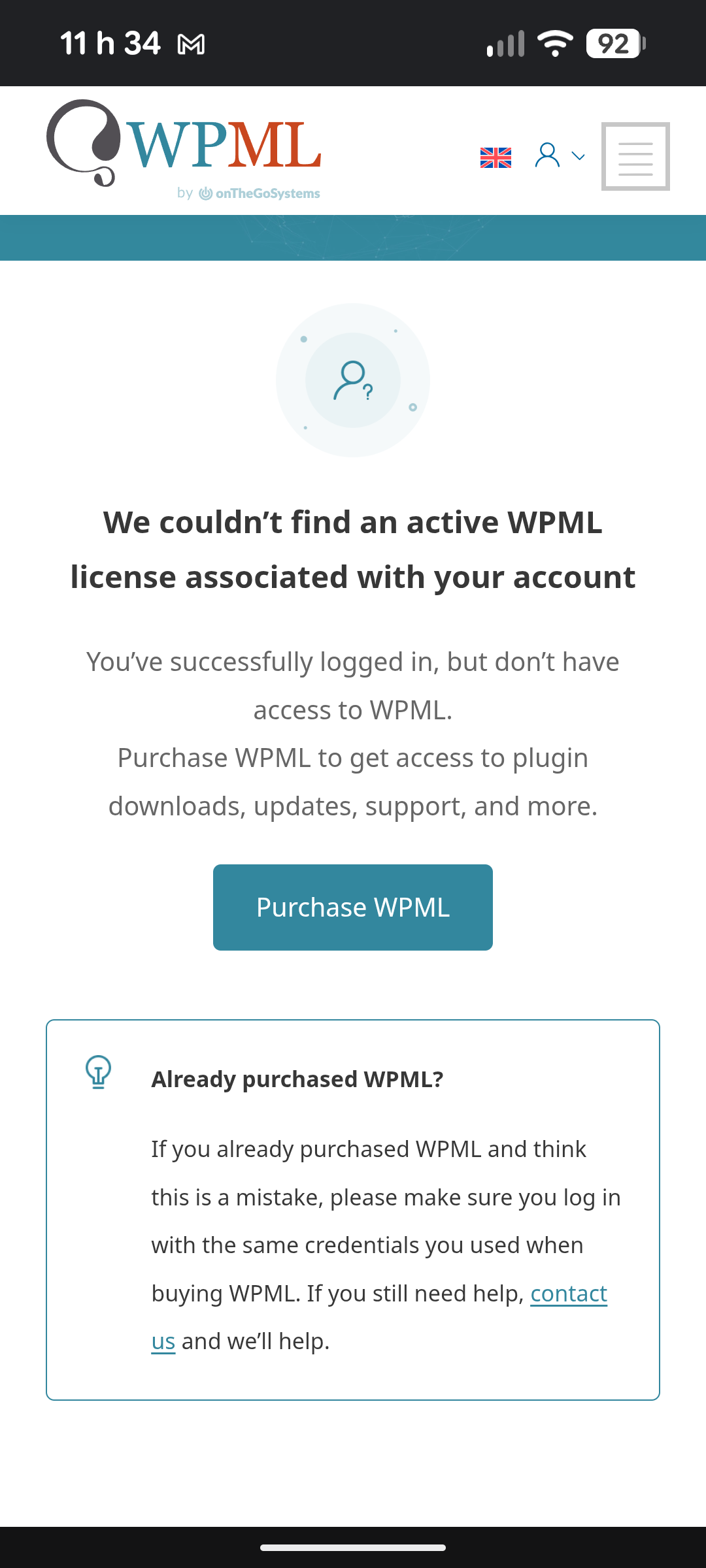

January 14, 2026 at 7:13 pm #17730965
agenceS-3
He has completed his account creation under my invitation, I provided him the link to the ticket but it seem's he can't access it (see screenshot)
Did I miss any step ?
Thanks.

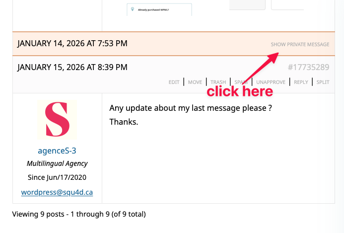

WPML Supporter since 09/2015
Timezone: America/Argentina/Buenos_Aires (GMT-03:00)
I am sorry, I replied to it yesterday.
Maybe it was missed because it's a private reply (it contains my email address).
Please check the screenshots attached.

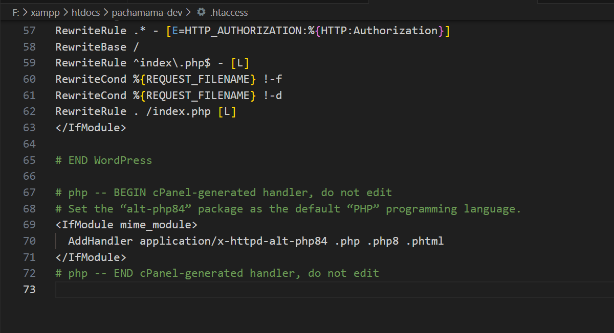

I've run many tests and I've seen that WPML breaks the admin site for the themes and plugins section, for example, deactivate all plugins and activate them one by one until you find when it breaks.
I can confirm that it is WPML Multilingual CMS plugin that fires de bug, but only when cPanel writes the following lines to the .htaccess file.
# php -- BEGIN cPanel-generated handler, do not edit
# Set the “alt-php84” package as the default “PHP” programming language.
<IfModule mime_module>
AddHandler application/x-httpd-alt-php84 .php .php8 .phtml
</IfModule>
# php -- END cPanel-generated handler, do not edit
Other writings on .htaccess do not cause the problem, for example, security plugin rules.

Dan Her
Sorry, I forgot to mention that the problem disappears if I create a new .htaccess file to replace the one written by cPanel. The site will work correctly until the next time the server routine writes to the file (twice a week).
January 17, 2026 at 7:18 pm #17739402

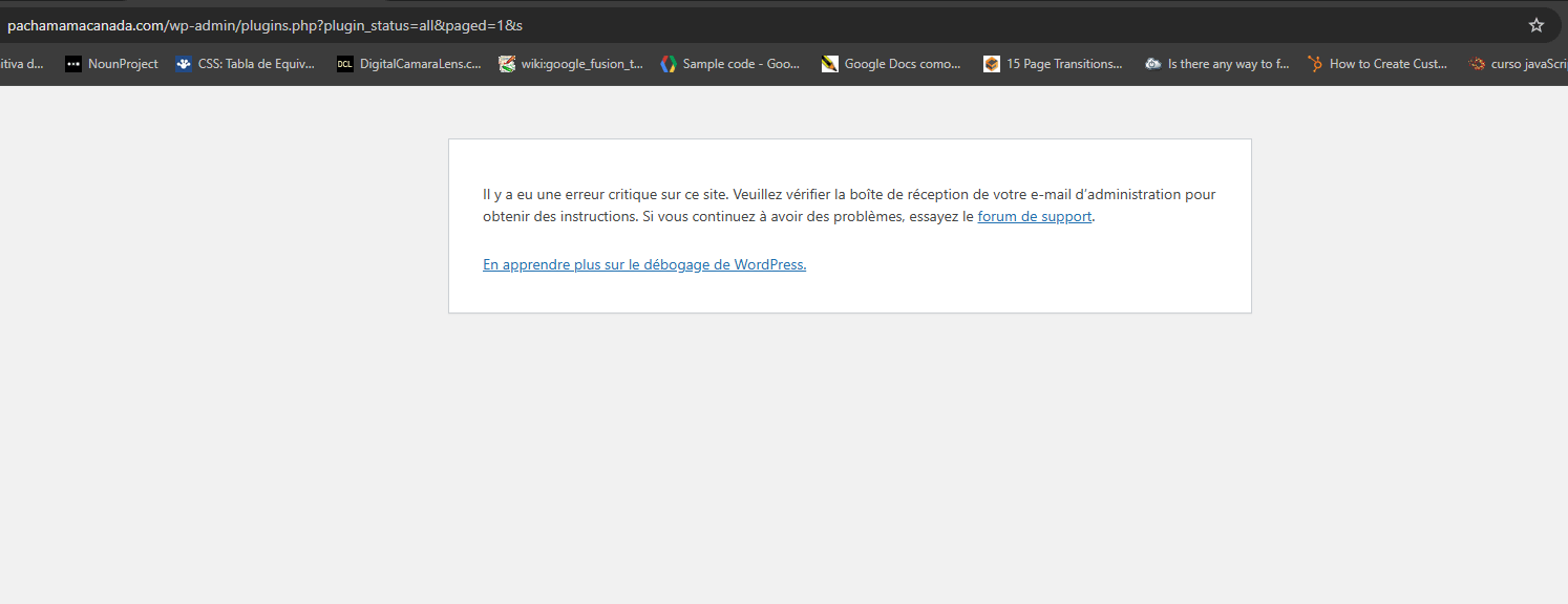

Dan Her
here the screen shots of htaccess and the wp error page
