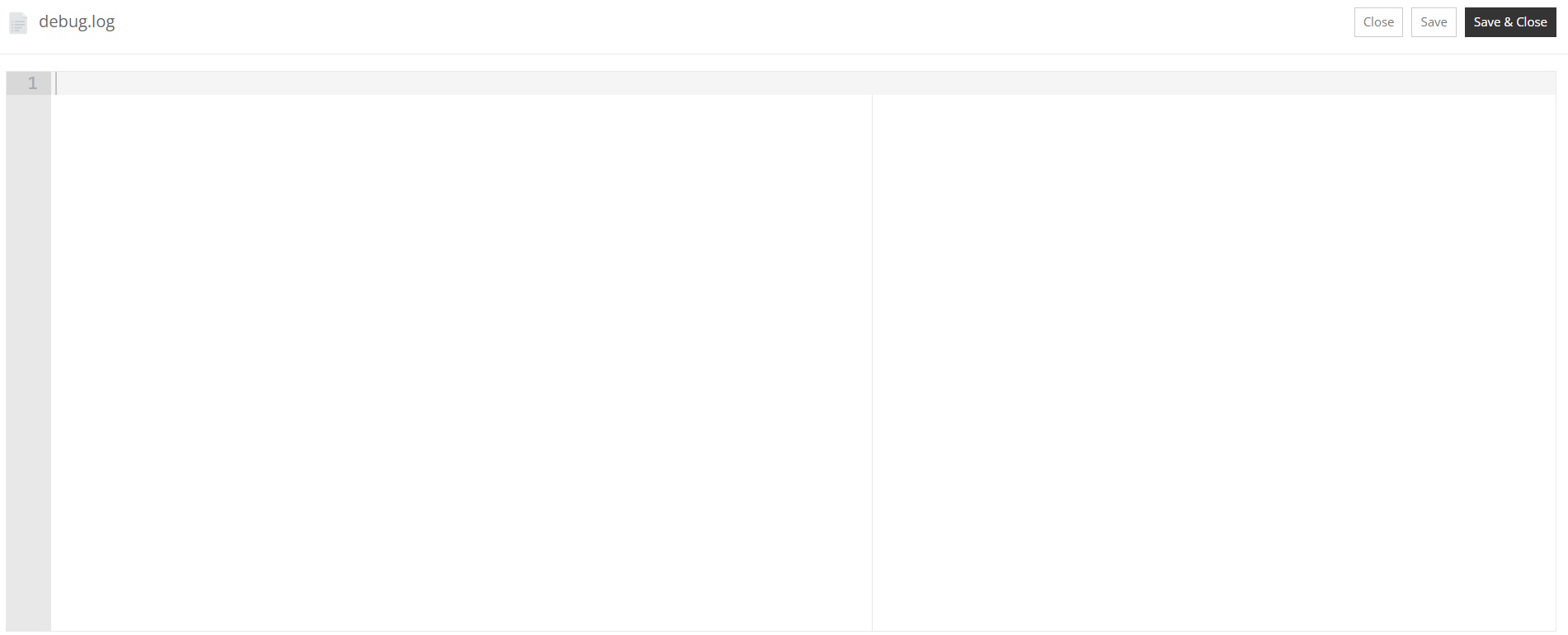

August 30, 2024 at 5:00 am #16122799
taivoJ
Hello, debug log is empty
