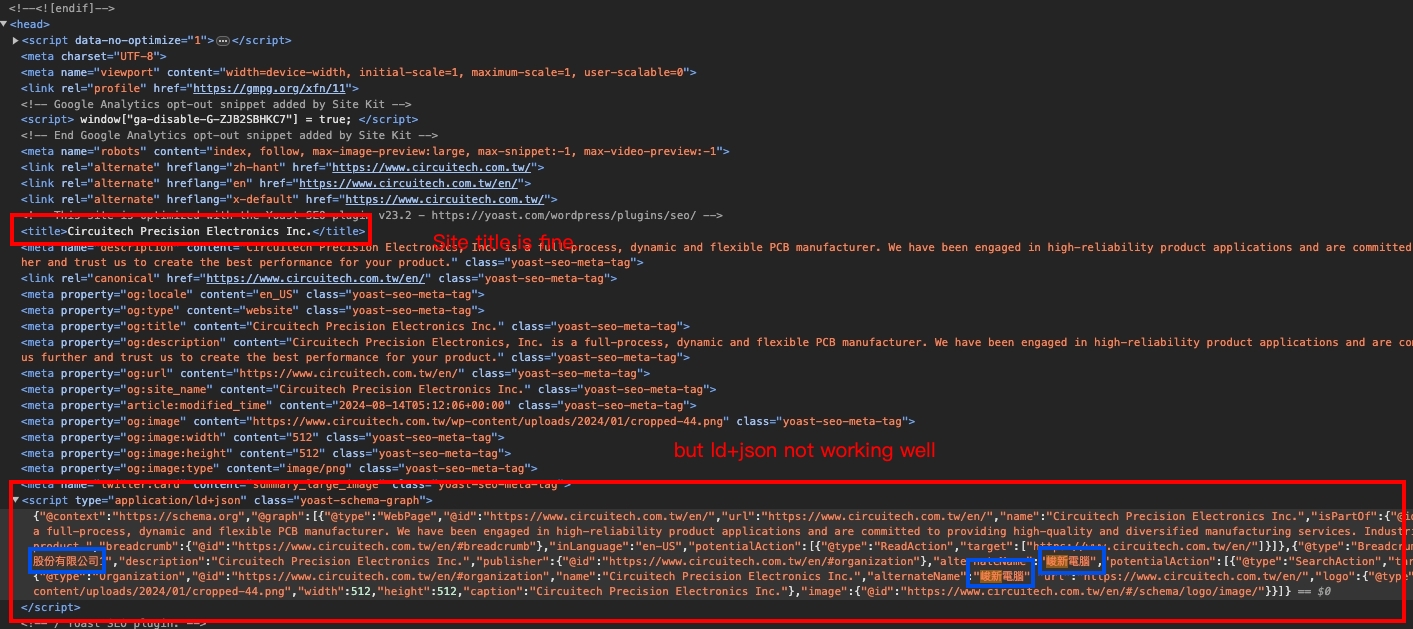

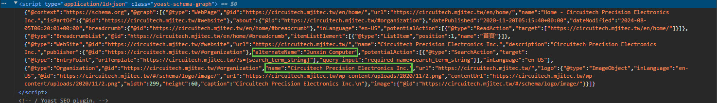

I am trying to translate strings in the admin_texts_wpseo_titles section using WPML String Translation on my website hidden link, which uses Yoast SEO and WPML.
The translation of strings in admin_texts_wpseo_titles using WPML String Translation does not work.
Why doesn't the WPML String Translation work for strings in admin_texts_wpseo_titles?

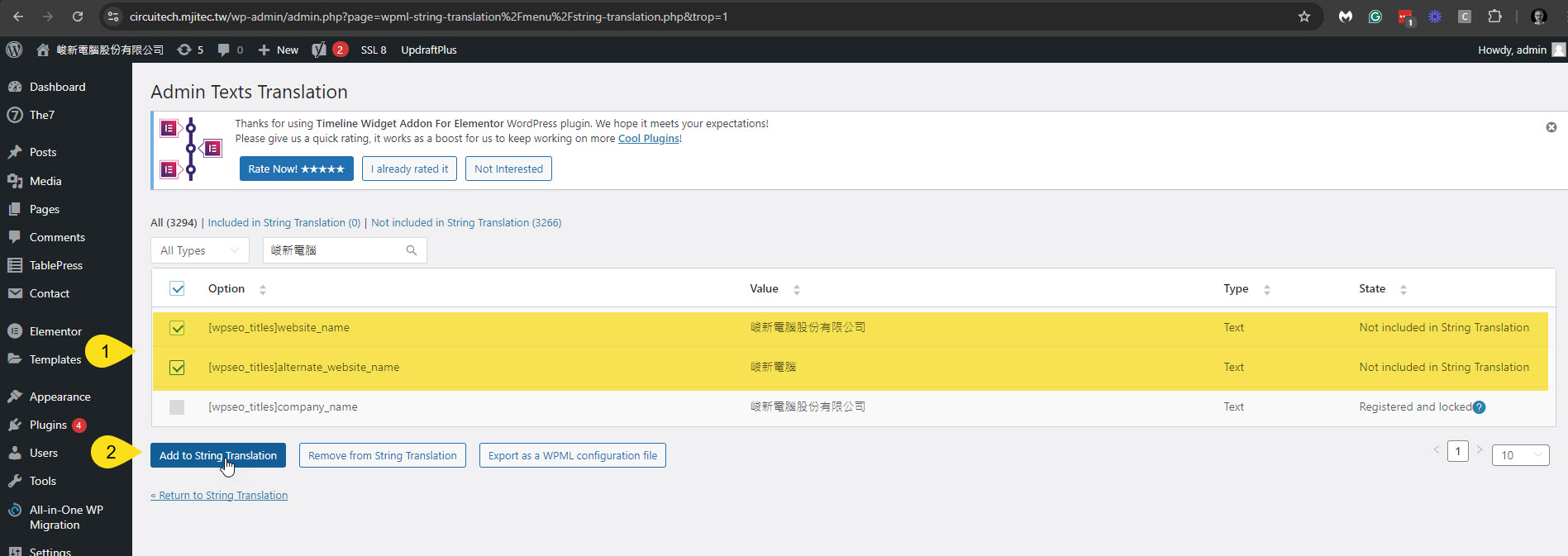

I could solve this issue on your site. Here is what I have done.
1. I went to WPML -> Strings Translation -> Translate texts in admin screens.
2. I searched for 峻新電腦.
3. Two results were not added to Strings Translation, so I added them. Please see the attached screenshot add-to-st.jpg.

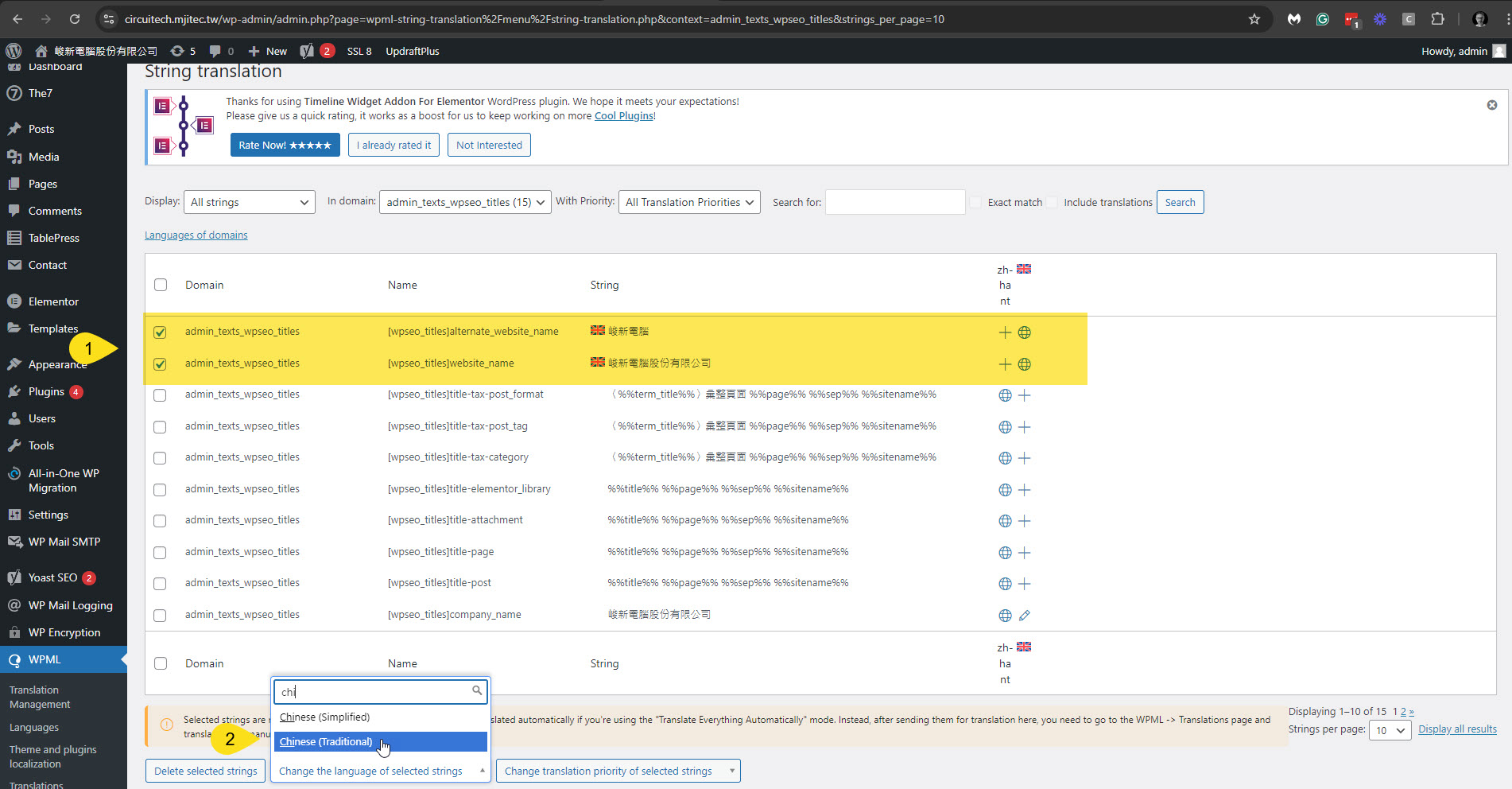

4. I changed their language from English to Chinese in Strings Translation. Please see the attached screenshot chng-lang.jpg.
5. I translated those strings.
6. Now, it is shown translated in the script. Please see the attached screenshot script-ok.jpg.
You can repeat the same process for any other strings you need to translate.
Can you please confirm that the issue is solved now?

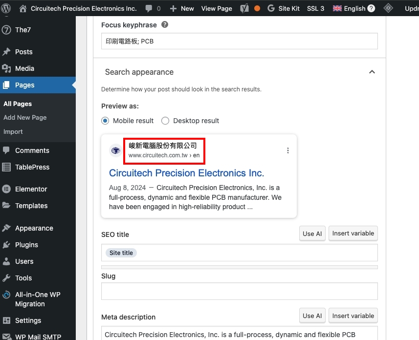

Thank you for your assistance. I have another question: why isn't the preview of my backend SEO settings translating correctly?
August 15, 2024 at 9:56 am #16073824
Itamar
WPML Supporter since 02/2016
Languages: Hebrew (עברית )
In our technical support forum, we focus on one issue per ticket. Otherwise, tickets can get cluttered and confusing for users and supporters.
Please open a new ticket with the last issue you mentioned.
