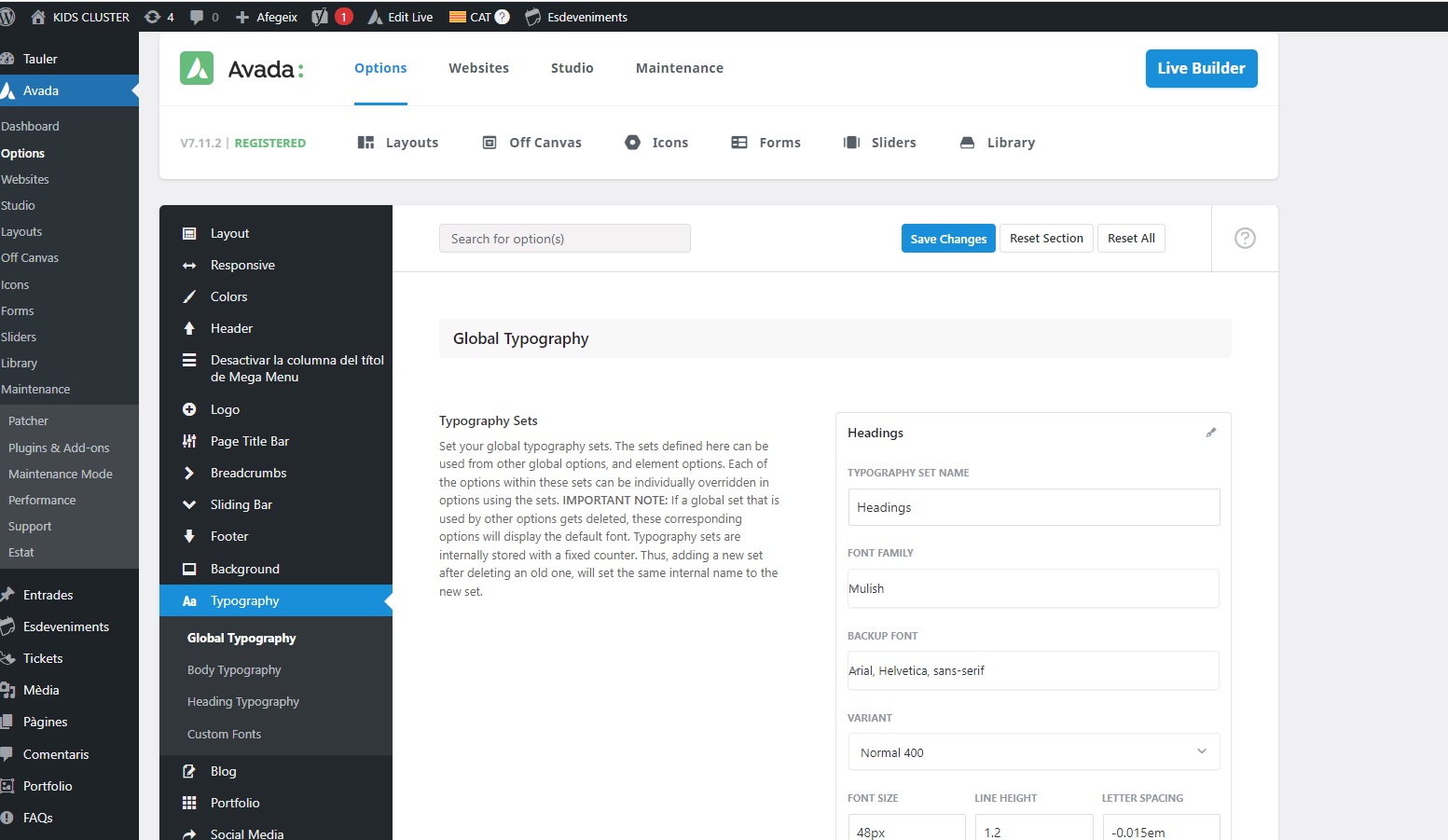

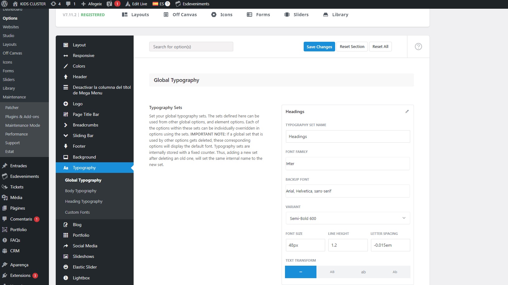

I'm working on Avada theme + WPML. I'd like to keep the settings for the main language (typography, logos) without having to set all these elements again for the other two languages. Is it possible?
I've uploaded a couple of screenshots to clarify my question. WPML-cat shows the main configuration (exemple: the right typography). WPML-ES shows that is not showing the right typography but the default one.
Is there a way to clone the main language settings to the secondary languages? Otherwise I have to set colors, logos, rollover styles and so on.

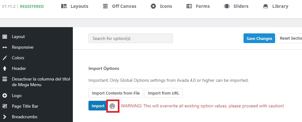

jaumeP-3
Looks like a great solution, thank you. I tried it, but it does not seem to work. The process goes on an on -> screenshot attached, see the red square. The circle inside it's been turning and turning for mores than 15 minutes now...

It seems you encountered a fatal error, and the process is stuck.
You need to enable debug.log. You can do this by adding a few lines to the site’s wp-config.php file. With error log enabled, you will see what the actual problem is.
To enable it, open your wp-config.php file and look for define(‘WP_DEBUG’, false);. Change it to:
define('WP_DEBUG', true);
In order to enable the error logging to a file on the server you need to add yet one more similar line:
In this case, the errors will be saved to a debug.log log file inside the /wp-content/directory.
https://wpml.org/documentation/support/debugging-wpml/
Let me know what you see after the debug mode has been enabled and you try to import again.
