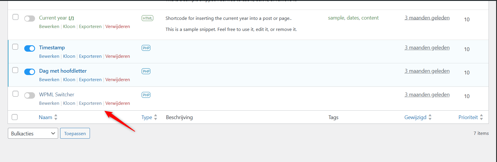

Thank you for the updates. Please try the following steps on the live site:
- Disable the WPML Switcher snippet
- Clear all types of caches (server, browser, plugin, etc.)
- Visit Settings >> Permalinks, and resave the settings.
After that, check whether the issue still exists. Refer to the attached image for more details.
Thanks!
Bigul
