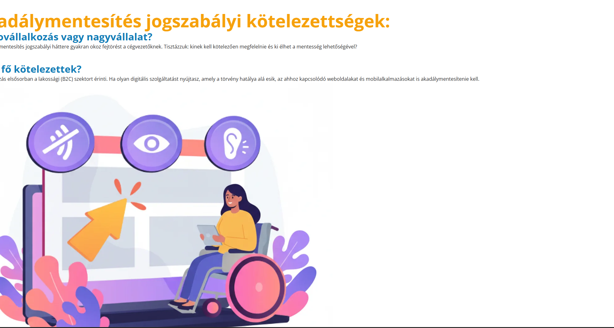

I have attached two additional screenshots showing that while the hover issue might have disappeared after your manual update, new layout errors have emerged.
This proves that even after translating the same content for the third time, the rendered output remains inconsistent and buggy.

I have just tested the page with the new **custom_field** settings, and unfortunately, **it still does not work properly.** On the first translation attempt, the design completely broke (please see the attached screenshot). It only rendered correctly after the second translation.
Regarding your point #3 ("As long as retranslating the content solves the issue, we can not confirm any bug"): **This position is untenable.**
It is unacceptable that the first translation attempt destroys the page design, especially when sometimes even a third or fourth attempt fails to fix it. This is the definition of **unreliable software behavior.** I am asking you to acknowledge a basic requirement: **WPML must generate the translated page flawlessly on the first click.**
