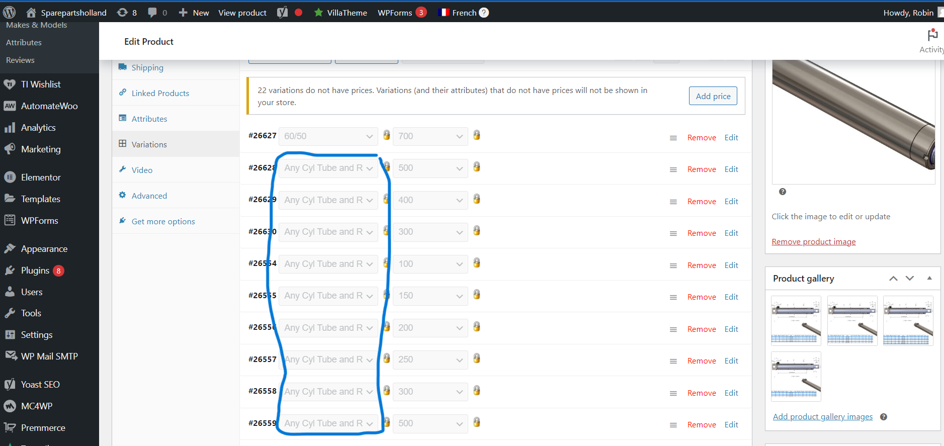

I see that the dutch variants are correct now and the attributes were already correctly copied, but the variations of the french product are not copied correctly yet. The variations are the main problem that they are not copied and that the attribute value of the variation is empty or not set. Could you look at the french product and see if this is still the case. i have attached an image to see what i mean.
May 26, 2023 at 4:25 am #13719659

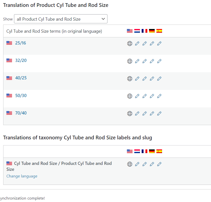

Thanks for the instructions. I have checked accordingly and have been able to trace the issue. It seems the issue happened due to not synchronizing the variations. From the "WooCommerce > WooCommerce Multilingual > Attributes" tab, I made sure that the translation for the Attributes are added correctly and then synchronize the Attributes(Screenshot: hidden link)
By doing so, the variations in the French products started to show properly. Please check this screenshot(hidden link) for a better understanding.
If you ever face this issue in the future, then please make sure to synchronize the attributes first and additionally, synchronize the variations from the WCML Troubleshooter page. The steps to synchronize variations from the troubleshooter are mentioned in my previous response(https://wpml.org/forums/topic/lock-icon-on-the-variations/#post-13712399).

- Synchronize the Attribute from "WooCommerce > WooCommerce Multilingual > Attributes" tab(Screenshot: hidden link)

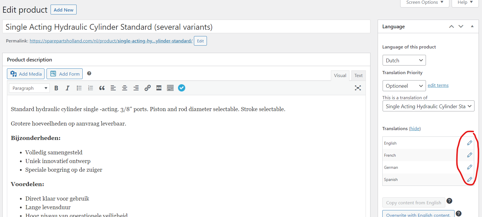

I have translated the product completely, as shown in the images, or are there more places where i can check if the product is fully translated?
The attributes are synchronized and i have synchronised the relationships.
But this didn't help either.

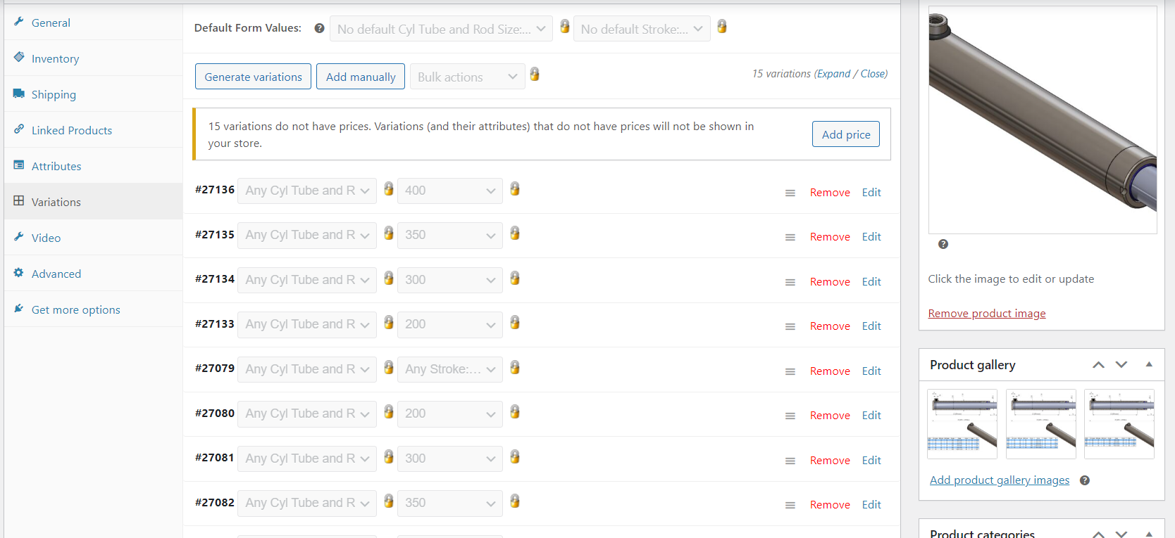

Thanks for sharing the product where the issue persists. After thoroughly checking the product, I found something interesting.
The Attributes that have been added to the specific product are custom Attributes, and the variations have been generated based on the values of these custom Attributes. It is indeed possible to translate the custom Attribute values using WPML and correctly display the variations in other languages.
But during the investigation, I found that the custom values are somehow been deselected from the variation in default languages. Upon selecting the values, saving the product, and updating the translation, the variation starts to show properly in other languages. Kindly check this video(hidden link) for a better understanding.
It is possible that the Attribute value was modified at some point, but it was not subsequently selected for the variation or the variations were not saved properly. This could be the possible reason behind the problem.
If you notice the same issue in other products, first of all, make sure that the variation is added correctly in the default language. After that, save the variation and the product and then update the Translation. I hope it will help.
