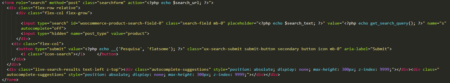

Your solution isn't working. The search bar is native from the theme, at my case Flatsome Theme (exemple: hidden link). you can see in the image attached my code for that search form.
Thanks.

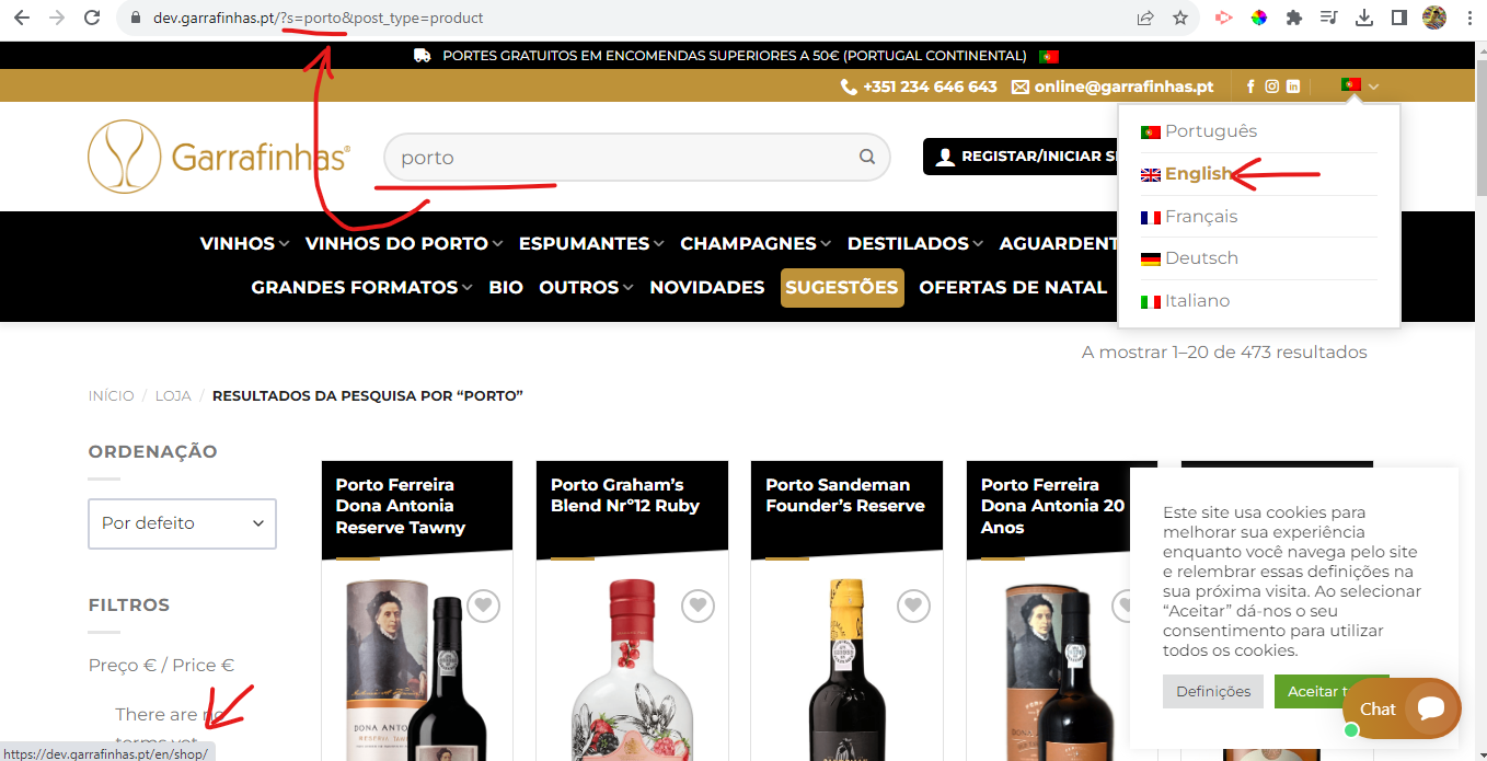

Yes. The poblem is exactly what describe in the video, but with one correction... The URL don't change because the form is in POST method and not because it is AJAX. I've changed the form now to the GET method. Please, redo the same search you have done before and you will see the URL changing getting the "s" variable with the term searched (image attached). And after that, when I go to the English the search goes empty and not with the term searched.
Thanks.

2. WPML's Preserve URL arguments option in WPML -> Languages -> Language Switcher Option does work. I inserted the following arguments, and the arguments are preserved when the language is switched.
s, post_type
I recorded a video (4 minutes) to show you my findings. Please watch it here.

The code is based in original theme files as same the child theme that don't also have that files/directories you describe! Anyway... I've added the same arguments in "Preserve URL arguments" option that you have described in video and it works fine.
Thanks.
