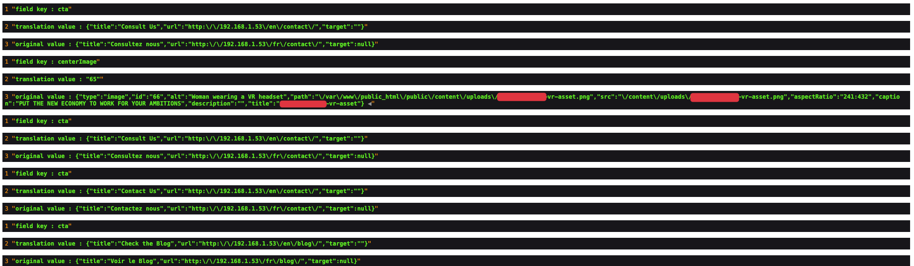

I'm using wordpress with a frontend framework, which means I need to give it json data instead of using wordpress functions inside a .php template file.
While using ACF with WPML I faced two problems : `get_fields($translation_id)` returns false, which means I have to get all fields keys and use get_field($key, $translation_id) on them to get the data (which is a pain honestly.)
This workaround works well for every field EXCEPT for the medias.
As you can see in the attached screenshot, for each fields, get_field() returns the expected field translations AND the field original values are not translated.

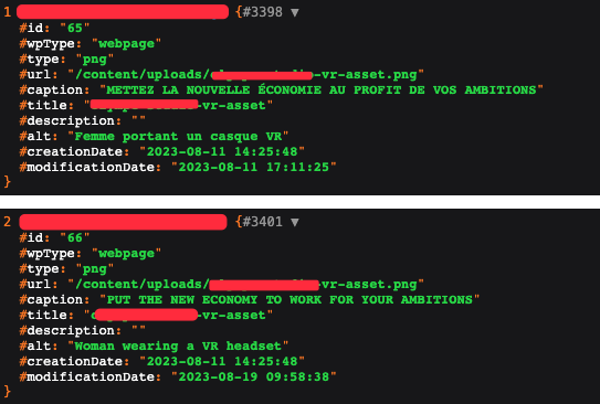

In this exemple, 65 is the ID of the original Image, while 66 is the translated one (see second screenshot)
In the case of Medias, Original fields are translated AND get_field() doesn't trigger the 'acf/format_value/type=image' filter, which make it impossible to format the value.
