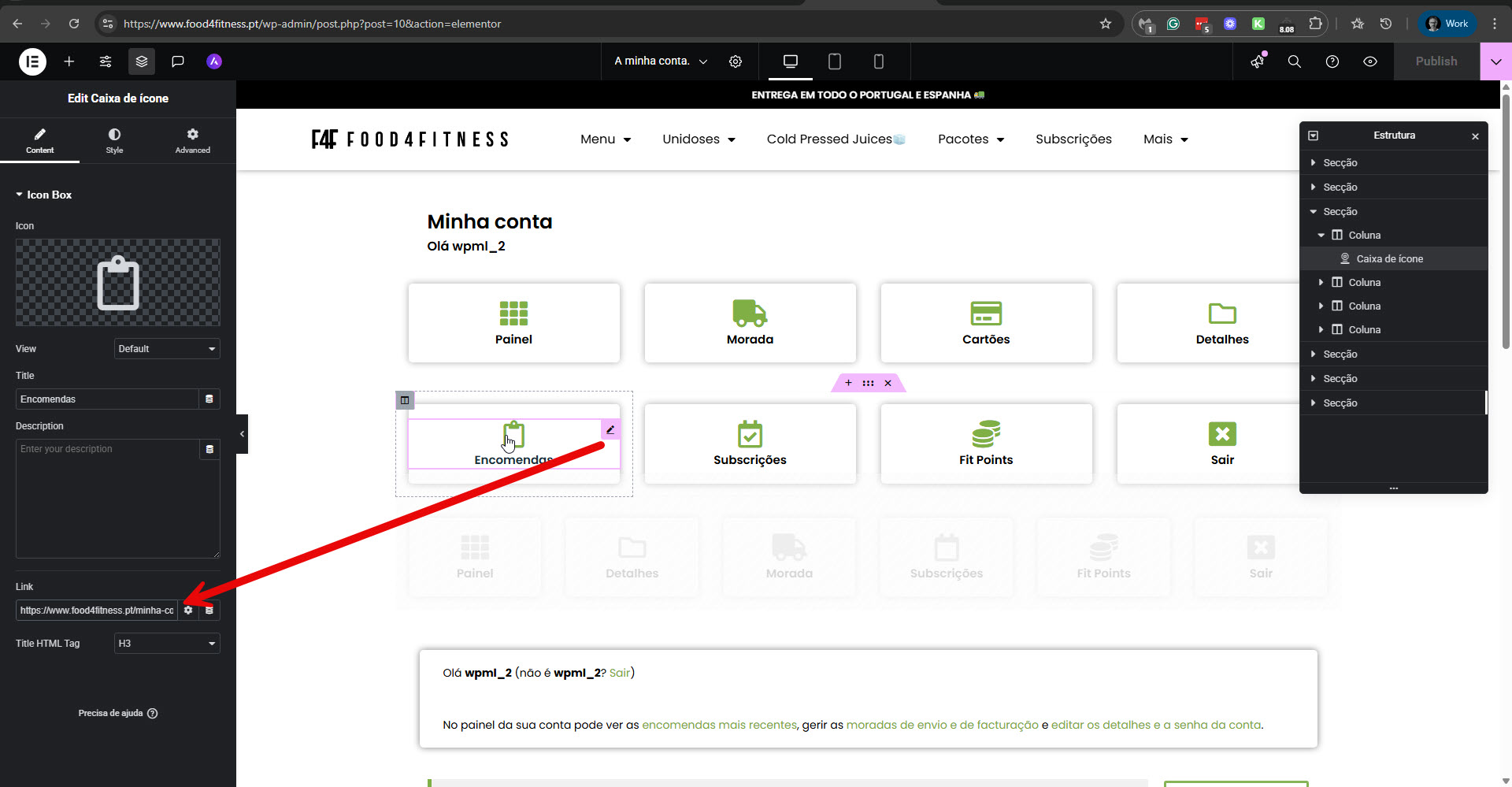

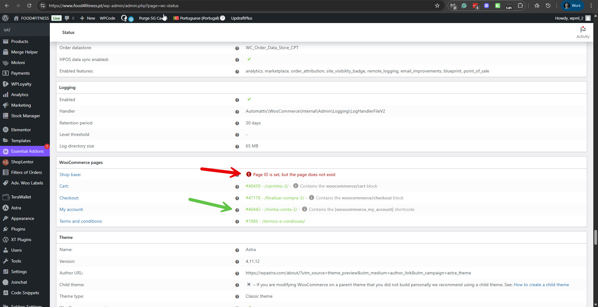

The problem is that you are not working on WooCommerce's My Account page. It appears that you have created a separate Elementor page. However, the links in it are not directed to the WooCommerce My Account page or its subpages. The original WooCommerce My Account page can be seen here: hidden link. It is working, including all its subpages, such as hidden link. And it is also working fine in English: hidden link.
If you go to WooCommerce -> Status, you will be able to see the correct slug for the My Account page. You will also be able to see that you have a problem with the Shop page. Please see the attached screenshot, wc-status.jpg. It appears that you have a problem with WooCommerce that is unrelated to WPML.
The problem is with the links you inserted in the Caixa de icon elements. They are not leading to the correct WooCommerce My Account pages. Please see the attached screenshot elm-links.jpg.
The solution would probably be to fix those links or recreate the Elementor page on top of the original WooCommerce My Account page.
