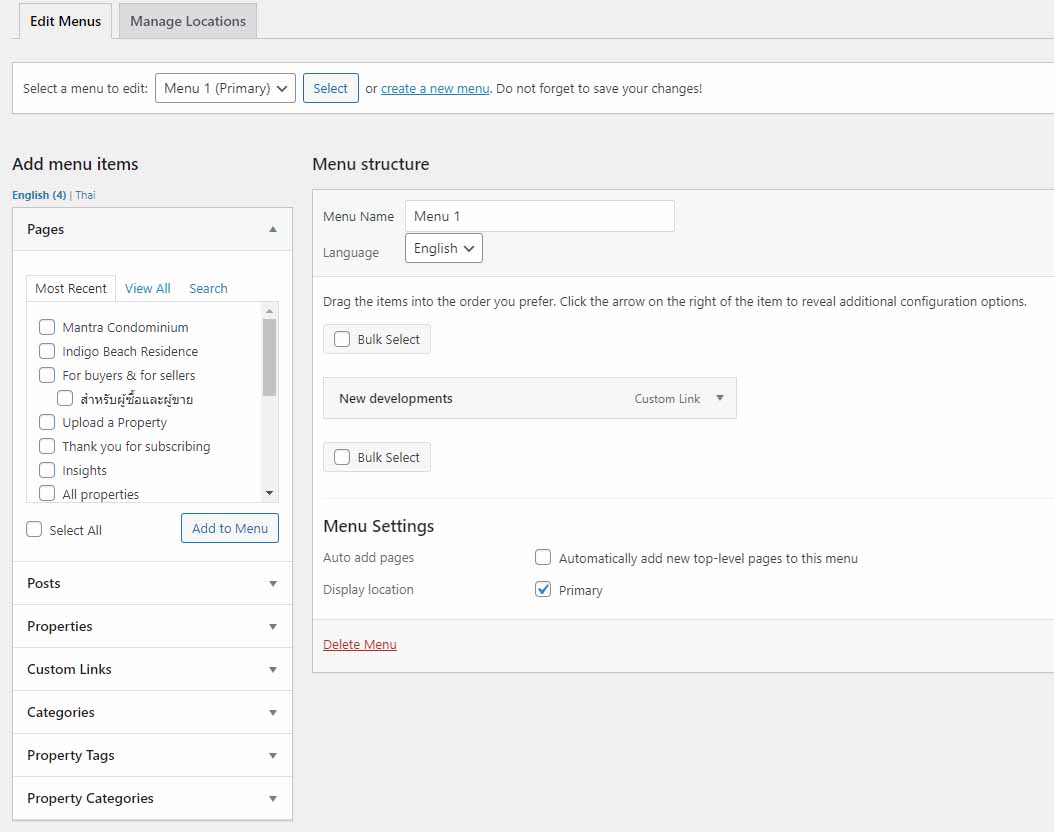

I'm using the Real Estate Manager Pro.
Installed WPML, translated the property pages. So far, so good.
But after that my Main menu disappeard, only one item left. And I can't add new menu items anymore.
I've deactived all the plugins, problem still excists.
Theme: WP Bootstrap 4
It's a production website, need to go live tomorrow.

hansH-19
Hello Kor,
Still need assistance. I've just installed WPML at 999-realestate.com, translated English into Thai, so far so good, all worked well. Except the menu, both menu's were empty and I couldn't add new menu items to it.
I'm afraid your help is needed

July 8, 2023 at 1:16 am #13970693
hansH-19
Hi Kor, first of all thanks again for the support.
Website: hidden link
I've just installed WPML again at the production website (CMS and String). I did a translation into Thai, automatic for all pages.
So far so good, even a Thai menu on the webpage, thereafter I synced them.
The English menu at the webpage now had page titles as menu items.
For instance: 'Find your dream home in Thailand' instead of 'Home' which I changed in the navigation label.
The moment I change it back to 'Home', all menu items are disappeared except 'New developments' which is custom link. I can't add more items to menu.
In 'Dashboard' menus their is no Thai menu to be found.
I hope I made myself clear, English is not my native language 🙂
BTW is there a way to exclude menu's from translation? Maybe that's is an option?
BR Hans
