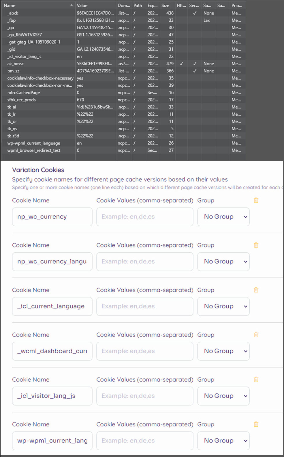

I have checked the cookies on the website and can't see them:
[image uploded]
Those are all cookies without NitroPack, the website loaded from Sweden and the currency was changed to kr. I can't see which one is the one responsible for the currency change.
I have also added all those cookies as variation cookies just in case. Here are all cookies that are added as variation cookies at the moemnt:
[image uploded]

In NitroPack i can add "variation cookies". They causes them to create different cached version of the page depending of the content of that cookie.
I added your code, and added that cookie in NitroPack as a variation cookie and that seems to have solved the issue.
