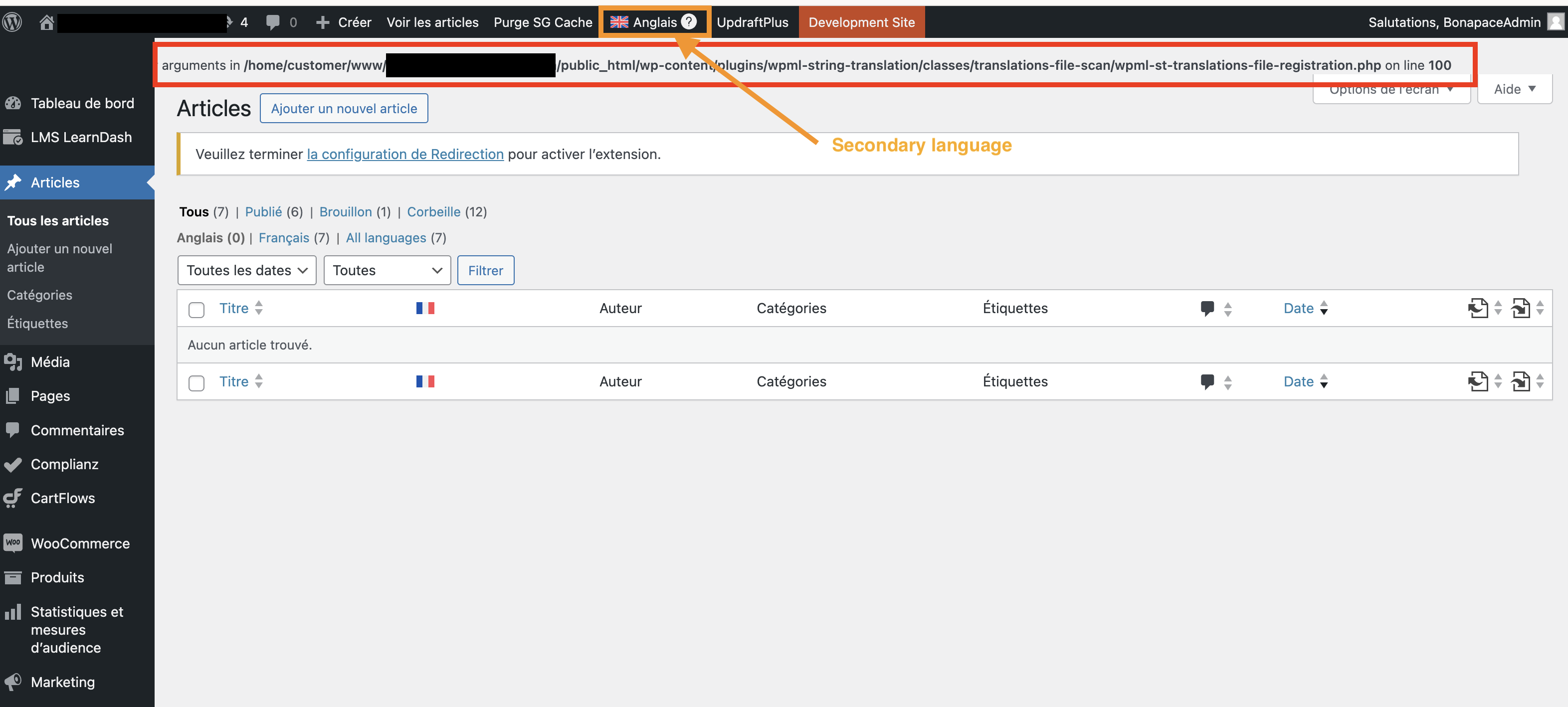

February 7, 2024 at 8:11 am #15274904
malikaB-2
The error message only shows on the backend, when viewing any admin page in the secondary language. The frontend for both languages works as it should.
The primary language is French Canadian, and secondary language English.
I don't know if it makes a difference but on my site, the pages are not translated using the translation editor, but are duplicated in the wordpress editor as the page content / layout is not the same in english and french.
So to edit the page / article / product in the secondary language (english) I have to access the admin in the english version and this is when the php error occurs.
