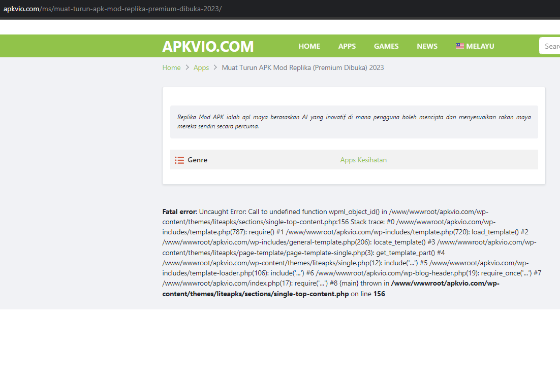

wheni user
$current_post_id = get_the_ID(); // Get the current post ID
$original_post_id = wpml_object_id($current_post_id, 'post', false, 'original'); // Replace 'post_type_name' with your post type
echo $original_post_id; // getting orignal post id
Fatal error: Uncaught Error: Call to undefined function wpml_object_id()
September 12, 2023 at 4:23 pm #14385393
Bruno Kos
You need to use these through filters, following the code as on https://wpml.org/wpml-hook/wpml_object_id/.
I can't code this for you, this is outside of the support scope.
Please consult our https://wpml.org/contractors/ for further help on how to use these functions.
