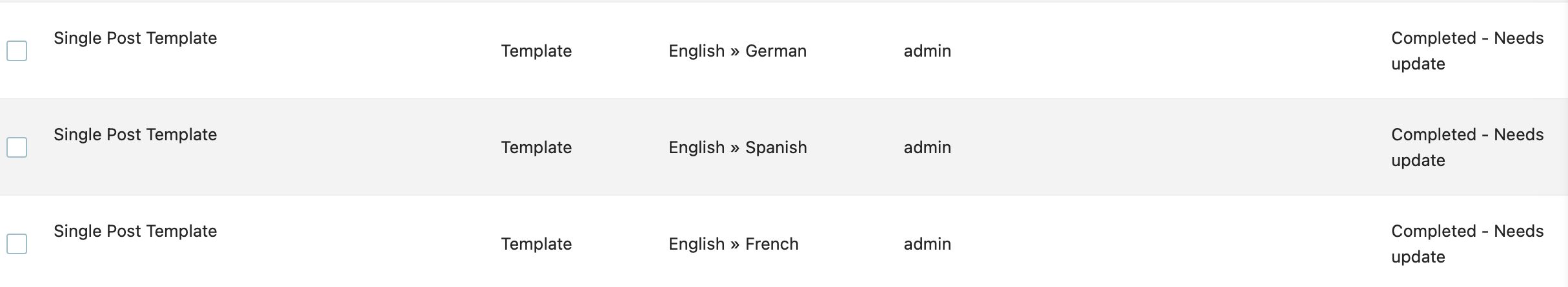

Thank you for pointing me to that documentation. However, when I go to WPML > Translation Management > Templates, none of my templates appear. However, under WPML > Translation Management > Jobs, the single post templates do appear and are marked as “Completed – Needs update.” A screenshot of that is attached. As with any other translation, the "needs update" should not prevent the translation from showing.
Because the second issue persists (ie, the single post template is not showing the correct language in the non-body portions), and in light of what I mentioned above, how can I resolve this issue?

If your templates are fully translated, the "needs update" status should not interfere with the display of translations on the frontend. However, when translating templates via the WPML Translation Editor, it's crucial to have the String Translation plugin activated, as without it, translations won't show up on the frontend.
I want to reassure you that there are currently no known issues with the String Translation plugin in a multisite setup. The plugin has received multiple updates and functions seamlessly in a multisite environment.
Now that you've switched to a Single site setup, please ensure to install the String Translation plugin, but remember to back up your site fully first. After installation, try the following steps:
1. Access the default single post template in the WordPress Editor.
2. Make a minor modification in the title and save your changes.
3. Within the editor's language meta section, look for an update icon (see this screenshot for reference: hidden link). Click on this icon to update the translation.
Let me know how it goes. I will be happy to help if you need further assistance in this matter.
