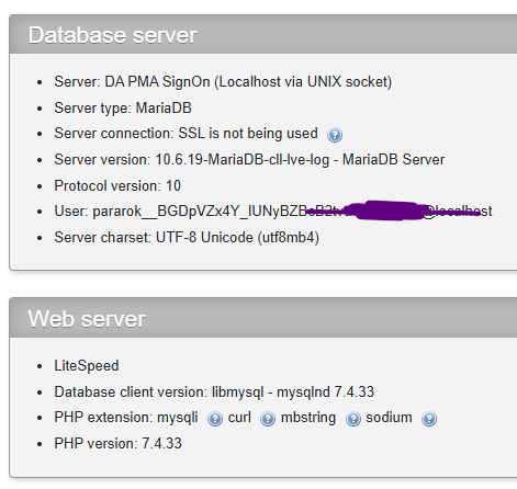

gregaV-2
Dabug information says the sql version is not as recommended. I do not understand why. The SQL server info is in the uploaded file.

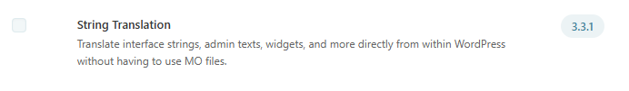

gregaV-2
String translation plugin was istalled (version 3.3.1).
I have deleted the plugin and tried reinstalling, but it did not helped.
