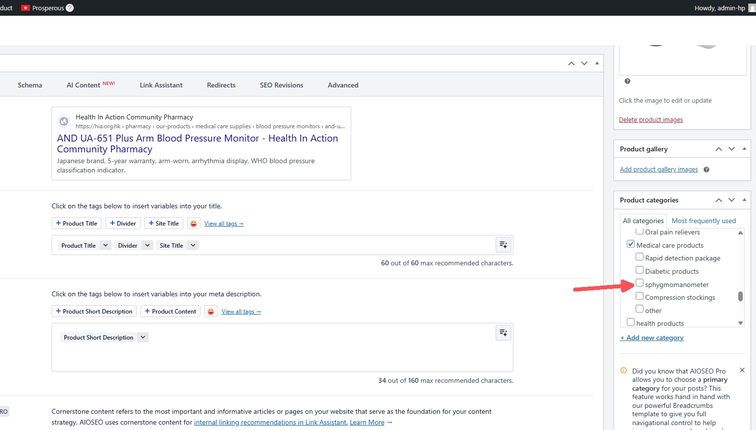

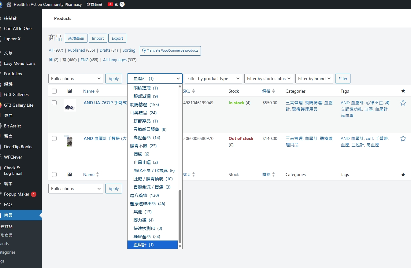

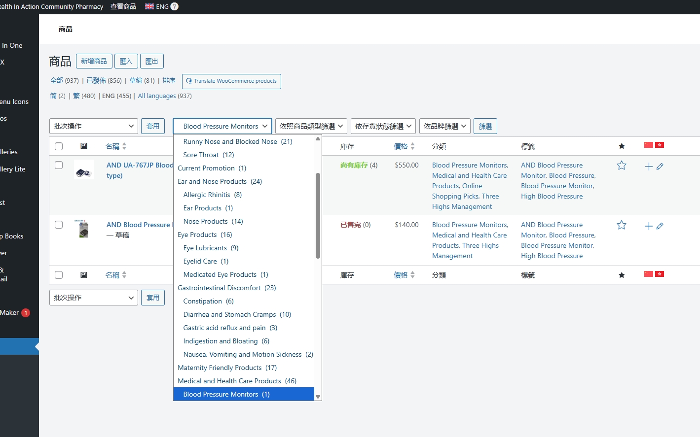

Yes, i did it.
If i add product to other existing category and remove the product form the category, which is fine the category count(sync).
But when i add a new category, category count will not sync.
I have try to edit product to select the new category & un-select the category from edit product.(no sync)
Also i have try to use quick edit product to select the new category, edit product to un-select the category.(no sync)
Same problem.
