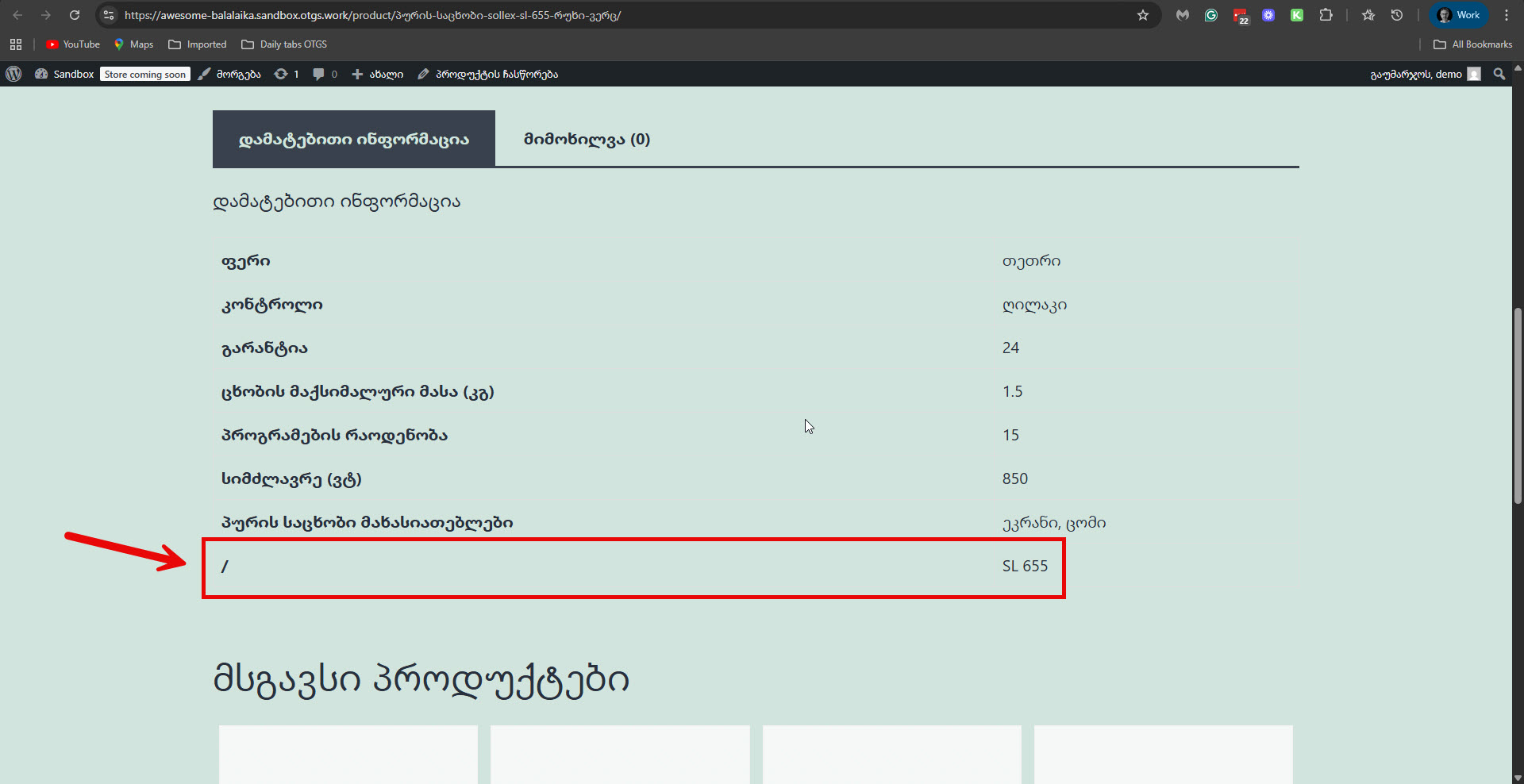

A. This attribute was not even imported correctly in Georgian. Only the forward slash (/) is there. Please see the attached screenshot forward-slash.jpg. It might be that it is not possible to include this sign in an attribute label. (This is just an assumption from my side.) So, not being imported into Georgia can be the root of the problem.

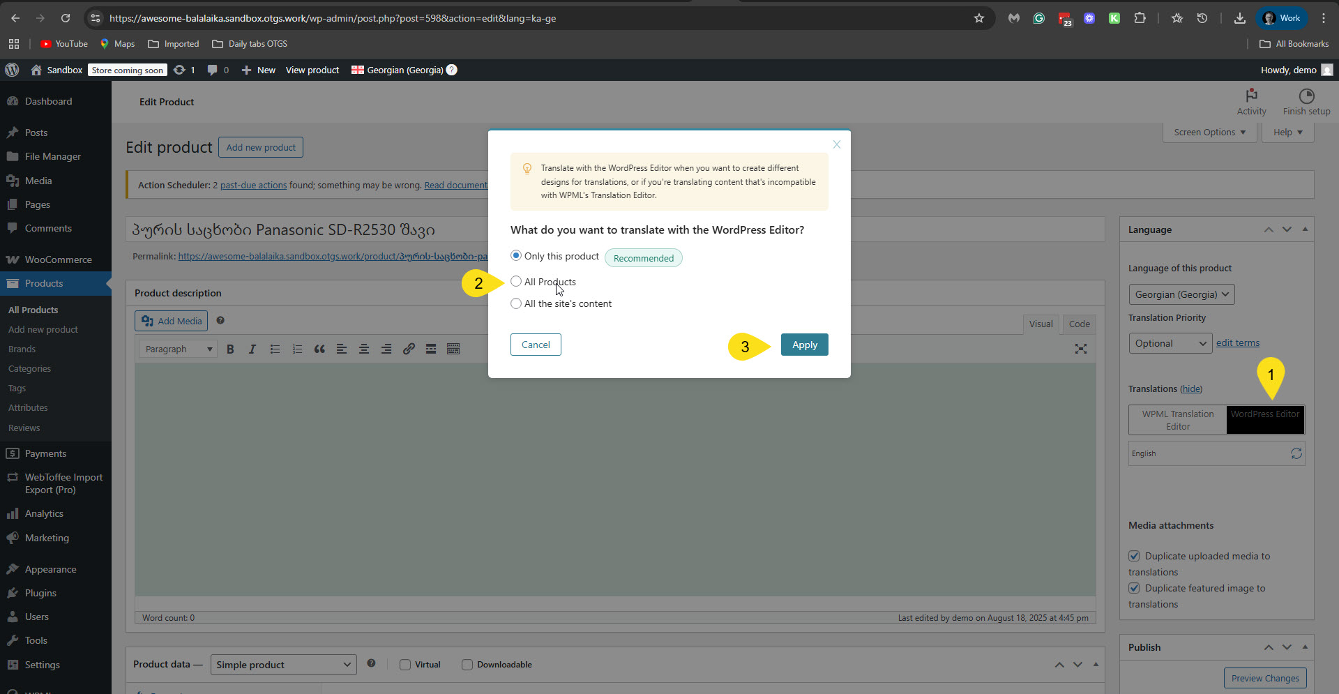

In light of this, I suggest you try again when the Advanced Translation Editor is canceled. In other words, although it is less convenient, don't work with the Advanced Translation Editor for products that you imported with the Product Import Export for WooCommerce Add-on plugin. You cancel it in the editing screen of each product. You can cancel it for a specific product or all products. Please see the attached screenshot. Then make a new import and check what happens in this case.
