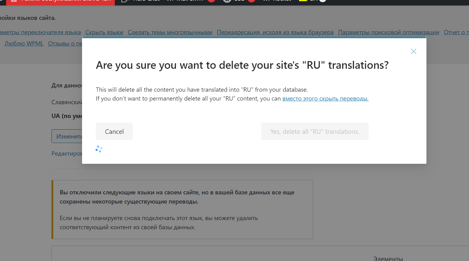

Hi there. I'm trying to delete the second language from the website according your guide https://wpml.org/faq/how-to-completely-remove-a-language-from-your-site/
But I'm waiting more than one hour and I still see that deletion is in process. I do not have much files or pages there.
Is it normal or something goes wrong?

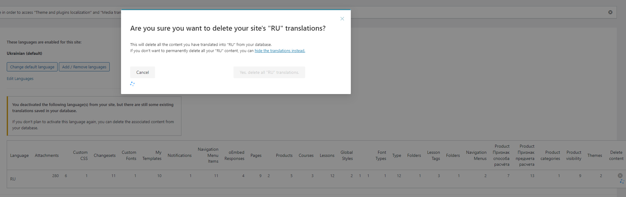

January 23, 2024 at 3:38 am #15214009
Bobby
WPML Supporter since 04/2015
For WPML to work as expected, it is required that there are 2 languages activated at all times. This means you need your site's default language and at minimum 1 more secondary language, please ensure that is the case before deleting RU.
Once that is done, try to delete RU and let us know your results.
January 25, 2024 at 10:10 am #15225357
aleksandrL-4
I've tried to turn on third language and remothe the second one (I do not need anymore). But the result is the same - infinity process without finish.
All I need is having just 1 language on this website and remove WPML from it without crashing. Could you help with that?
If I try to delete pages, products, and other assets manually, it leads to errors on live pages

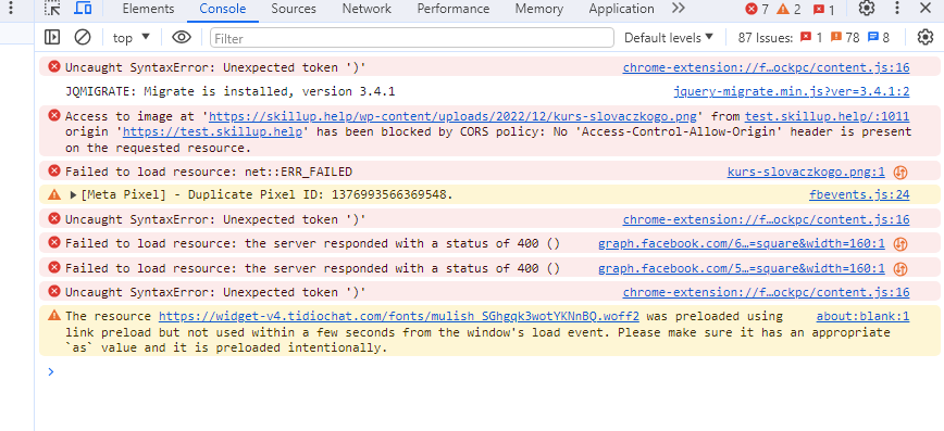

Thank you for the updates. Please check the browser console and make sure it is showing any JavaScript error related to WPML or not.
Also, please share with us the WordPress debug.log(not WPML debug information) to collect more details on this. Refer to these pages for instructions
https://wpml.org/documentation/support/debugging-wpml/

January 26, 2024 at 11:29 am #15229801
aleksandrL-4
Thank you Bigul,
Here is the link and the scrinshot of tmy console
https://pastebin.com/0g36H6s7
January 26, 2024 at 1:45 pm #15230430
Bigul
WPML Supporter since 01/2013
Thank you for the updates. The Debug log is showing the following notice related to WPML. But it will be causing this bug.
PHP Deprecated:  Using ${var} in strings is deprecated, use {$var} instead in /****/test/wp-content/plugins/sitepress-multilingual-cms/classes/API/REST/class-wpml-ate-proxy.php on line 128
Just to make sure, you want to delete the secondary language completely, after that only the default language contents will exist on the site, am I correct?
If so, please try the WPML reset after a full site backup{mandatory} and make sure you are getting the expected results or not. Once we reset it will not be possible to restore the data.
Please refer to this article for more details - https://wpml.org/documentation/getting-started-guide/language-setup/deleting-languages-and-plugin-data-by-doing-a-wpml-reset-on-your-site/#step-3-do-the-wpml-reset

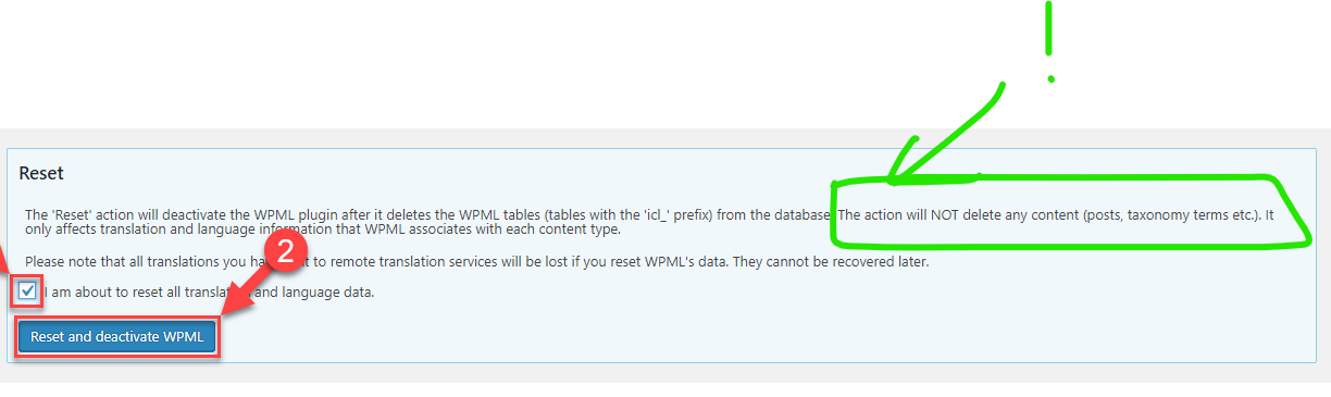

January 27, 2024 at 9:49 am #15232314
aleksandrL-4
Thank you so much for your help! The main problem was solved, anyway.
Regarding manually deletion: all translated files, posts and pages were saved after WPML reset, so I still need to remove it manually. The same warnings is in the note about WPML reset.
January 27, 2024 at 6:10 pm #15233189
Bigul
Thank you for the feedback. That means WPML will not delete the original posts, taxonomy terms and media files when we reset. It will only clear the WPML configuration and translated contents. So we don't have to worry about.
Also, WPML will only keep the data in database and it will be cleared when we reset. Please verify.
Thanks!
