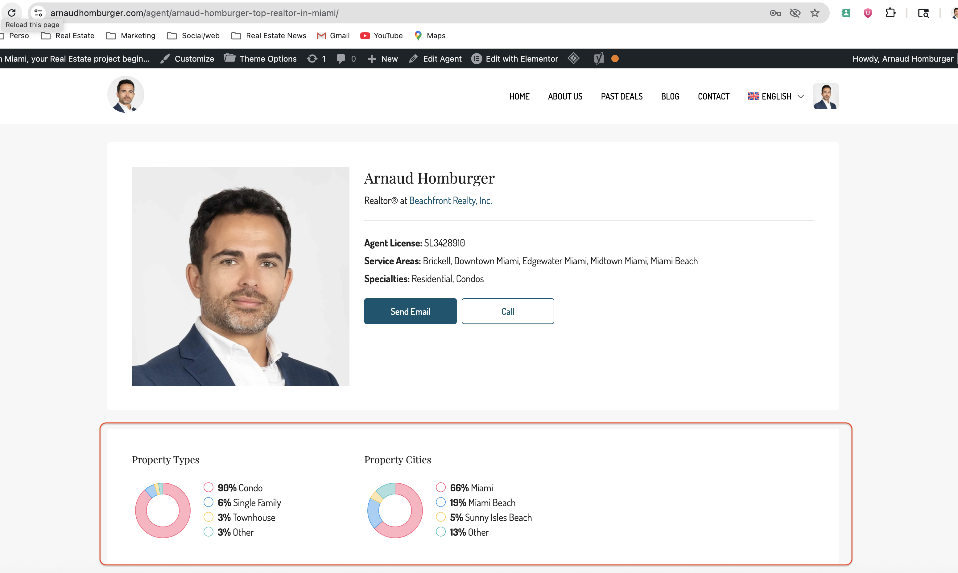

In addition, I noticed a recurring problem: although the agent "Arnaud Homburger" is not assigned to French properties, the 78 properties that appear on the English "About Us" page are now also showing on the French "À propos" page. This issue has been inconsistent – they appear, disappear, and reappear again.
Also, the charts are currently not displaying on the French "À propos" page. Please refer to the attached screenshot. I believe this is a repeat of a past issue that was never fully resolved at the root, which is likely why it’s happening again.

2- For the graphs that are not showing, I tried duplicating the english agent to test this further, but that part is not showing in english either : hidden link
I'm finding a hard time to find where this chart is configured, where do you usually edit this part? Or is it added automatically in function of the property the agent has?
How could I add it for exemple to the duplicate agent that I created.

2. I remember having a similar conversation with you a few month ago about these charts. It is added automatically in function of the property the agent has. The theme came out with these graphs. I can see them on the english page "About us" but ont on the french page "A propos".

This is yet another compatibility issue caused by the recent update done by houzez,
You could share my findings with Waqas if you'd like (to get a faster reply) or I could add it to our compatibility track
Long story short, in wp-content\themes\houzez\template-parts\realtors\agent\single-agent-v1.php , the tempalte you are using to list your options (Stats, reviews,listings...), in line 70 :
if( houzez_option('agent_stats', 0) != 0 ) {
 $agent_listing_ids = Houzez_Query::get_agent_properties_ids_by_agent_id(get_the_ID());
On translated pages, get_the_ID() gives the translated agent post ID, but Houzez_Query::get_agent_properties_ids_by_agent_id() likely only retrieves listings associated with the original/default language agent ID.
The translated ID no longer have associated posts to add in the stats.
That is why changing that line to :
$default_lang_agent_id = apply_filters( 'wpml_object_id', get_the_ID(), 'houzez_agent', false, wpml_get_default_language() );
$agent_listing_ids = Houzez_Query::get_agent_properties_ids_by_agent_id($default_lang_agent_id);}
Helped load the data (but this is not a recommended solution as it is for testing only),

So as usual, the stats issue got escalated and we need to debug it further, soon I will get a temporary fix,
Then we contact Houzez to apply a permanent fix.

The reported issues are now resolved, could you please double check?
Stats are now working, and from now on, French properties will have the agent field greyed out in the backend (translated in the background using the new updates Waqas implemented)
