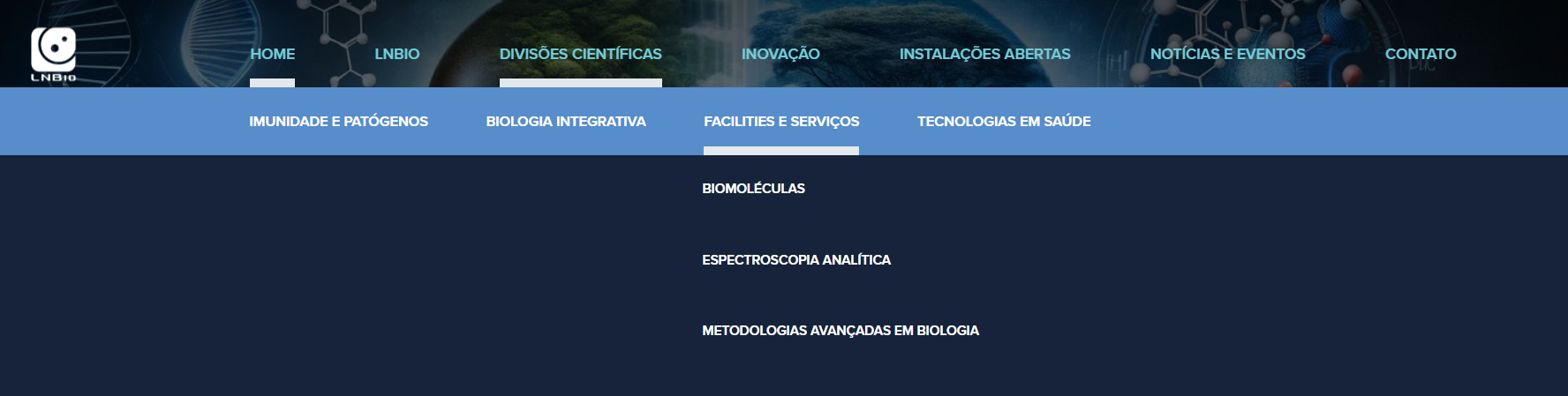

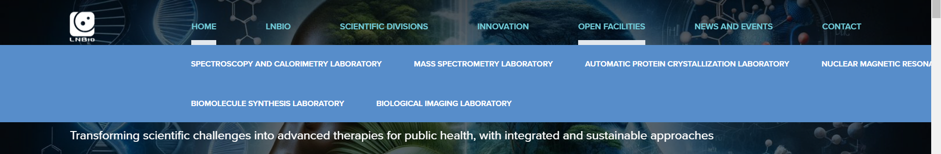

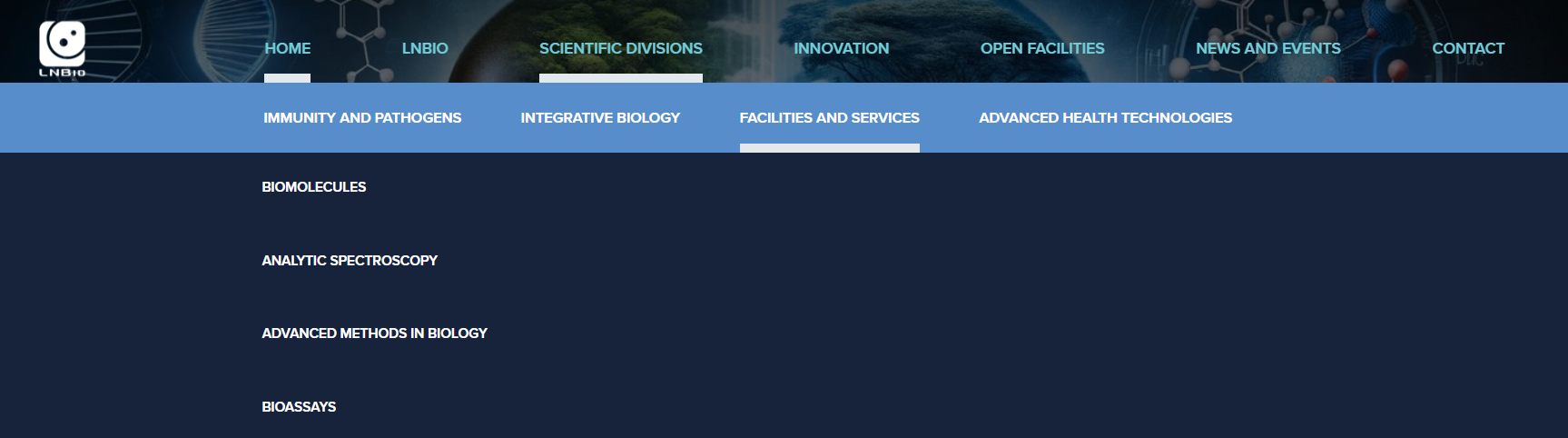

August 27, 2024 at 7:10 pm #16111935
alexandreR-4
Hello Mateus, thank you for your assistance.
I'm unable to replicate both the issues: the page reverting to the original language, or the disappearing menu. But I'm now facing a different problem (as shown in the screenshots attached to this message).
It's subtle but annoying. Note that in Portuguese, the menus are correctly showing below the corresponding item (1), while in the English version (2, 3), they are all misaligned.
Any clues?
Best
Erik
